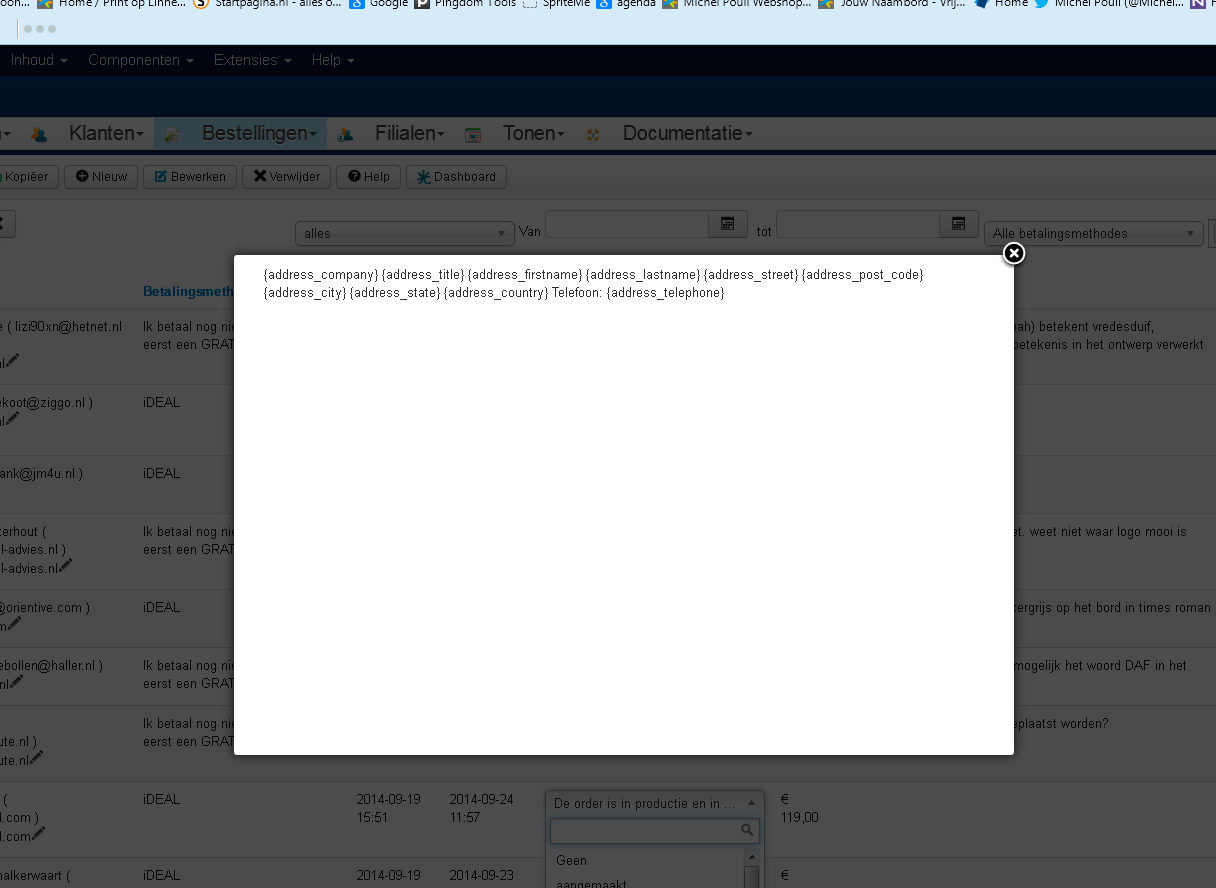

I updated hikashop (2.3.3) and joomla (3.3.4) and now when I try to change te orderstatus of an order I get an error (see screenshot). I can't change the status.

11 years 11 months ago #172844
Please check your PHP error log.
I think you edited the "address_template" view for your backend template and there is a PHP error into.
HikaShop 2.3.3 is just HikaShop 2.3.2 with a security patch.
There is nothing more in this release.
Nevermind, I reproduced your problem after an update to Joomla 3.3.4

11 years 11 months ago #172848
I only a changed it in the frontend template, but that was 3 years ago. There are no changes in the backend template. Everything worked fine untill this latest 2 updates. Can it been caused by the security-update of joomla?
11 years 11 months ago #172850
It's a "new feature" added in Joomla 3.3.4 :)

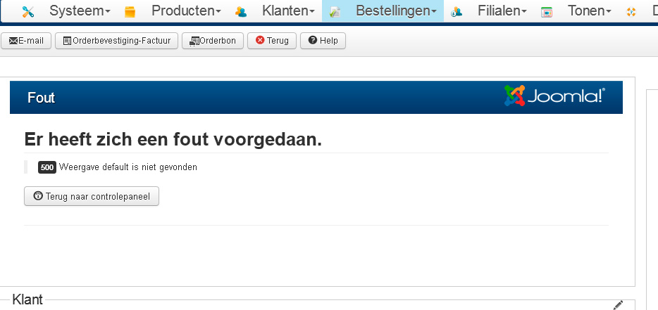

11 years 11 months ago #172864
Oops,
Still an error when changing the orderstatus in the order itself (see screenshot)

11 years 11 months ago #172879
I definitively love the Joomla minor security release where there is a lot of modifications without a "Bug & Fun" session before...
Please edit the file "administrator/component/com_hikashop/helpers/helper.php" and replace
