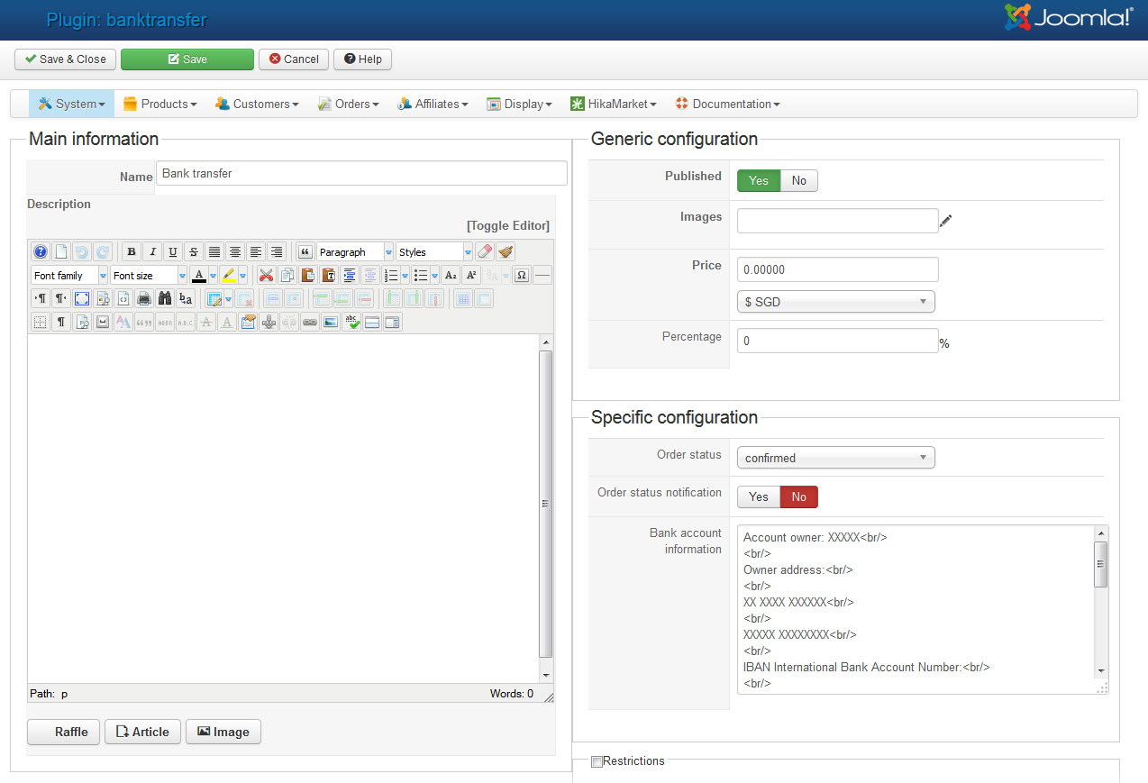

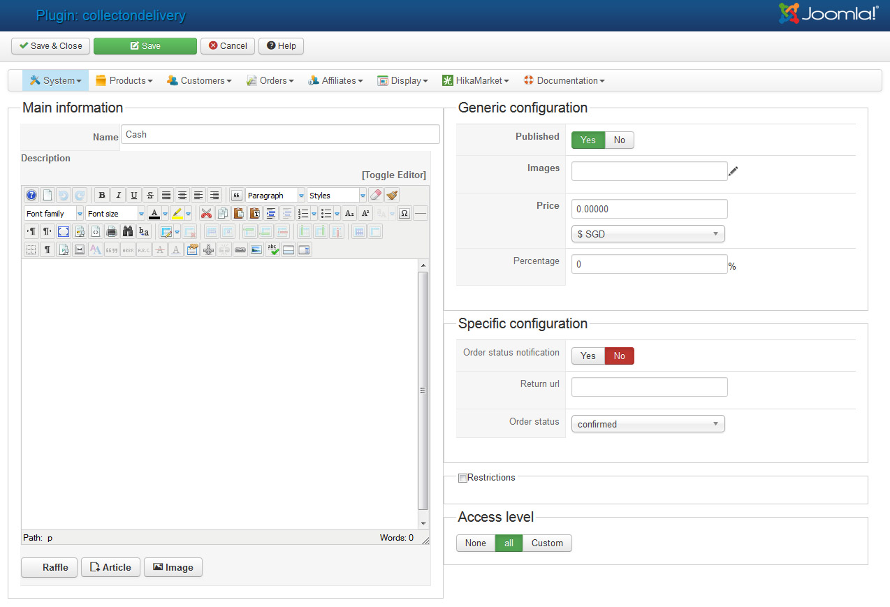

  • Posts: 30
11 years 8 months ago #176303
I've attached 2 pics.
One of the Bank Transfer - works fine
The other is the Cash payment - does not add points after order is completed.
  • Posts: 26357
  • Thank you received: 4068
11 years 8 months ago #176345
Can you please update HikaShop with the latest release we made (2.3.4) ?
This release contains some modifications and I think that one modification for the plugin collectondelivery (for a standardization of the plugins) could help you.
