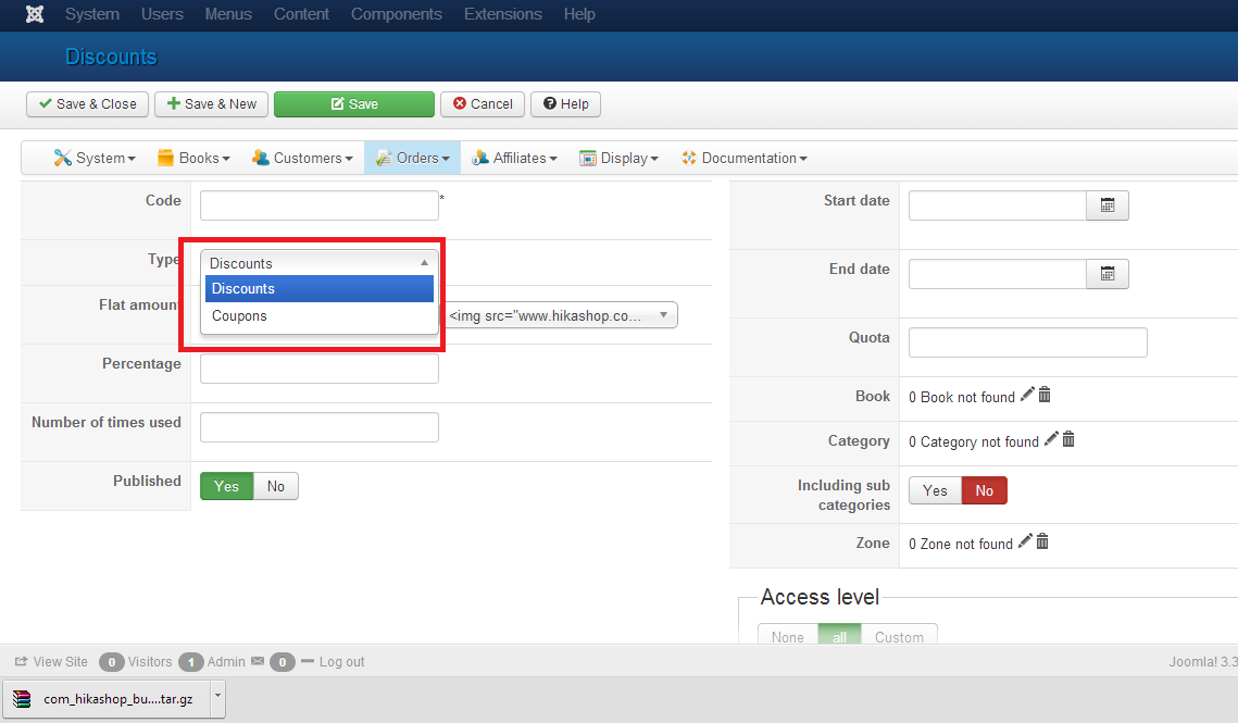

I am using business edition of hikashop. In the hikashop configuration -> Order->Discounts there are only two options when I create new i.e. 1) Discount & 2) Coupons
Please refer the attached screenshot. I want to add new options after the 'Coupons' and customize the fields according to new type.
Due to some customization requirements I need to add another few options after the coupon. How to do that? If I am to edit some php file, please also guide where to find it and what section to edit as I am not a programmer.
Thanks in Advance

To add an option here it require to edit core files, so changes are lost when updating unless you do class overrides.
The file to edit is "administrator/components/com_hikashop/types/discount.php", in that file you can add the entry as a new 'select.option', then you will have to edit/add javascript to change the displayed fields.
To add fields, the view to edit is "discount / form" in backend template.
Could you give us more details about what you want to add ? Because it will require a lot of other modifications if you want a new discount type...
In your case the best solution will maybe to use a plugin based on custom fields or on a specific action.
Here is documentation about plugins:
hikashop.com/support/support/documentati...r-documentation.html
In all cases, it require good PHP knowledges.
