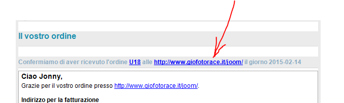

Buongiorno is a mistake in the order confirmation email, which should bring the time when the order was placed back on the site, as can change this value?

The problem is that there should be them the time and not the site link

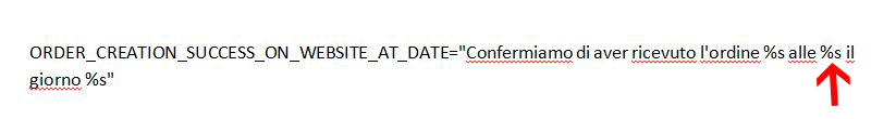

These are the translations in Italian and English of the problem, the variable is not a link to the site but a time, for example at 18.45 not www.pro .....
Italian: ORDER_CREATION_SUCCESS_ON_WEBSITE_AT_DATE="Confermiamo di aver ricevuto l'ordine %s alle %s il giorno %s"
English: ORDER_CREATION_SUCCESS_ON_WEBSITE_AT_DATE="We are pleased to confirm the creation of your order No. %s at %s on the %s at %s"
How do I change that variable?

Just modify that text with a translation override so that it displays what you want:
And if you want to change the order of the variables in the translation, it's possible too.
So for example the translation:
in the same as:
ORDER_CREATION_SUCCESS_ON_WEBSITE_AT_DATE="We are pleased to confirm the creation of your order No. %1$s at %2$s on the %3$s at %4$s"
and you can change the order of the variables like this:
ORDER_CREATION_SUCCESS_ON_WEBSITE_AT_DATE="We are pleased to confirm the creation of your order No. %1$s at %2$s at %4$s on the %3$s"
