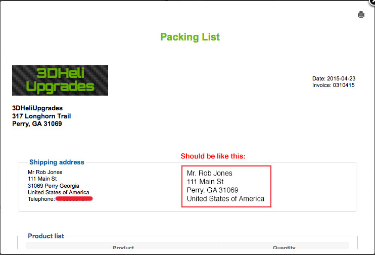

Now that I have the shop online and have been taking orders, I have discovered a small but annoying problem I would like to resolve. The customer's shipping address is being improperly formatted in the HS back end, and when I print packing lists. I have attached a sample screen shot of what I mean. But basically, the elements are out of order and need to be rearranged.
This isn't a major problem for domestic US orders as I can usually figure out how it should be arranged. But I can see it being a real problem for international shipments. In fact, I have an order right now going to Australia and I had to email the customer to ask him the proper shipping address because I couldn't figure it out.
How can I correct this?

You have to edit the address_template view.
See: www.hikashop.com/support/documentation/i...view-form.html#infos
Depending where you display the invoice ; you will have to make an override for your front-end template and also for your back-end template.
