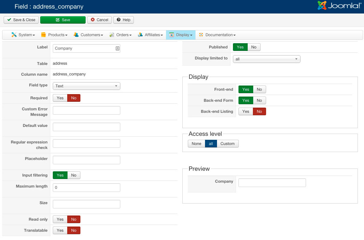

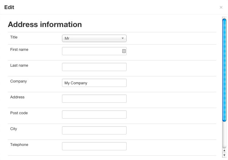

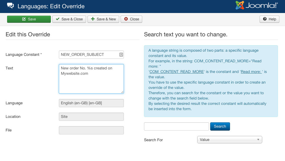

11 years 3 weeks ago #218100 by wildweststudios
thanks for responding. I did try this and unfortunately it also didn't work.
So just to be clear on what I did - this is what I have now in Order.php
Code:
$order->mail->subject = trim($order->mail->subject); if(empty($order->mail->subject)) { $address_company = $order->cart->billing_address->address_company; $order->mail->subject = JText::sprintf('NEW_ORDER_SUBJECT',$address_company,$order->order_number,HIKASHOP_LIVE); }
Is it possible the problem is somewhere else? I've attached screenshots of what I have in my "address_company" custom field, then that field filled in the User Address Information screen, and then my "NEW_ORDER_SUBJECT" language override. Hopefully this sheds some light on the issue. Thanks!
11 years 3 weeks ago #218144 by nicolas
That's not what I said to do in my last message. I said the replace the whole block with the 2 lines. Try like that.
