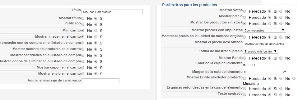

I have a problem in Cart no products to remove the button appears to me, but the funny thing is that I have activated setting Show icons to remove in the list of purchases and the car does not leave me.

The display of the cart module has been customized on your website.
Apparently it comes from your template.
If you rename the file templates/YOUR_TEMPLATE/html/com_hikashop/product/cart.php via FTP, that will remove the customization and you should see the delete button.
Alternatively, you can contact your template provider so that they can properly support the settings of the cart module in their customization.

With regard to rename the file, you mean the Cart.php?
Or should I change something in the code.
Thanks so much!!!!
  • Posts: 86080
  • Thank you received: 14186
10 years 9 months ago #220375
Yes, I'm talking about that file.
The following user(s) said Thank You: rober1903

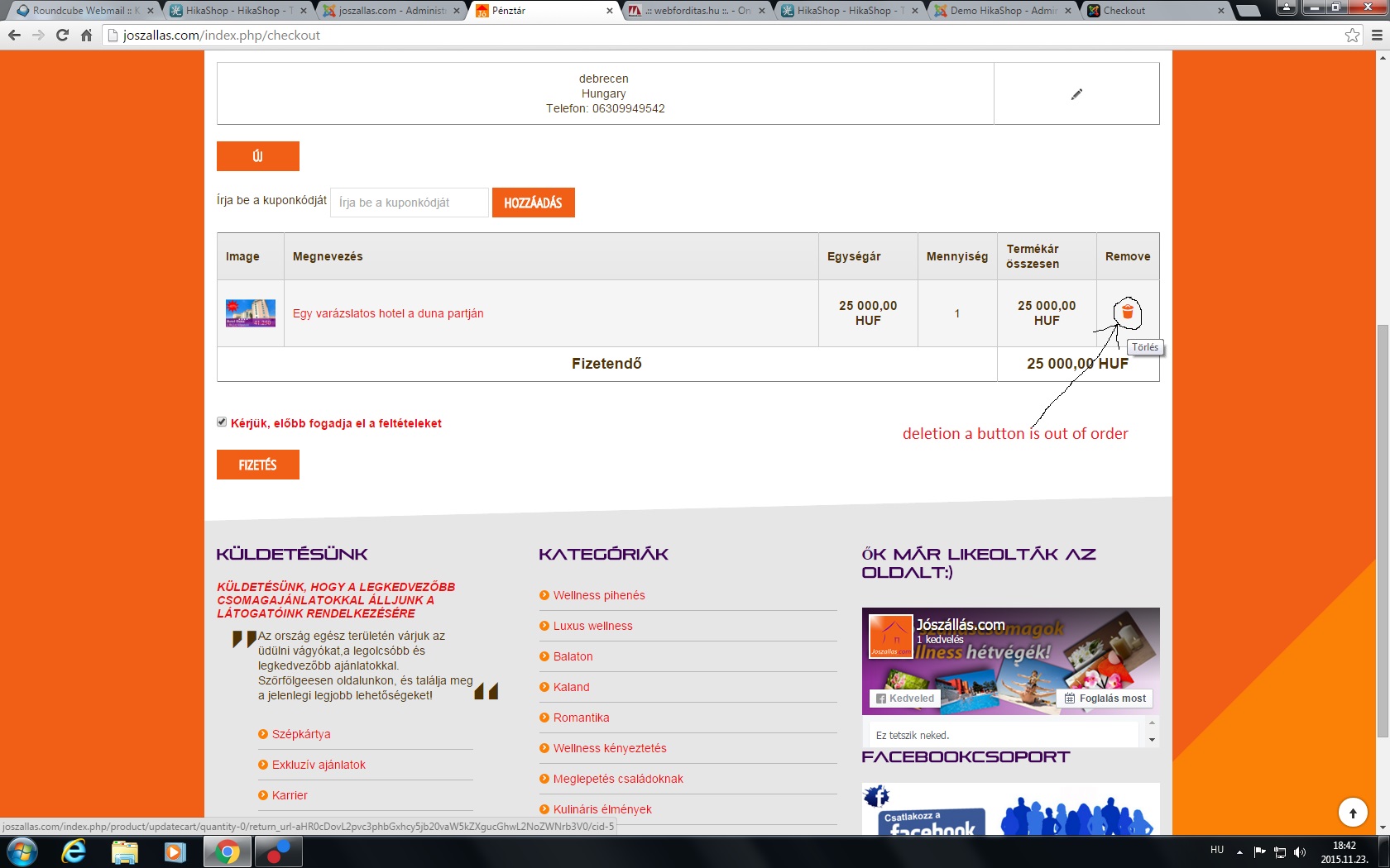

Please help me! The deletion an icon is out of order.
Thank you!

It seems that you're using the "cart status" view instead of the "cart" view.
In that case, the modification of the cart content is not possible.
Put back the cart view instead the cat status view in your HikaShop checkout workflow and that should then work.
