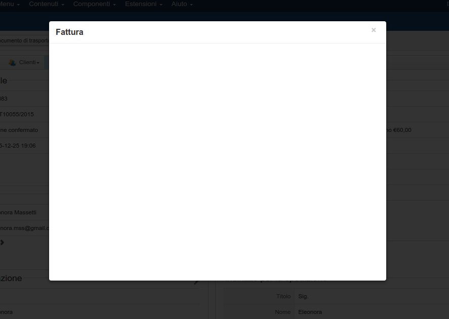

Hallo.
I upgraded to joomla 3.4.8. In my order i cannot print invoice or shipping doc because the popup is blank. This already happend some upgrades before and you comunicated the solution but with different version.
Could you please give advice.

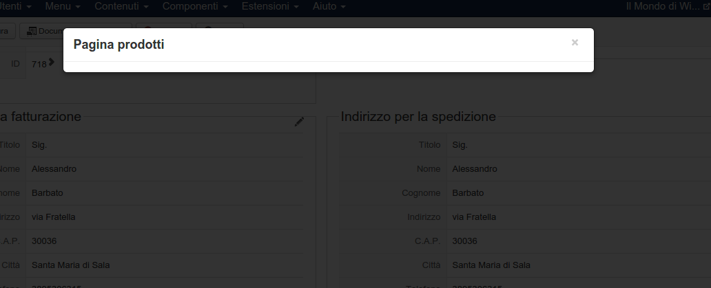

Add: All popups are blank or cutted
