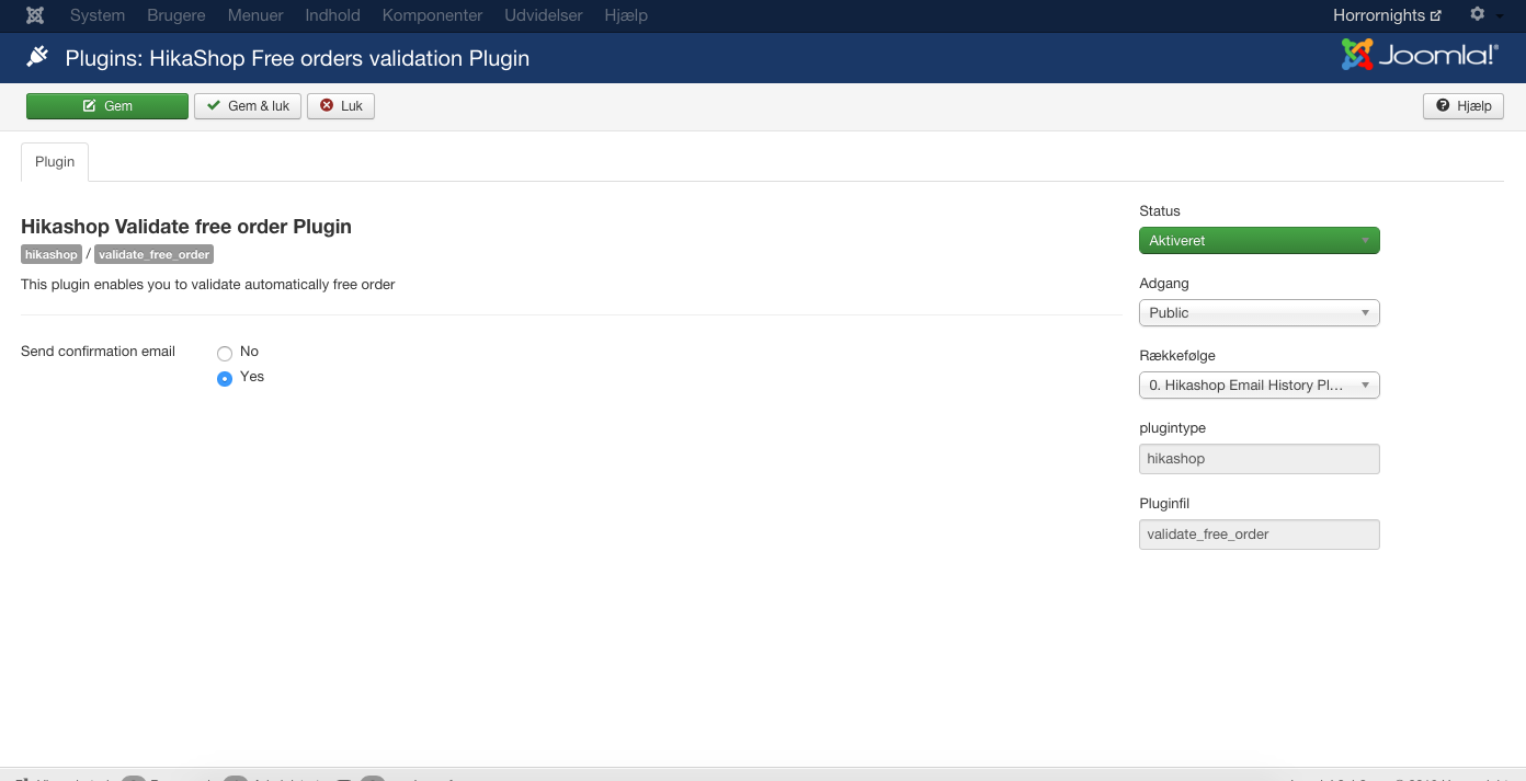

Did you see anywhere in our message something which indicate that you need to modify a plugin ?
Why are you complicating the situation when we are just telling you to use one HikaShop plugin ?
You activate the plugin (like it seems to be done in your screenshot) and that's it !
Your free orders will be automatically confirmed instead of just being "created".

I enabled the plugin before I made this topic. I am sorry if I wasn't clear about that.

However, if you already enabled/published the plugin and your free orders aren't automatically validated there is a problem, so can you show me some screenshots of your configuration and of the result you have with free orders ?

The problem is not that the orders are automatically validated. Because there are automatically validated and registered as confirmed orders. But the problem is that I want the order to be listed as confirmed and payed.
Is this possible?
Because normally, an order will be listed as confirmed. And after the payment have been made, will be listed as: confirmed - payed.
And then I have to look all at all the "confirmed" orders to see if the payment have been cancelled, or not in the orders list.
10 years 7 months ago #228419
Order can only have one status, and it's the status that you have set through the "Payment confirmed order status" option via "Hikashop->System->Configuration->Main".
In your case the the solution can be to create a custom status "Confirmed - Payed" and set it on the "Payment confirmed order status" option, OR directly edit the code of the files of the "validate free orders" plugin.
