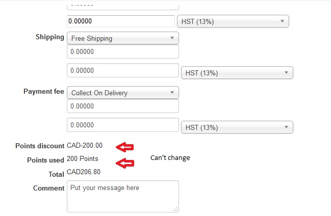

-- Joomla version -- : 3.4.8
-- PHP version -- : 5.5.50
I would like to change the point discount and point used in the edit order page, but i can't a way to edit (see attached). There is a not of situation where you may need to change the point discount for the customer.

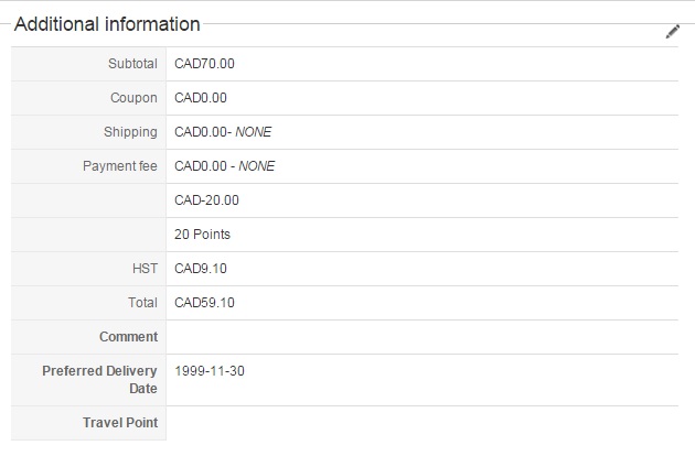

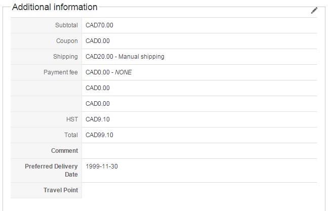

  • Posts: 42
10 years 5 months ago #232555

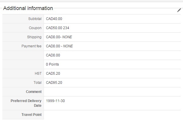

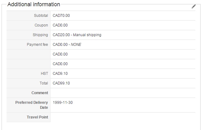

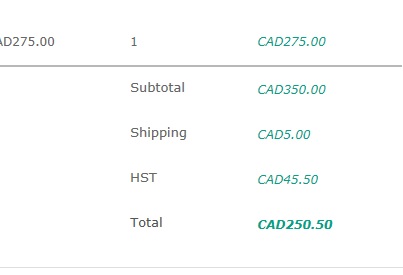

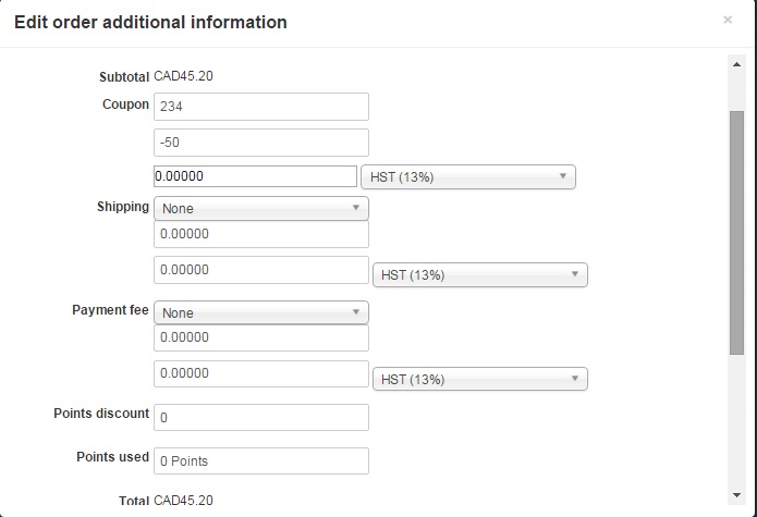

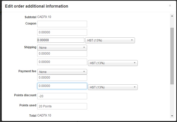

Please see the attachments for explanation.
attachment 1-3, you can see the points are gone after i have updated the product quality.
attachment 4-5, you can see that the coupon amount is added rather than subtraction.
Please let me know the problems.
Gary

2. You're getting it backward. The coupon amount is subsctracted. The problem is that you set a negative value for your coupon.
So 100 - - 50 = 150 and not 50. You need to add a positive value in your coupon if you want to reduce the total amount since the coupon value is substracted.
