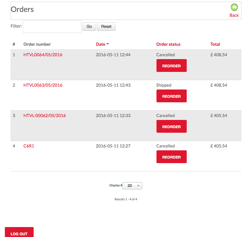

HI,
I'm wondering if it's possible to hide orders with a status of Cancelled on the frontend in the My Account > Orders section?
I think it looks messy to show them there esp. when they are created as part of a failed payment process like hitting cancel & return in Paypal.
Aran
