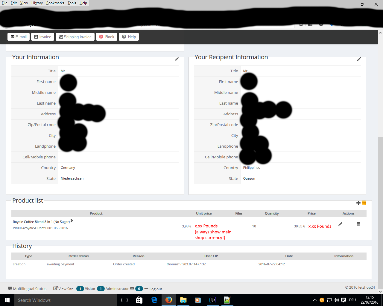

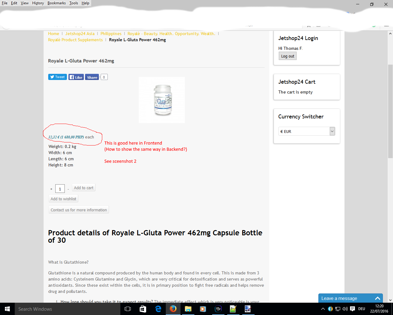

as seen in the screen shots, the front end shows the original and shop main currency well and correct.
Yet when going to the back-end, in the orders and the product listing it just shows the buyers selected currency, and nut both, hence selected and main shop currency as in the front end.
Please help me to display the main shop currency, in my case its Pounds always next to the selected currency.
Thanks for the setting or code in a specific php file. (I am not a programmer)
Thomas
