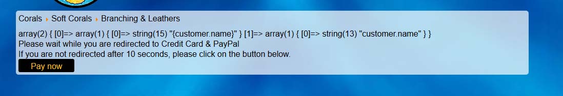

It is working if the customer is registered. It is not if the customer checks out as guest. Also appears to be only using the First Name, Full name if possible, would be much more useful.
Also upon clicking "Finish" there is coding that comes up in the pop up window. Please see attached.
Thank you for all your attention to this.
