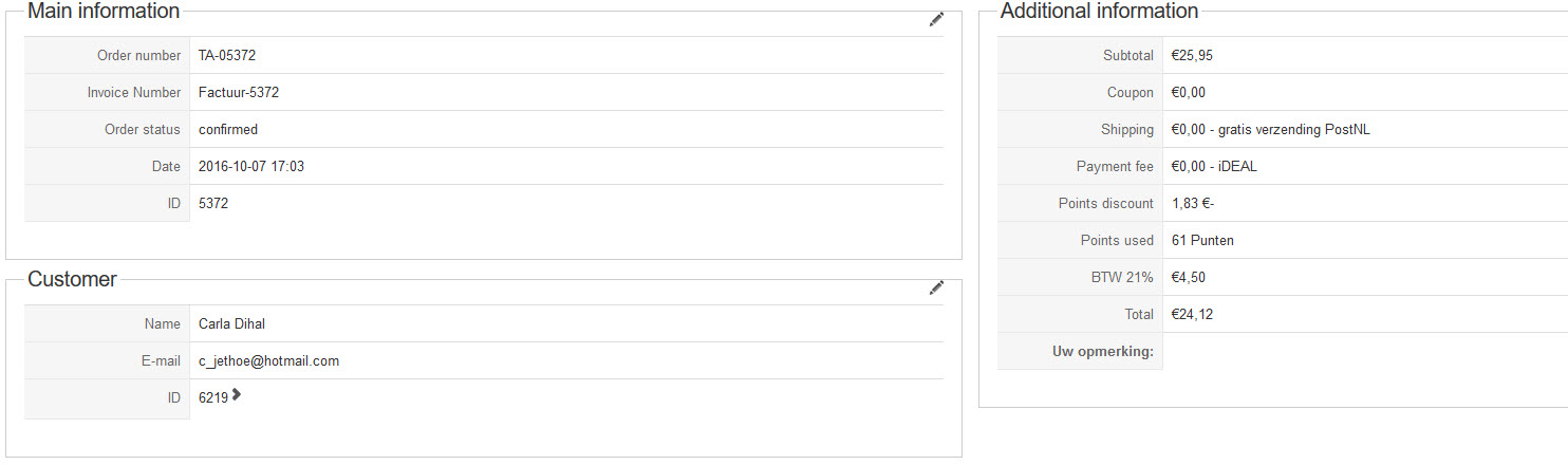

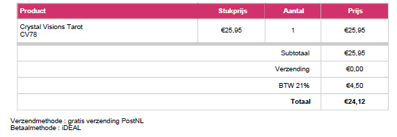

-- Joomla version -- : 3.6
I use the Attachinvoice PDF Plugin and Hikashop Userpoints.
When someone pay with userpoints you see this in the backend invoice.
The userpoints don't appear on the PDF invoice.

I checked it and the code is indeed in the invoice.php
hereby the screenshots
Attachment not found

I'm not able to reproduce the problem. Do you have it displaying properly if you deactivate the PDF plugin ?
Also, It seems that you customized the invoice.php
Did you make an override of the file ? In that case, you would need to look for the code of my previous message in the override invoice.php file and not the default one.
If that doesn't help either, then we'll have to have a FTP and backend access in order to look deeper into it.
