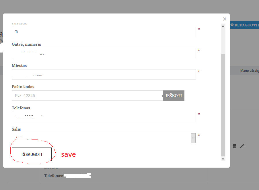

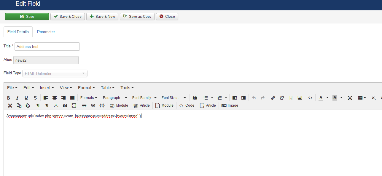

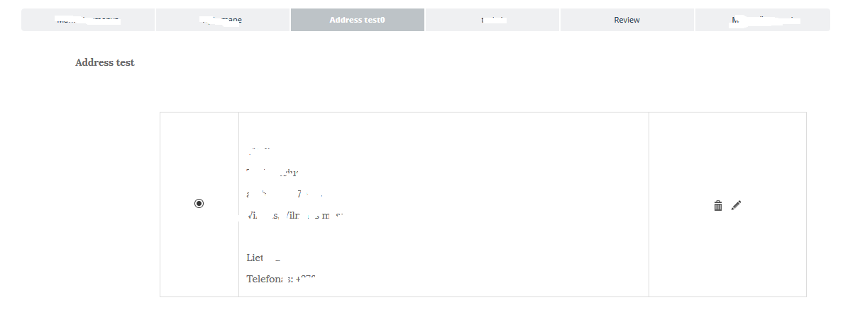

  • Posts: 1119
  • Thank you received: 114
9 years 8 months ago #257603
1. Awesome. Thanks
2. To have address addition tab I did this. I have installed such plugin: extensions.joomla.org/extension/include-component
In easy-profile I have created new group and named it address test0, then I have created user field named address test, type html delimeter and assigned it to that group. Added such tag inside that user field {component url='index.php?option=com_hikashop&view=address&layout=listing' }
Now it shows address edition page inside tab. All should work I think but then you press edit address, pop-up is displayed and then save it redirects to home page and shows address edition between all modules. Same as there would be no menu item for it...And url is like this: /component/hikashop/address

  • Posts: 86079
  • Thank you received: 14186
9 years 8 months ago #257612
You would have to change the line:
echo '<html><head><script type="text/javascript">window.parent.location.href=\''.$url.'\';</script></head><body></body></html>';
to:
echo '<html><head><script type="text/javascript">window.parent.location.href=\'XXX\';</script></head><body></body></html>';
where XXX is the URL of the profile in the file components/com_hikashop/controllers/address.php
