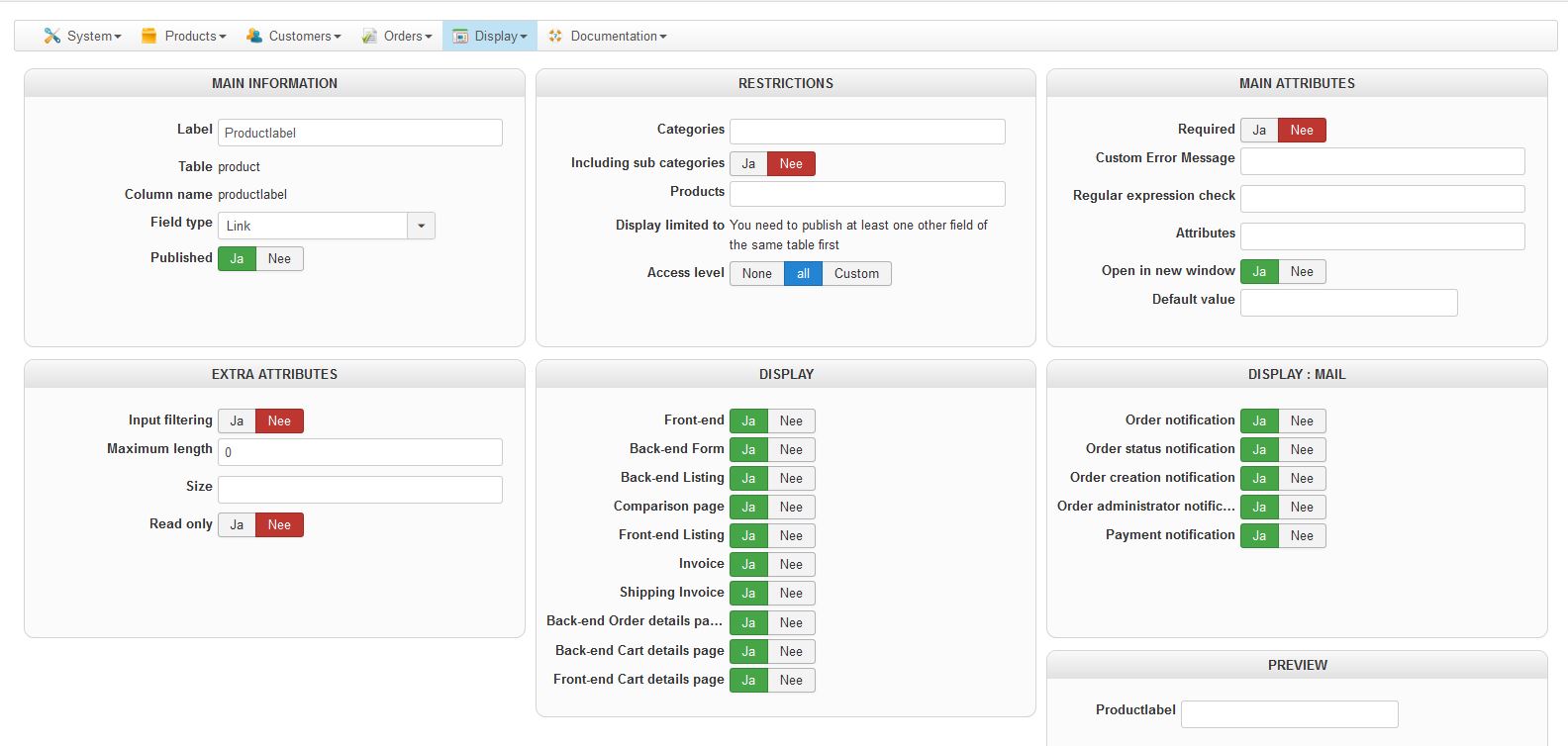

Can you provide a screenshot of the settings of your custom field ?
  • Posts: 6
8 years 11 months ago #273049
Here is the screenshot.
Just to be sure I turned eveything on.
Last edit: 8 years 11 months ago by vectoronline.
