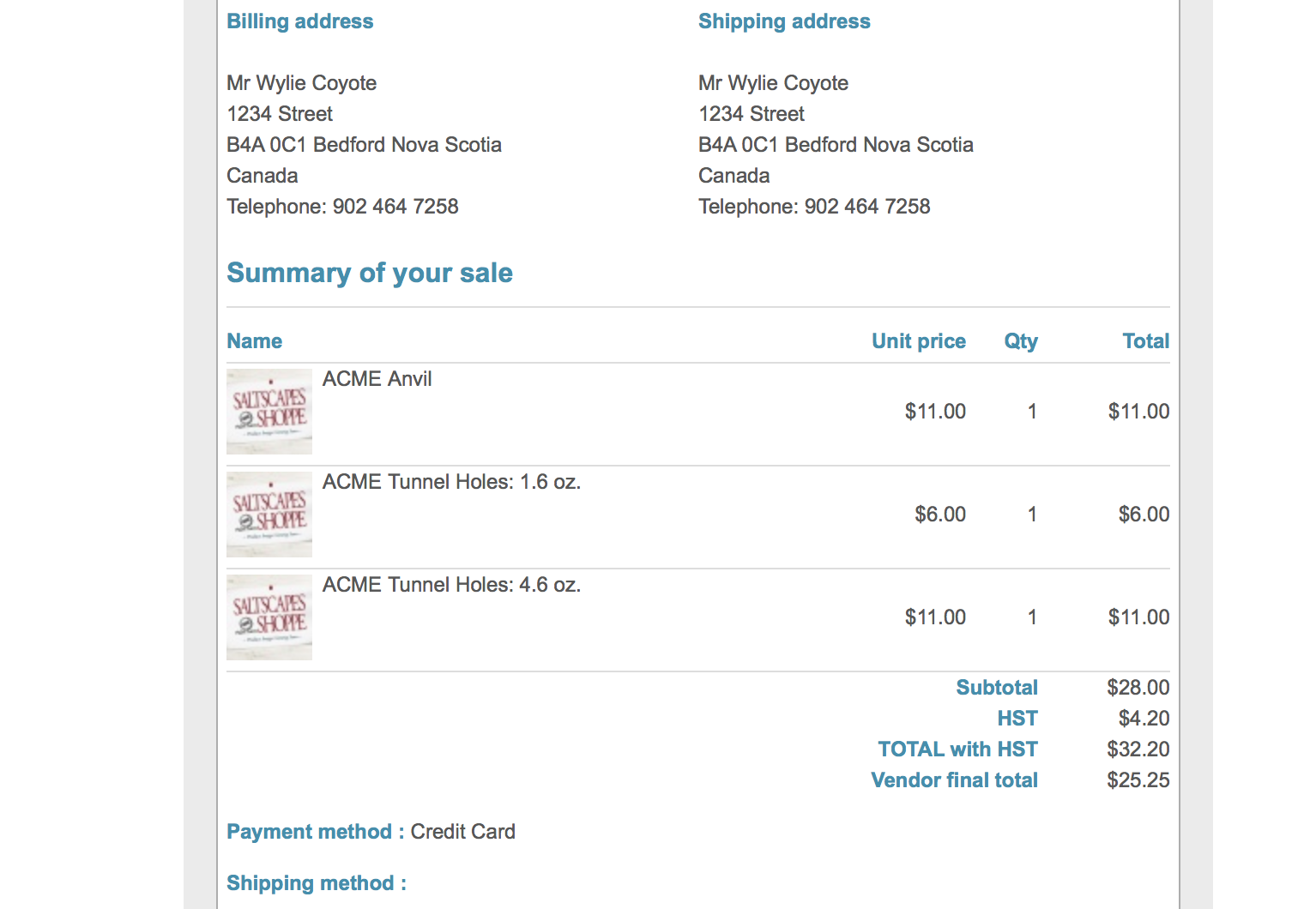

Good evening;
Not a bug, just a general question to confirm. We need to remove the line of text from the order notification that goes to the vendors below the total called Vendor Final Total which shows the amount less commission/fees.
Is this the section that needs to be commented out from Hikashop > System > Emails > Order Notification?
<!--{START:ORDER_FOOTER}-->
	<tr>
		<td colspan="{TXT:FOOTER_COLSPAN}" style="text-align:right;color:#1c8faf !important;font-size:12px;font-weight:bold;">{LINEVAR:NAME}</td>
		<td style="text-align:right">{LINEVAR:VALUE}</td>
	</tr>
<!--{END:ORDER_FOOTER}-->
Thanks,
Scott

If you're talking about the vendor email ; it would be more the "vendor order notification" that you want to customize.
And the process is to edit the "preload" part to remove what you don't want to display in the "cart footer".
