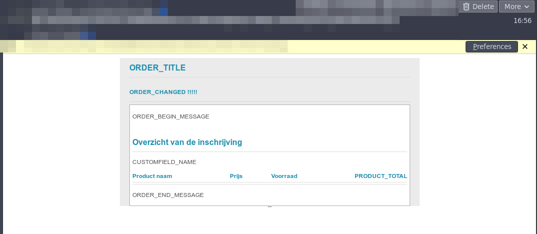

But I managed to get something aout know with the new HB 4.02, but the confoirmation mails is not filled. Looks like this:
I did not change anything, why is this? Again, this system people do not register, only order as guest.

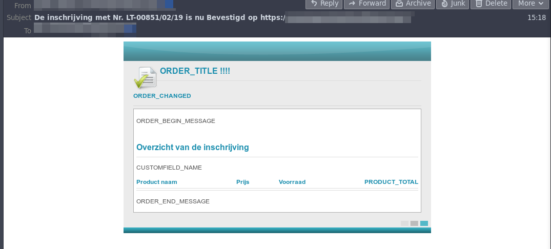

7 years 6 months ago #303820
I thoroughly investigated and use hikashop and other for as long as Joomla excists. I made sure there are no changes and use the original Hikshop design of the mails.
The email is send to customer (payment notification) but the info is not injected in the mail. The mail is empty. I definitly looks like it must be a hikashop issue. Iḿ working weeks now on it and really can't figure it out anymore. I use the 4.0.2 files of HS.
Is it possible I give you superadmin login to have a look yourself to check what the real issue is here?

7 years 6 months ago #303822
As far as I can see, this indicates that the email HTML has been changed incorrectly.
We can have a look yes. Please provide a backend access along with a link to this thread and we can check the emails override.

7 years 6 months ago #303937
I checked the email overrides on your backend and it doesn't seem to come from that.
I was also able to reproduce the issue on your website with the "preview" button of the order status notification email. So There is a really low chance that it would be linked to your payment plugin.
Could you also provide a FTP access via our contact form ( and not disable yet the backend access ) so that we can look into it deeper ?

7 years 6 months ago #304024
Thank you for the access.
I was able to find the issue and fix it. I've also added the patch on our end.
The issue was that the preload of the order status email wouldn't load properly if you had configured different HTML versions per status in the email but not different preload versions per status in the order status notification. And that was precisely what you had done.
The order status notification email is now displaying fine on your website. And for anyone with the issue, you can just download the install package on our website and install it on your website to get the patch.
