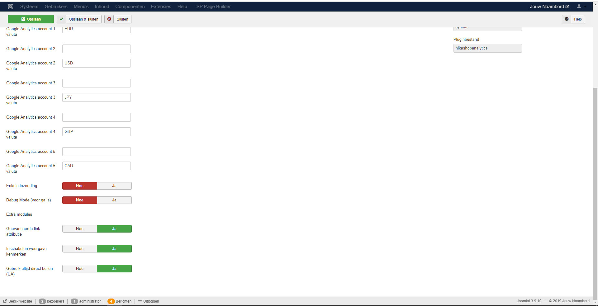

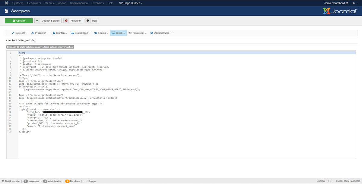

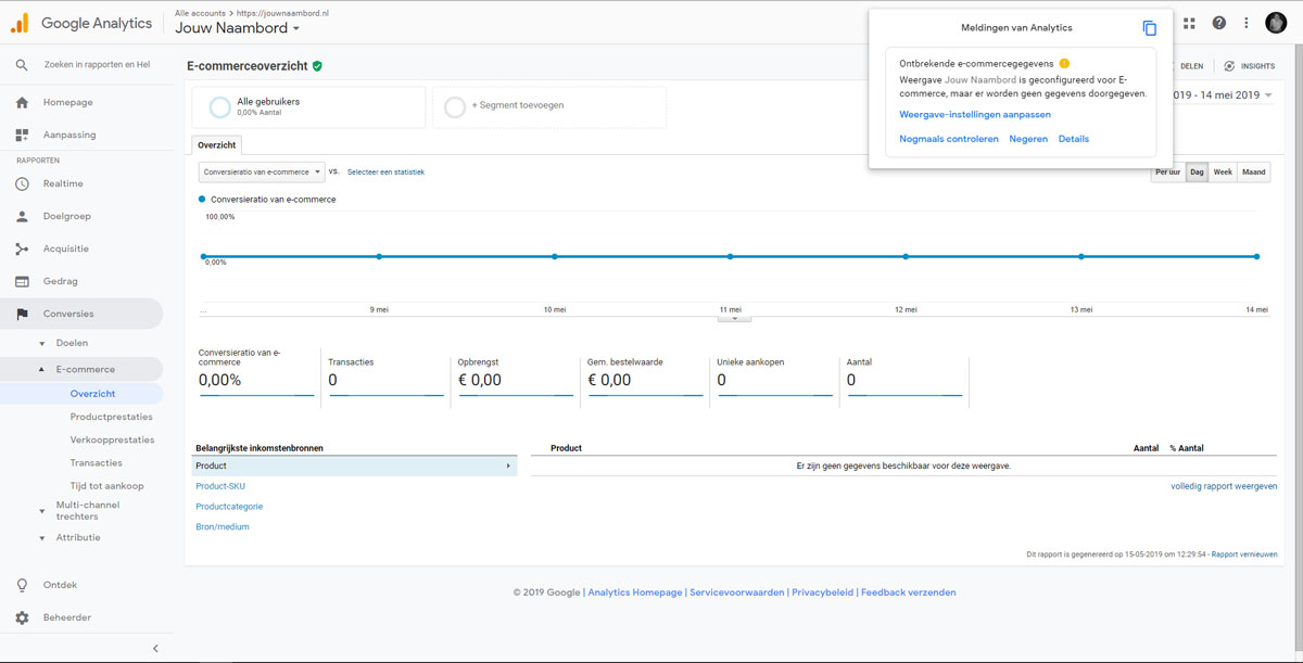

I can't get the e-commerce data working anymore. It has been working in the past, but for quite a while there's no more data transfered to google analytics.
As far as I can see all the parameters and setting are ok, see attached screenshots. The event snippet code is set on after_end.php and end.php.
The basic google analytics plugin is installed. The hikashop analytics plugin is activated and conifigured and still there's no data inserted in analytics.
The targets set in analytics are working fine and do show the orders (as the after_end page is defined as target).
Can't figure out what is wrong? Please advise, thanks.

The snippet of code in your screenshot is not correct. $this->order->product_id and $this->order->product_name do not exist and never did. And even for the other variables, the code is not correct. Instead of $this->order->order_full_price it should actually be <?php echo $this->order->order_full_price; ?>
So I don't think that this snippet of code is doing anything.
What you could do is activate the "Always use direct call (UA)" setting in the GA plugin. This can help in sending the sales data to GA as it then uses cURL to send it (make sure that cURL is activated on your hosting).

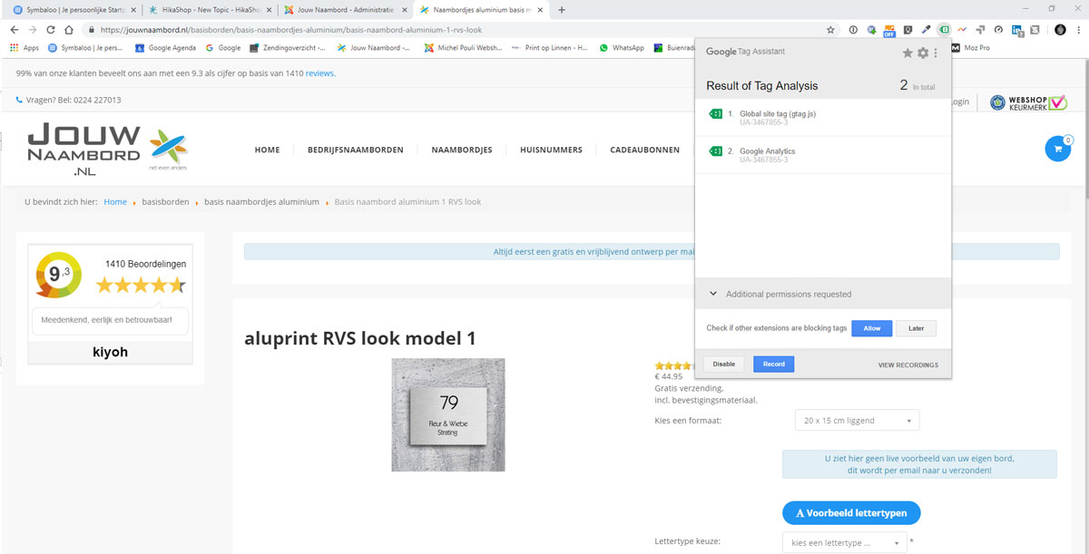

I changed the code, activated the UA setting in the GA plugin and updated to 4.1. Waited for 2 days, but still no data is received in analytics.

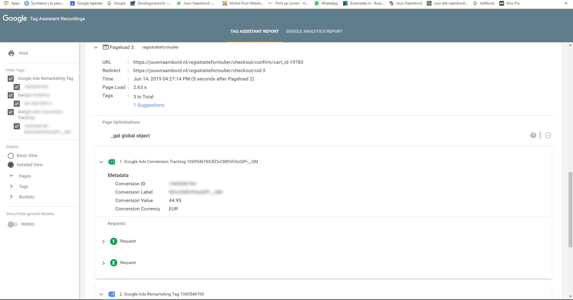

If I use the tag assistant no errors are found it does fetch the google codes and productprice on the after_end/end page, but not the order_id. See screenshot.
Also in Firebug the conversioncode gives a 200 status. Can't figure out what's going wrong...

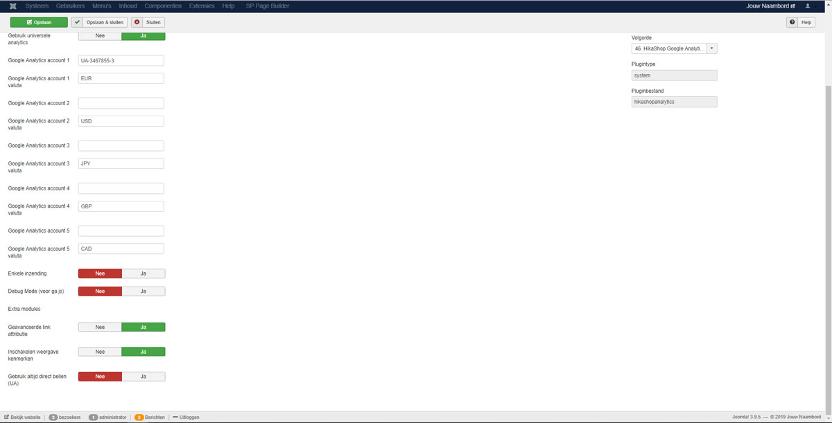

Thanks for your reply. The direct call is actually activated, so this is not the answer to the problem (see screenshot).

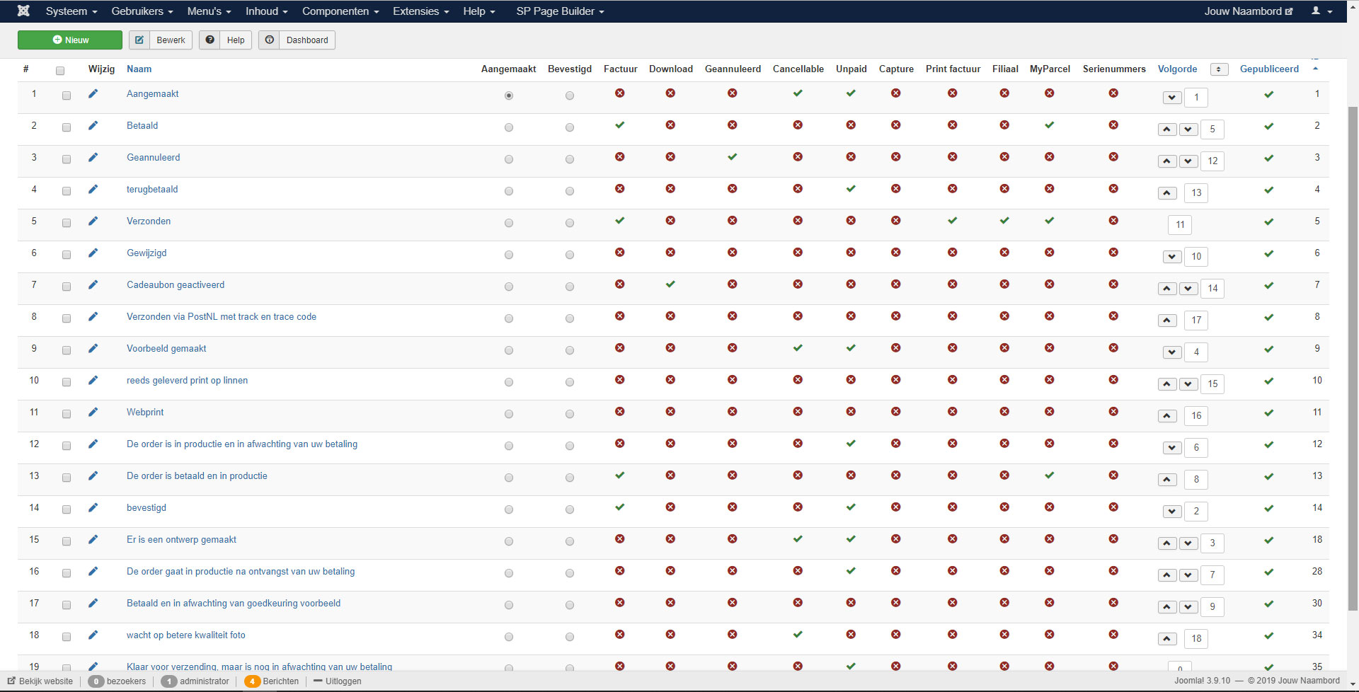

Sure here's the screenshot of the statuses.

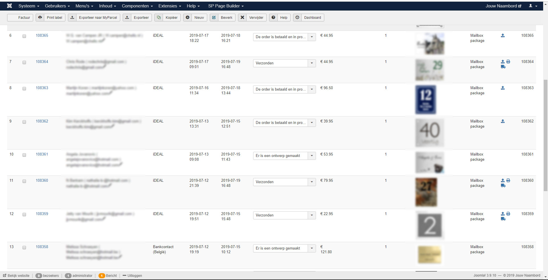

Why do I need testorders? This is a live website, with actual orders that people pay for. So all the possible statuses are available in the backend orderpages. I'm not sure wich information you need? Here's a screensot of some orders with different statuses.

From your screenshot and what Jerome told you, if in your Google Analytics option you had choose to not use the "single submission", it's normal that Google didn't receive anything, let's check together :
See your screenshot with my color borders :
If I look on your test order statuses screenshot, there no command with the "confirmed" statuses in your case, from this 2 solutions :
- You use the "Single submission"
OR
- You change your statuses configuration

Thank you for this explanation. I overlooked the column "confirmed", never changed that setting in years :). I have set this and will try some testorders to see if this is the solution.
