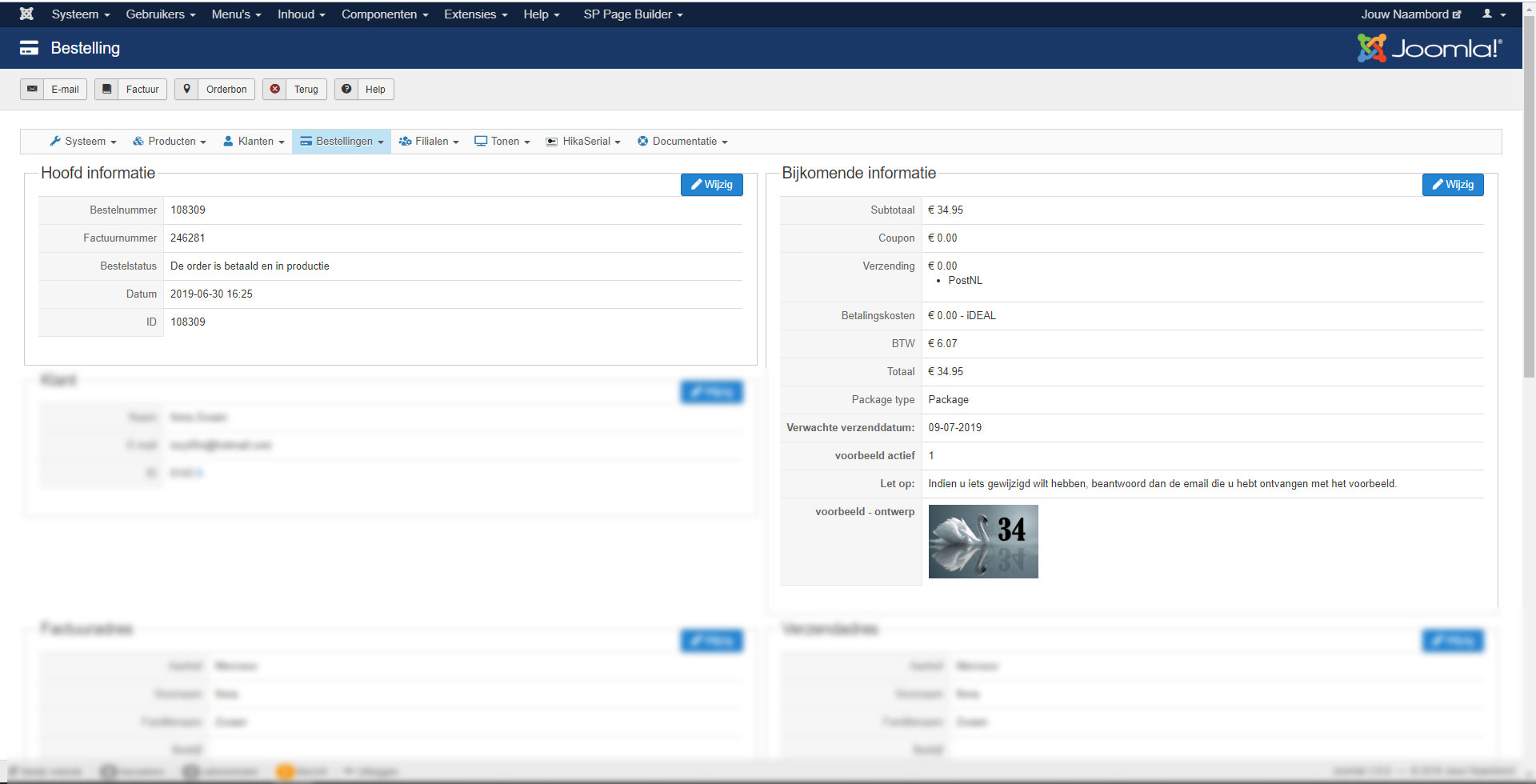

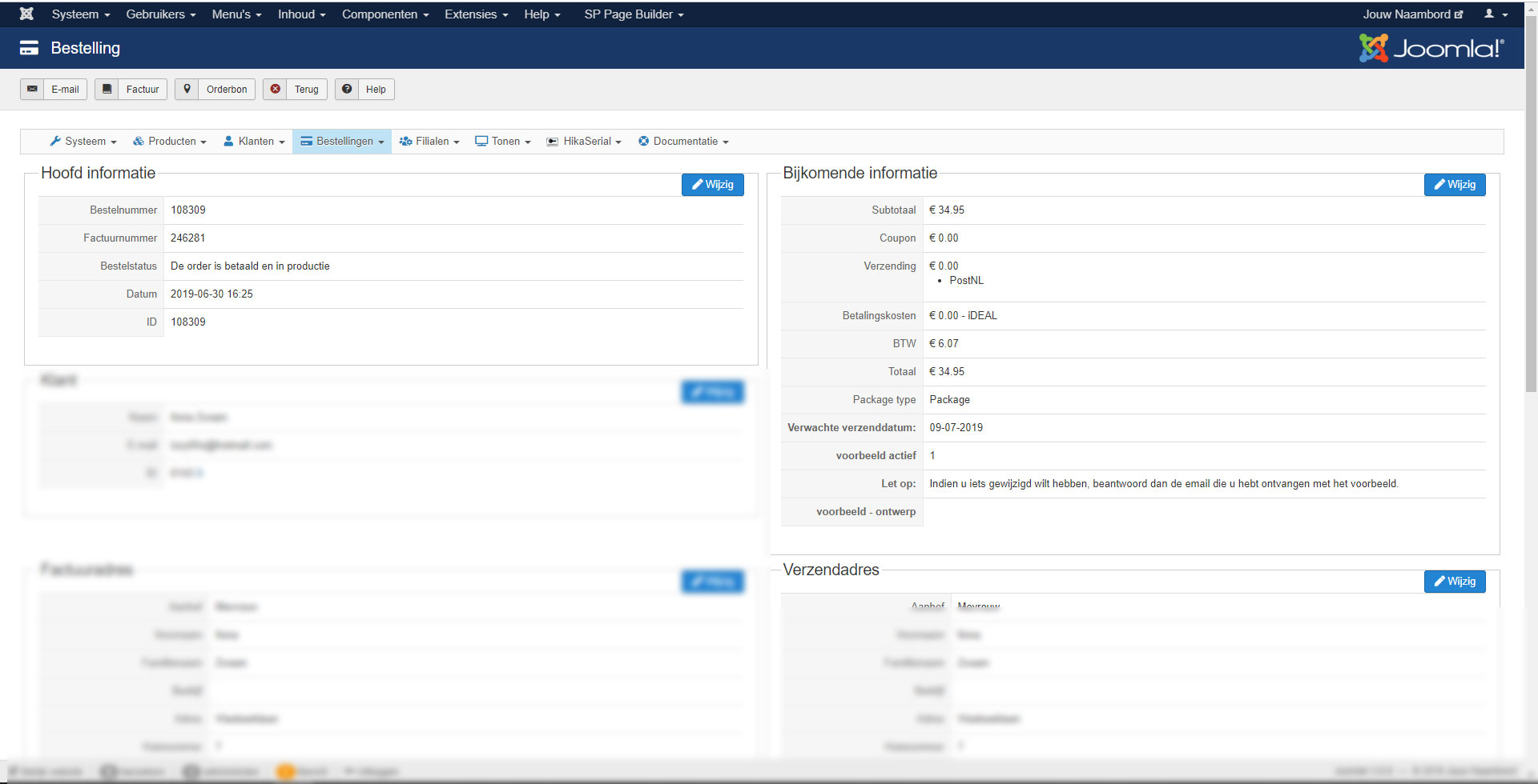

I have a custom image field for a customerdesign in the order list. After editing the order, the image disappears. Looks like a small bug.

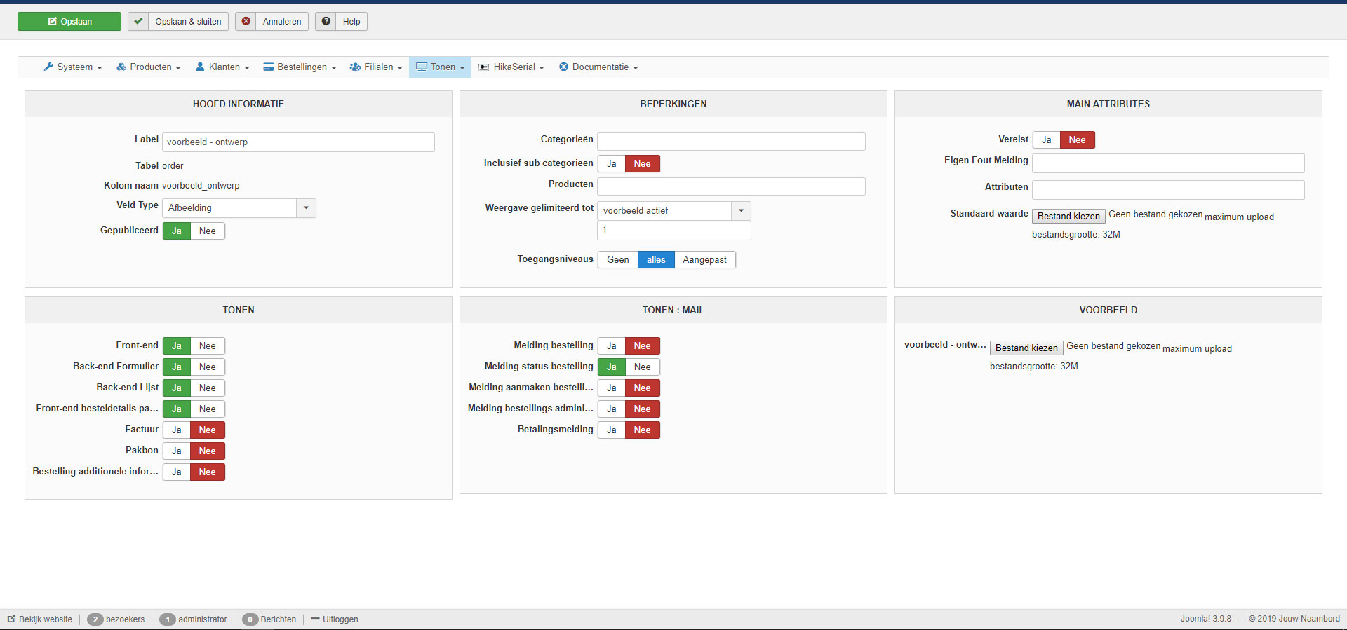

Could you also provide a screenshot of the settings of the custom field ?

It only happens after editing the tab "Additional information". here's the screenshot of the custom field settings.

Thank you for the additional information. We'll look into it. In the mean time, I would recommend to try changing the type of the custom field to "AJAX image" instead of "image". That should prevent the issue.
