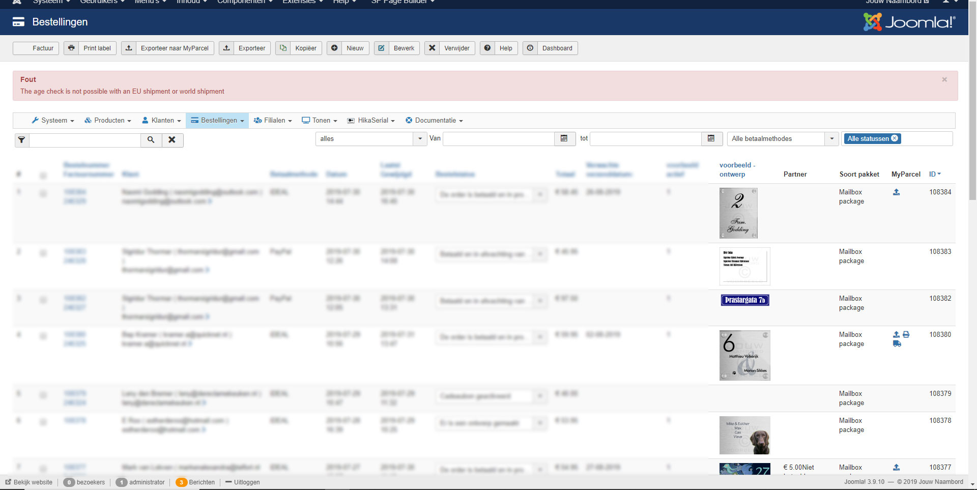

-- Error-message(debug-mod must be tuned on) -- : agecheck not possible
In the MyParcel plugin I found a little bug. When exporting an order with a foreign address to MyParcel I get this errormessage. See screenshot.

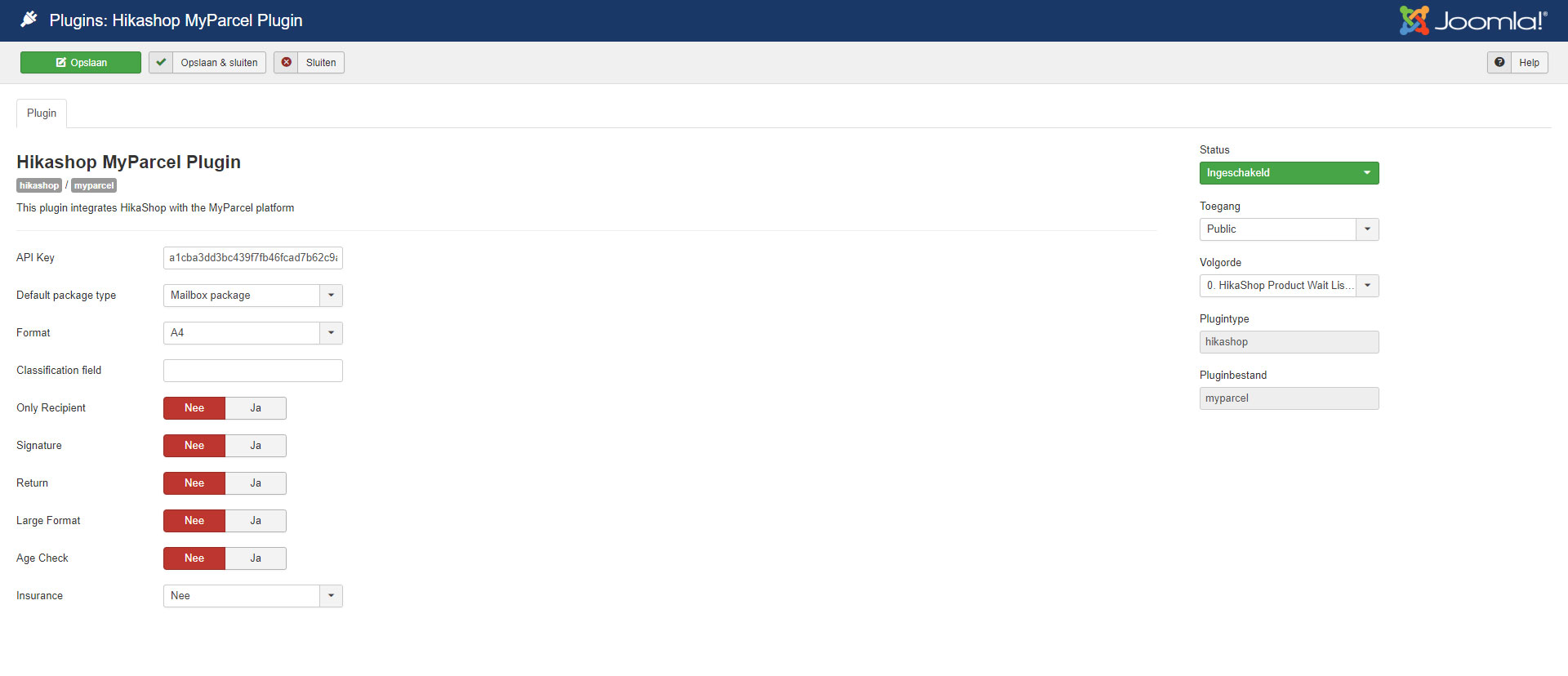

6 years 10 months ago #309373
I added a screenshot and as you can see there it is deactivated?
