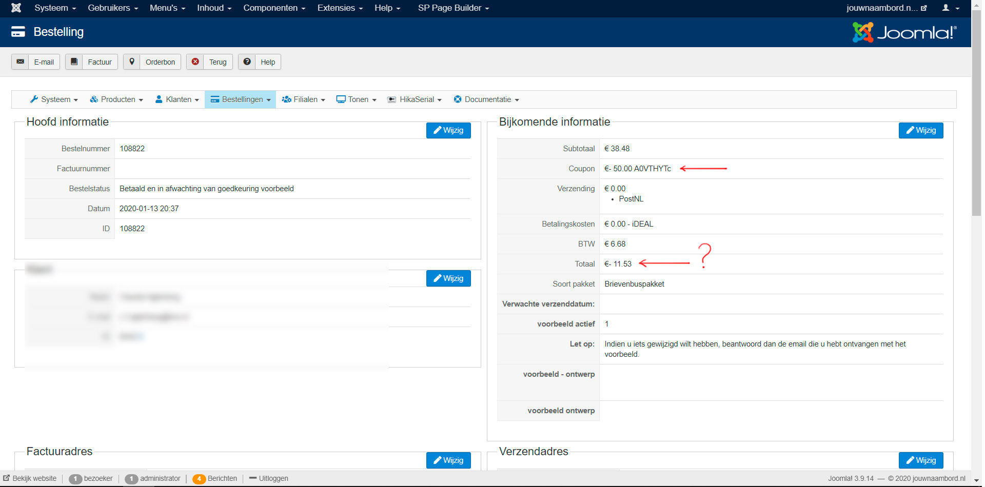

When a customer uses a giftcertificate (hikaserial) f.e. € 50,00 for a product with a lower price, the orderamount is set negative instead of € 0,00. See screenshot.

I tried on my end but I'm not able to reproduce the issue when I do an order on the frontend of my website with a coupon or giftcertificate.
Can you try to reproduce the issue ?
I was however able to get a negative amount by modifying the products / shipping fee / payment fee / coupon fee of the order in the backend. In that case, the recalculated price goes below zero. I've added a patch for that for the next version of HikaShop. The issue is quite low though as that's not something you have to do often and on top of that, you can fix it by adjusting the amount of the discount in the additional edition popup of the order.
