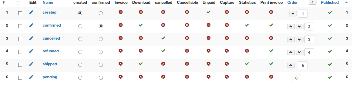

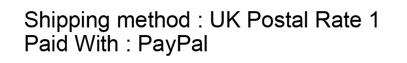

I seem to have a bit of an issue. When and order is created is showing as paid with PayPal. I wouldn't expect that to be the case if payment has not been made. I also wouldn't expect the invoice to be an option of the order hasn't been paid for.
I have attached the order statuses that are set up.

Regarding the "paid with:" that's because you made a translation override from "payment method" to "paid with". I suppose this was made to better suits your needs elsewhere.
So this actually just displays the selected payment method, and doesn't imply that the order has been paid. It's just your translation override which implies that.
Regarding the invoice being available, I'm not sure what you mean. Where is the invoice available ? In the frontend for the customer ? Your order statuses are not configured to allow the invoice to be available to the customer.
So I don't see why the invoice would be available, unless you have installed the PDF invoice plugin, and you configured its settings to provide the invoice for created orders.

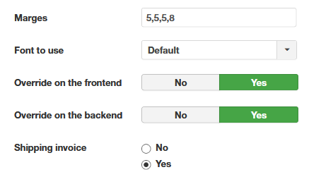

I do have a language override. If I remove it the text still says Payment method : PayPal which suggest that the order has been paid for. If I disable the plugin I still get the same message on an invoice. The settings for the plugin are in the attached screenshot.

Well, to me "payment method: PayPal" means that PayPal has been selected as payment method, not that the payment has been made.
But if you want to change that, you can change it to "selected payment method: PayPal" for example.
