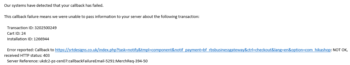

I have two payment plugins, PayPal and WorldPay. The PayPal works fine however, when a payment is made via WorldPay hikashop does not seem to recognise a payment has been made. I would be grateful for any assistance.

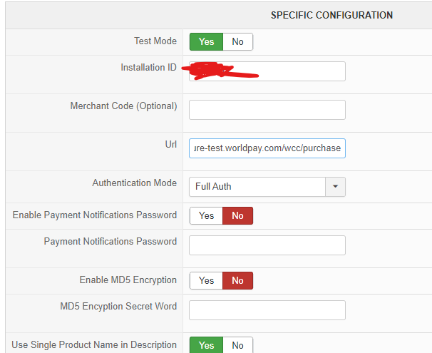

And also show us how you configured your worldpay payment method through some screenshots ? Thank you.

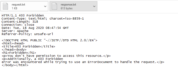

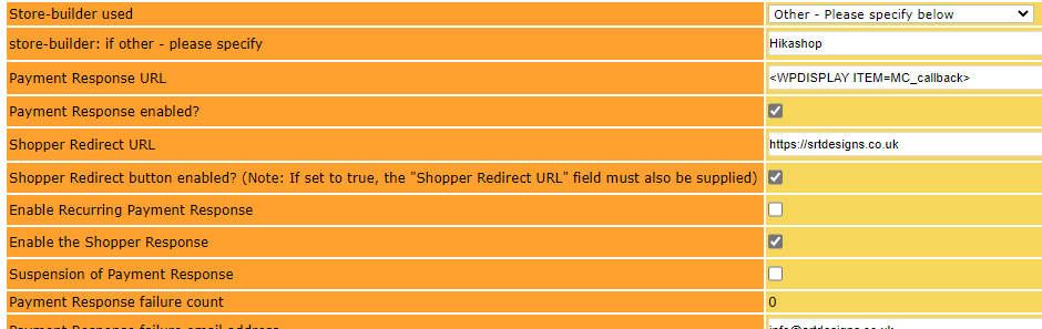

I have attached some information from WorldPay. Can you please advise me if the plugin is sending this information?
Also, what does the Notification Hostname do?

Thank you for your response. I apologise for not replying sooner as I had not seen your reply. I have attached some screenshots to see if that helps you to advise me how to resolve this issue which is stopping me putting my site live. Many thanks.

I removed the .htaccess file and it worked. I'll look at the reason in more detail!
If you are still having that issue, can you take a look at your server log in order to understand what and why you have a 403 ? Thank you.
