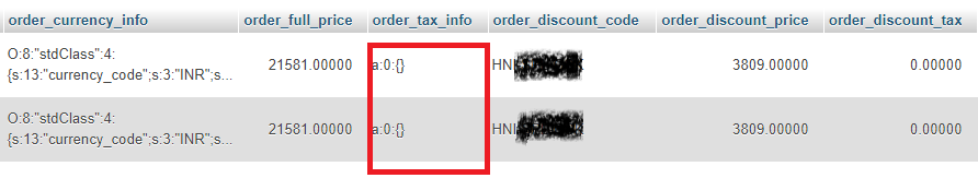

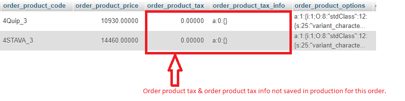

We are showing unit price on checkout(Unit Price(Excl. GST)) and performing calculation on it.
Adding Promocode if applied and GST on Unit Price of the product.
Issue is some of the order are created with Product Price(Unit Price) + GST(TAX) and after that user applied discount and GST(Tax).
But total amount is stored proper.
We are facing this problem with some of the orders.

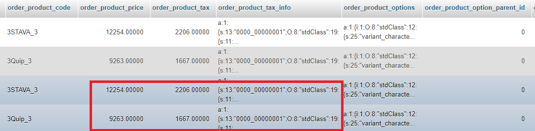

We have searched for this issue and found some difference in the hikashop_order_product table and hikashop_order table. Tax is not saved and tax info is also not available.
Please find attached screenshot for more details.
Thanks in advance!

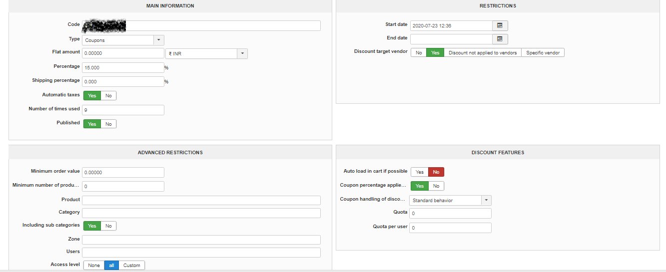

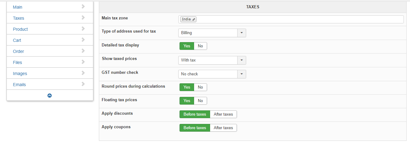

5 years 11 months ago #323700
Can you provide screenshot of your Taxes configuration (in HikaShop => Configuration, Main tab and Taxes part) AND of your Coupon (promocode) as well.
Awaiting news from you to be able to answer you precisely.

  • Posts: 13
5 years 11 months ago #323741
PFA screenshots of hikashop configuration main taxes and coupon code details.
For some of the orders tax info and tax discount amount is not stored in the table.
Thank you!

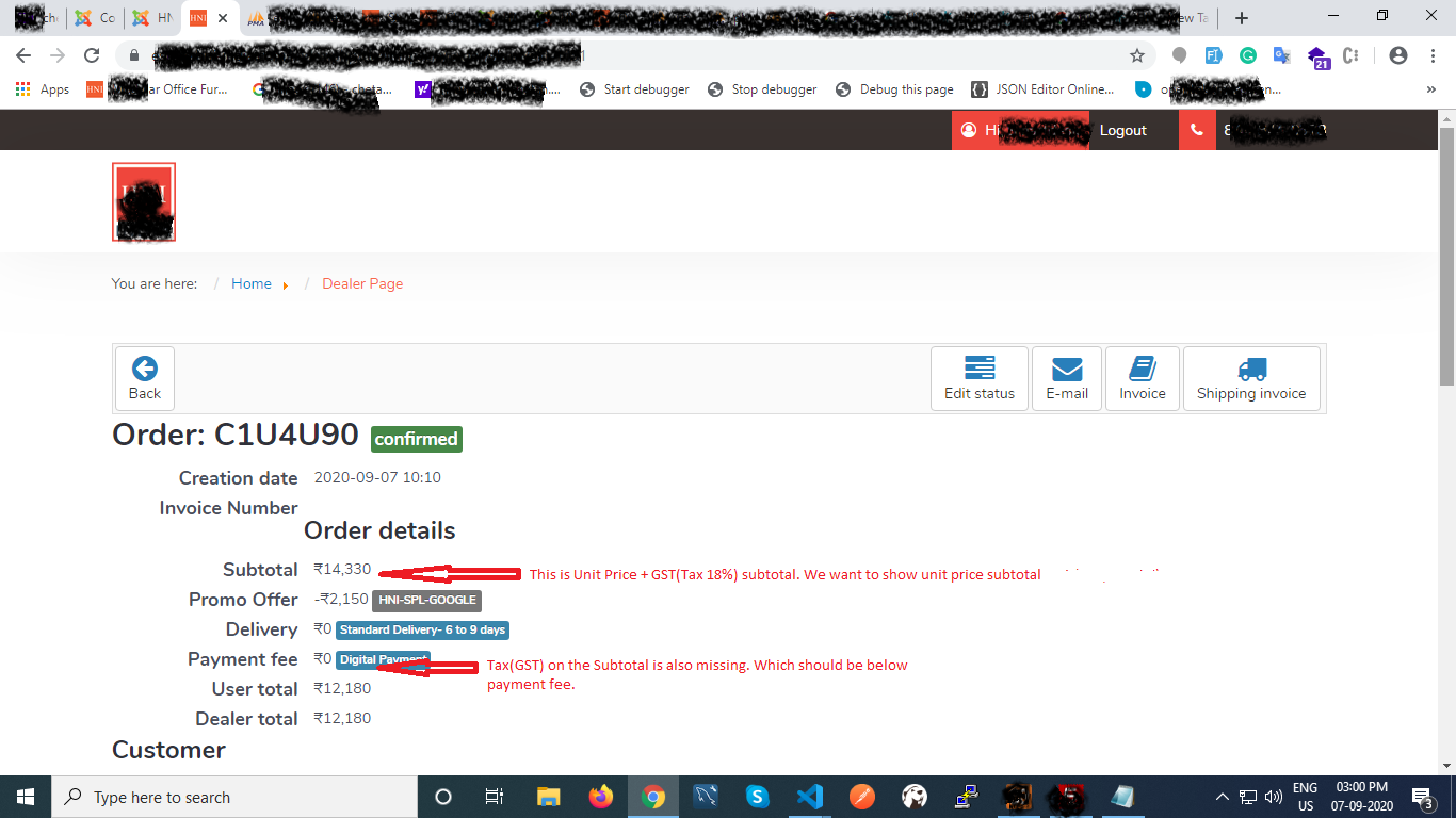

Yes we are using Hikamarket for managing vendors.
Display issue of order amount and GST amount is on all the screens, backend and in email notifications also.
Cutomer can create orders through the checkout process. We have same UAT environment and same setting on it. In UAT environment it is working fine for same order with same scenario.
How to configure a special "collect on delivery" payment method limited to a user group attached to our users?

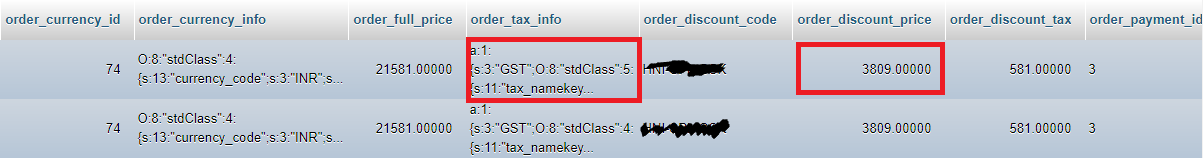

Today one more order created with same issue. Order product tax and order product tax info is not stored in the table.
PFA screenshots from UAT environment and from Production environment you get an idea from that.
Please let me know any solution for this earlier it was working properly for all the orders. Now for some of the orders it is not showing GST but total amount which customer pay is proper.

From what I can see on your screenshots, it looks like the system doesn't add any tax to the order because it didn't find any tax rule to apply to the order.
The subtotal and total amounts include the tax value because you have the "floating tax prices" setting activated and thus you enter the prices with taxes in your shop and the system then calculates the amount of the taxes based on the tax rules. But it doesn't find any matching tax rule, and thus it can't calculate the tax amount and thus can't display it.
So it's not a display problem, but a tax rules setup issue.
So the problem is with the settings of your tax rules in the menu System>Taxes.
Either the issue is that the products of the order don't have any tax rule linked to them via the "tax category", or the billing address of the customer is in a zone that isn't in the zone selected in your tax rules, or a combination of both.
  • Posts: 13
5 years 11 months ago #323801
We are discussing here to resolve the issue that's why I am sharing the screenshots.
Problem is creating for some of the orders only and others are working properly.
If the order_product_tax and order_product_info stored properly we can solve this problem.
Billing address of the customer is in the zone selected in tax rule.
I have checked all the configuration from the admin panel. Please have a look at the below configuration.
India is published as a tax zone (System > Configuration > Zones)
Main tax zone set to India (System > Configuration > Taxes)
Created a tax rate with tax namekey as "GST" with a rate of 18% (System > Configuration > Taxes > Manage Rates) and
Tax rule for India(System > Taxes ) Default Tax Category
Product Tax category is set to Default Tax Category (Product > Tax Category)
Is there any other setting remaining?
Can you please tell me from where the order is created from the code so that I can debug it.
Please let me know if you need more details so that we can resolve this issue.

PFA screenshots of the product setting page, address of the customer and other screenshots as well. There are two products in that order both are the variants.
Shared all the screenshot please check.
Thank you!

Well, I don't get the same result as you when I do the same thing on your website.
I end up with no tax found in the checkout:
monosnap.com/file/oO2Aw2q4Cl181Ge5uDPQZ84oyAc0W7
And your screenshot of the address of the customer as well as the screenshot of the tax rules listing explain why.
The customer address, as well as mine, doesn't have a country selected (I suppose that you disabled the "country" custom field in the menu Display>Custom fields.
But in your tax rule, you've configured the "zone" setting to "india" so that only customers with an address in India are charged taxes.
But since the country is not provided the system cannot use the tax rule.
You should either activate the "country" custom field so that the country can be filled in the addresses, or remove the zone restriction from your tax rule so that the tax applies to everyone on your website.
I can only suppose that the taxes are added for you and other customers on your website because you had created your addresses before disabling the "country" custom field and thus the tax system can still find the country in these addresses even if it's not displayed.

Maybe it's because you have the geolocation plugin activated. In that case, since I'm not located in India the tax won't apply to me and since you're in India you would get it.
So anyone in India with a VPN or a proxy in a foreign country would get the same issue as me and not you and most customers as their IP is in India.
As I said, just remove the country zone from your tax rule and it will apply the tax to everyone, problem solved.
