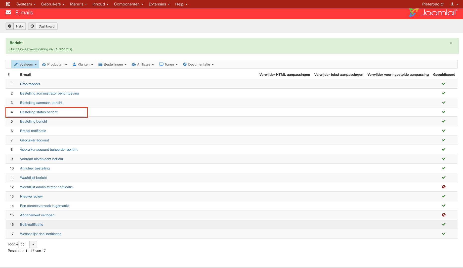

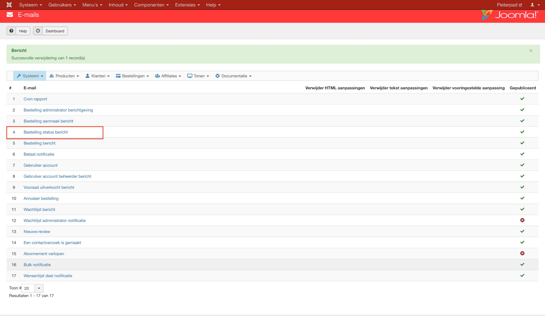

Can you provide your Emails listings screenshot, in System dropdown => Emails, please.
Can you tell us too which email precisely is concerned by this issue, in order to process some test on our side ?

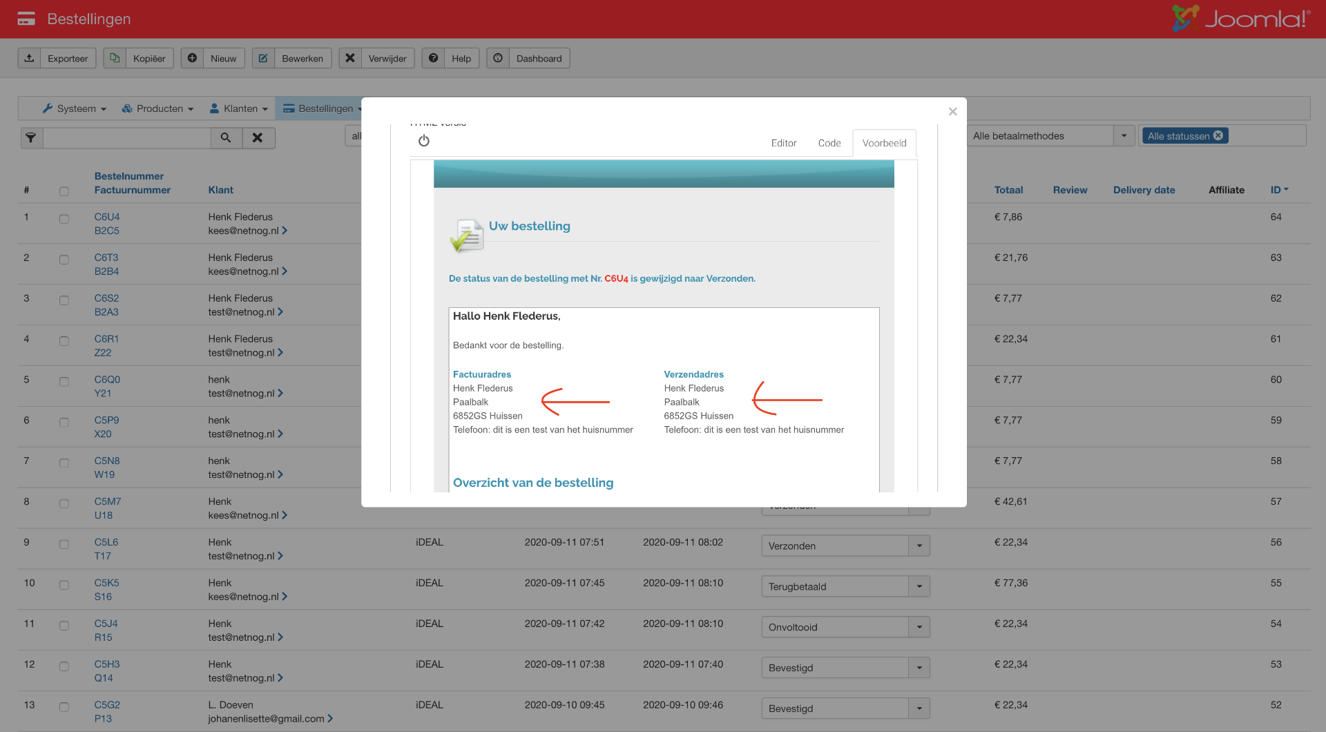

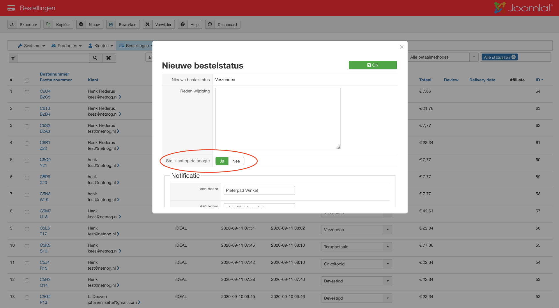

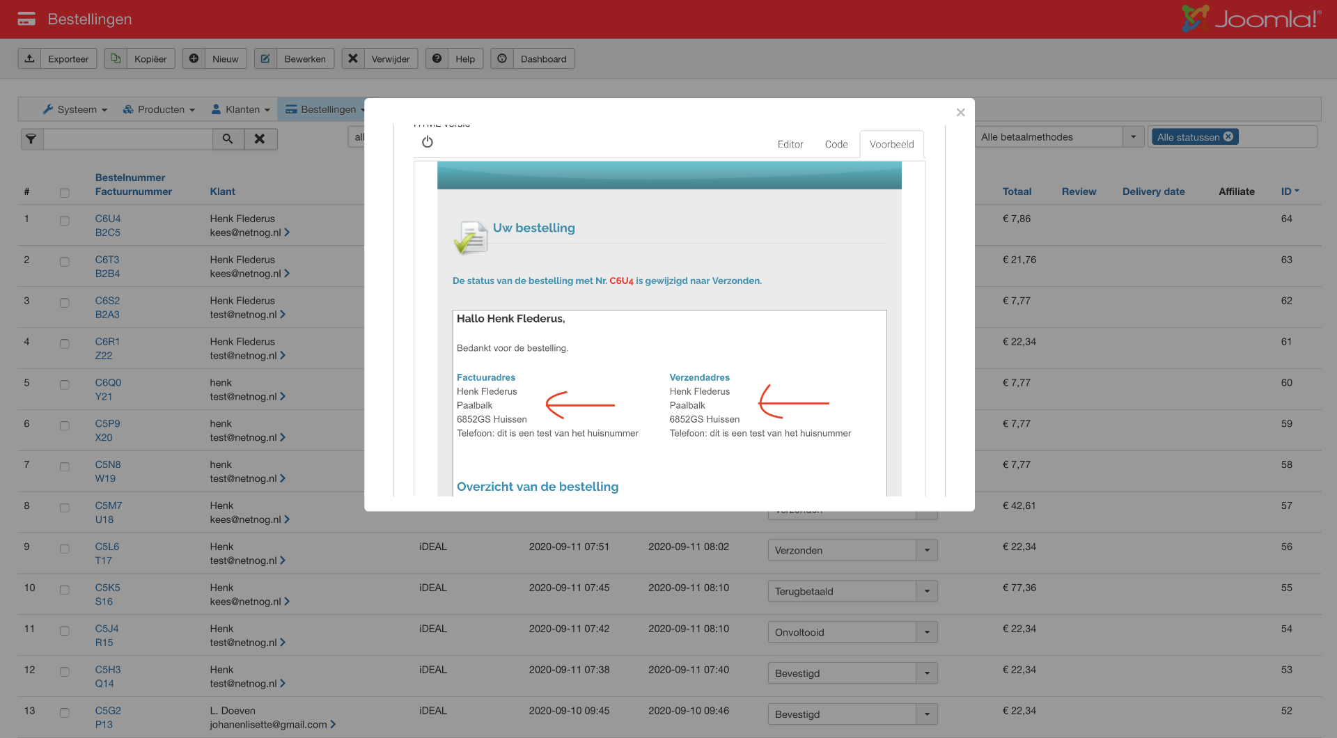

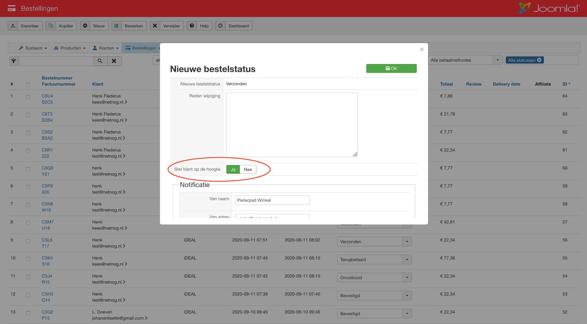

Of course I will gladly send it. I attached three screenshots. I hope this already provides a sufficient picture of where the error is. If you want access to Admin, please let us know. Then we can arrange this outside of this forum I think.

Where did you add the address custom field tag ?
Normally, you're supposed to do that with the "address format" setting under the Checkout tab of the HikaShop.
When you do that, it will add the modifications to the address_template.php view file for both the frontend and the backend.
What you describe seems to indicate that you've directly edited the address_template.php view file via the menu Display>Views, but only for the frontend, while the email from your screenshot is sent from the backend and thus doesn't have the modification.

It probably went wrong there. I have now reset the "address format" setting under the Checkout tab of the HikaShop. Then added {address_street2} and saved. Now I see that things are going well.
Thank you for your support, very nice !!
