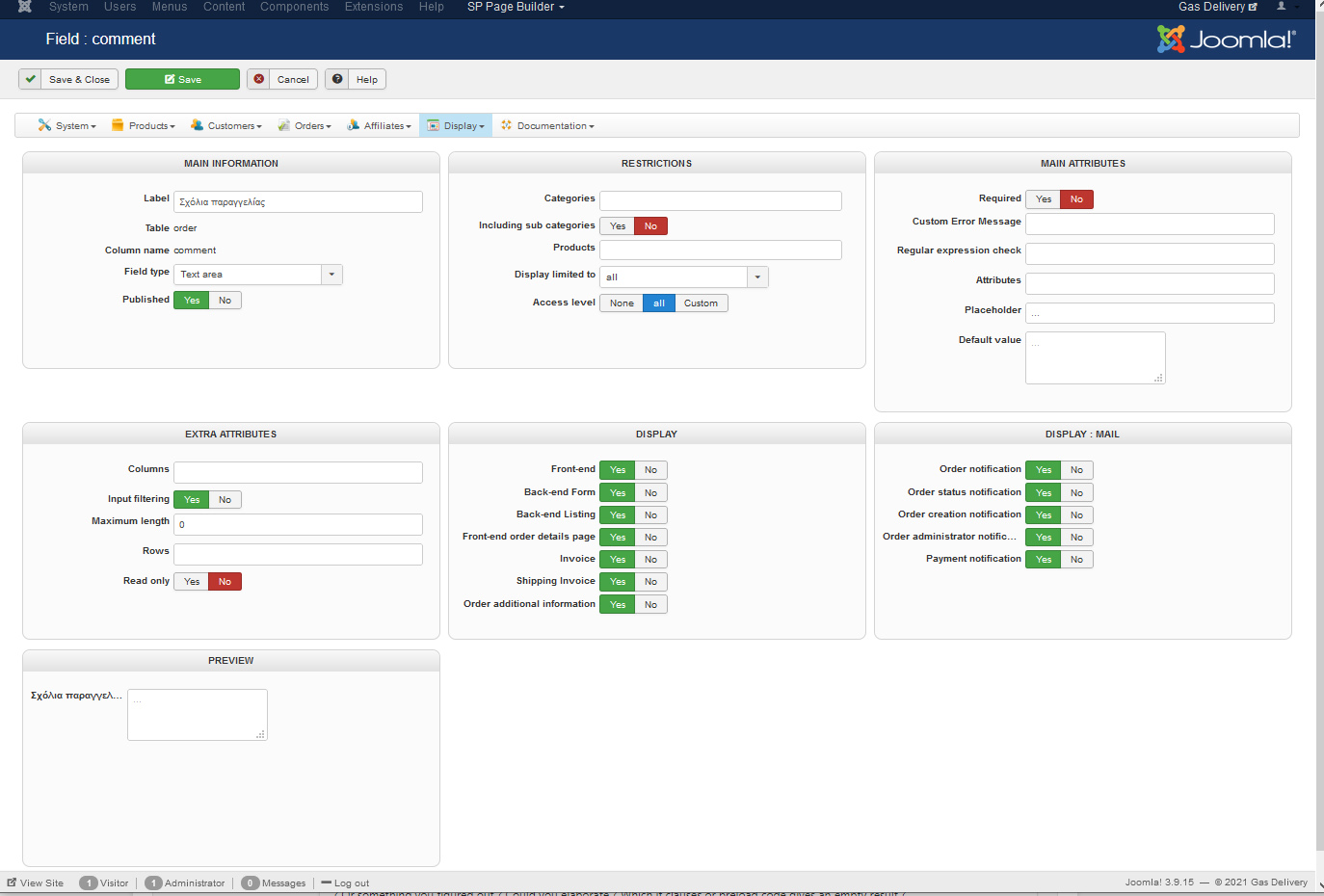

1. Could you provide a screenshot of the settings of the comment custom field ?

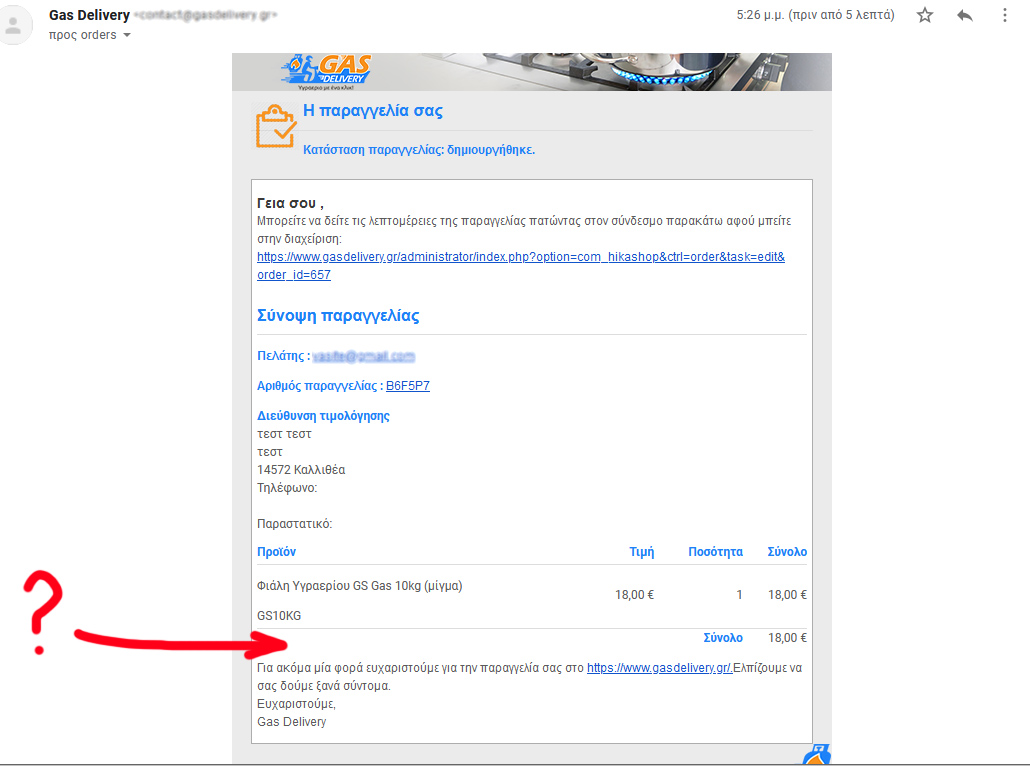

So lets take the things from the beginning. When I make web order, the comment is shown. When I make app order the comment is in the table and we can see it in administrator view of the order. However, the emails sent to client and to admin, dont show this comment!

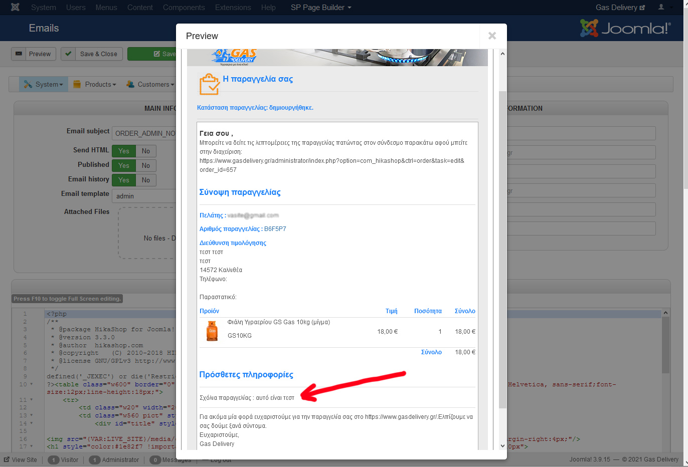

4. I can see the cooment in its predefined position pls see image preview.jpg and compare with the email we receive for the same order with the preview admin_notification.jpg where yoy can see the additional info is empty!

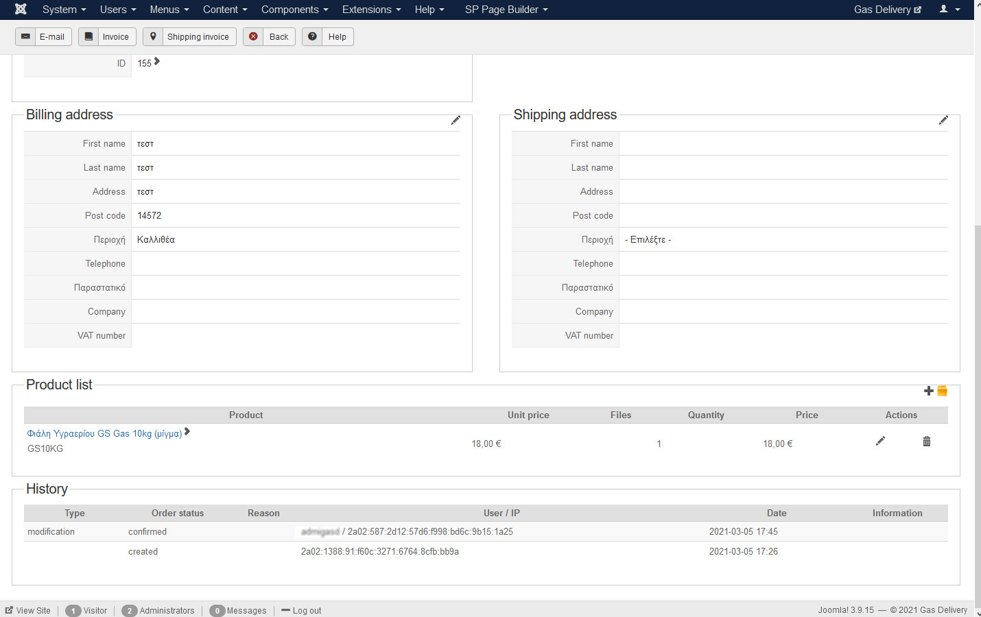

1. One possible reason this would happen would be if the comment was added to the order after the order was created. In that case, it would be normal that these emails do not contain the comment since they are sent when the order is created, and not when it is updated.
Could you provide a screenshot of the "history" section of that particular order (you can see it at the bottom of the page when you edit an order via the orders listing in the backend).
