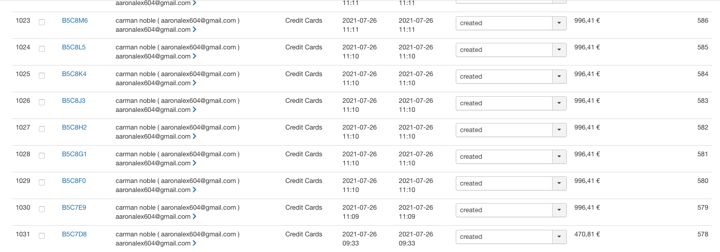

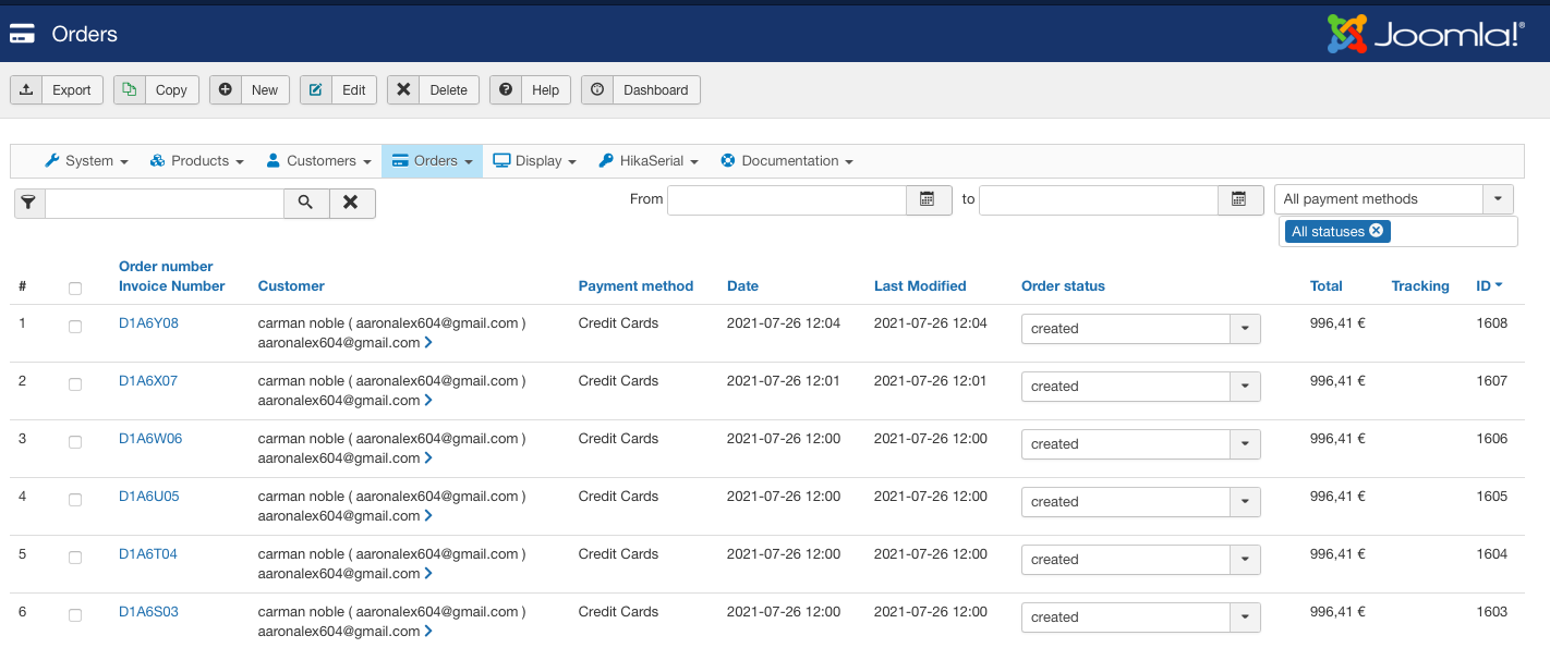

This morning I got more than 1000 orders from the same customer... obviously something strange from an IT point of view.
I know I don't have the last Hika version since we are adding to the basket custom products (watches) made from a configurator and at each new version of HIKA we have to spent hours to re-write the helper file which is an heavy process.
You will find print screens below, from order 1 to 1000 (first and last page only of course)... Any Idea how this could happen?
Strange also, his orders starts at number 1... not increased from the last regular one
Thank you for your help
Jean-Loup

4 years 10 months ago #334682
Your customer seems to have created several orders with the same cart, so setting the "Clean cart when order is" option to "Created" via "Hikashop->System->Configuration->Main" will probably prevent that kind of issue from happening again.
Kind regards,
Mohamed.
