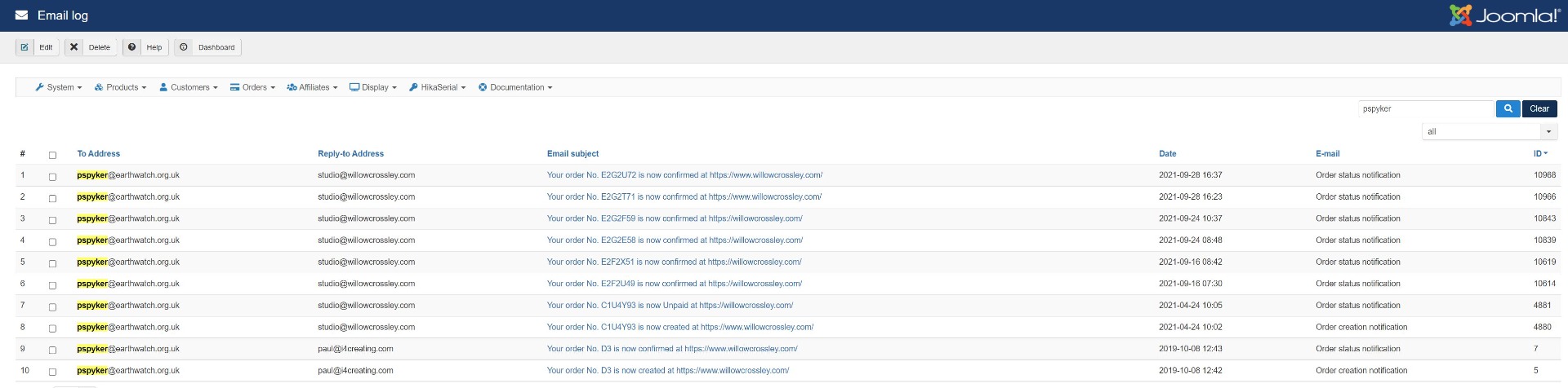

Could you provide a screenshot of the details of an order's information in the backend and its corresponding email notification to the customer for an order with the issue ? You can find the emails sent by HikaShop in the Customers>Emails history menu.

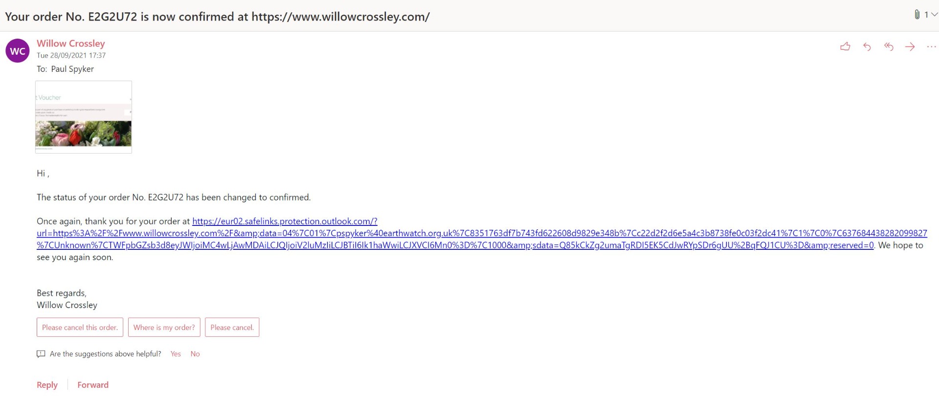

Hi, that is the case. It seems like an email is sent to confirm and attach the Voucher, but not the confirmation email. I have attached all images that hopefully will help you see what the issue is.

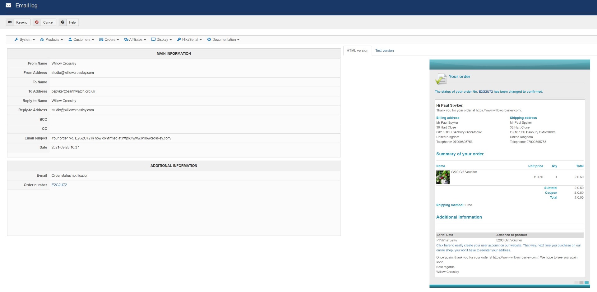

I can see the serial being added to the order status notification in the HTML version near the end, in the "additional information" area.
On your last screenshot however, you're displaying the text version of the email, not the HTML version.

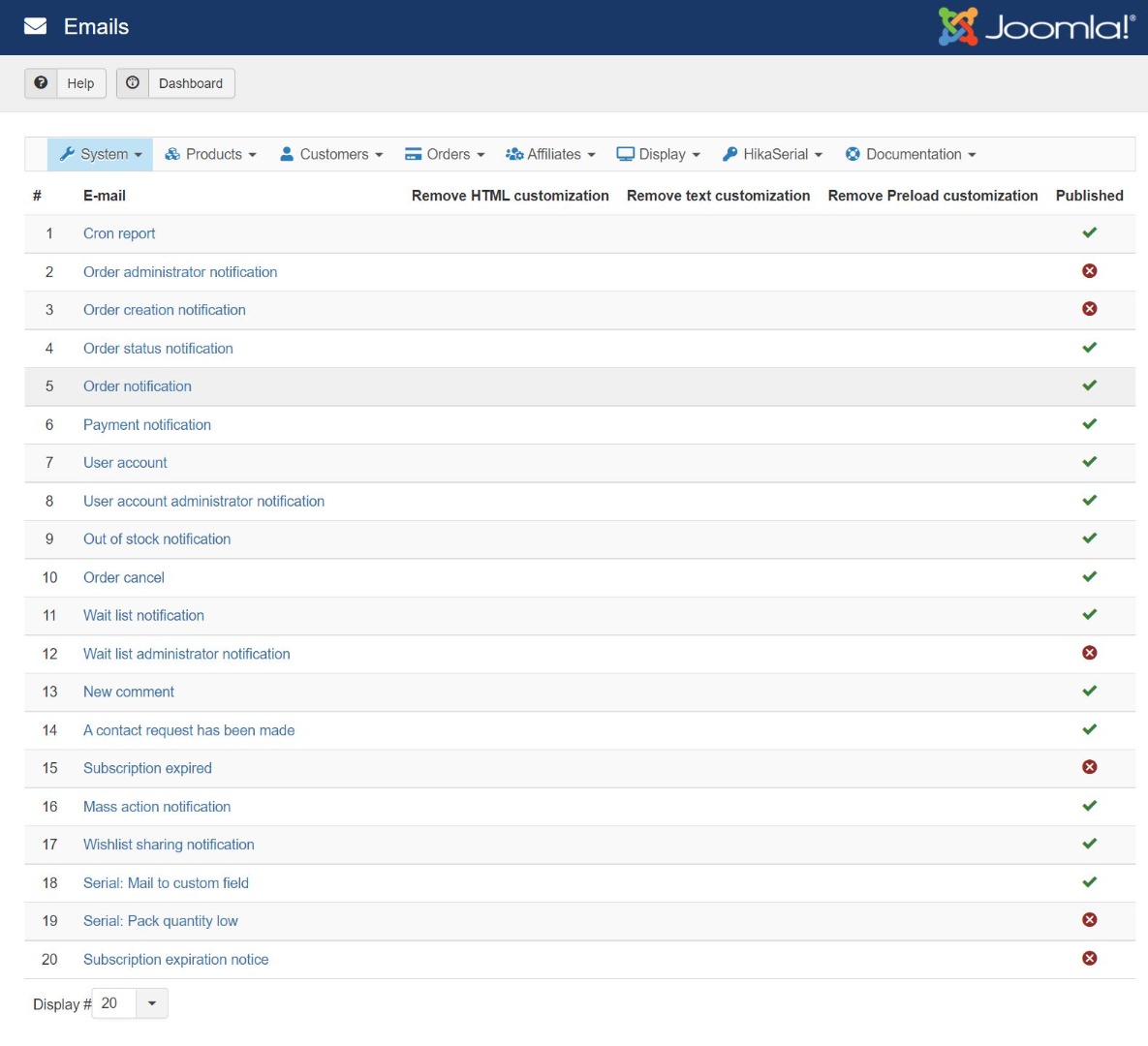

Go in the menu System>Emails, edit the order status notification email, empty the "text version" textarea and save. That way, the text version will be generated from the HTML version and thus it will contain the serial.
Another solution is to turn off the "Multiple part" setting of the Emails section of the HikaShop configuration so that only the HTML version is sent.
