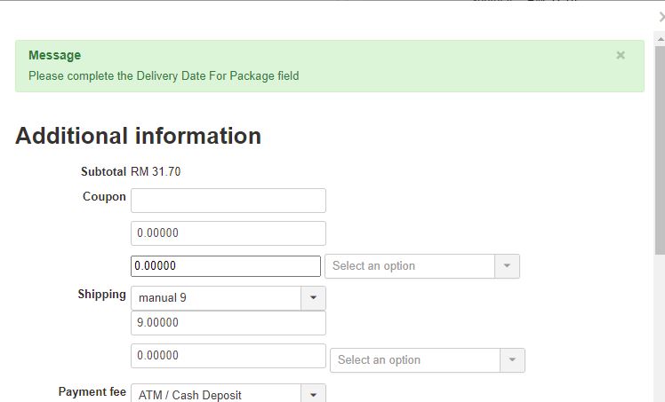

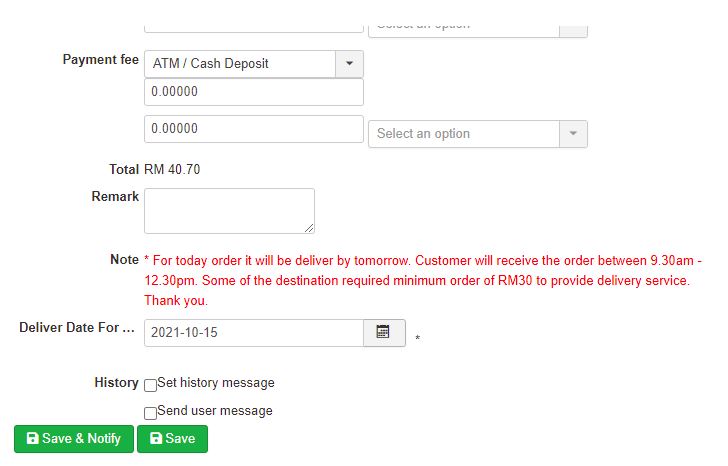

Hi, I have tried to edit the time on the order details page at the backend. But when I edit the date, it shows an error to fill up another custom field, but this custom field is not included in the backend, because I already set it to show for a specific category.

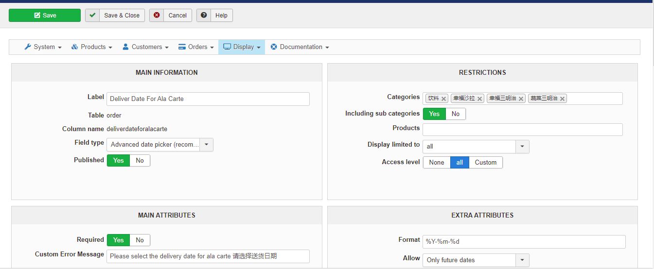

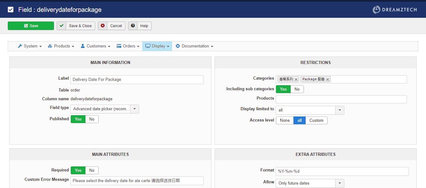

There are two custom fields:
dateforalacarte and dateforpackage
When customers order from the ala carte category, then it will only show dateforalacarte on the frontend, but when I want to edit the field on the backend, the system wants me to fill up for dateforpackage also. Kindly check on the issue
