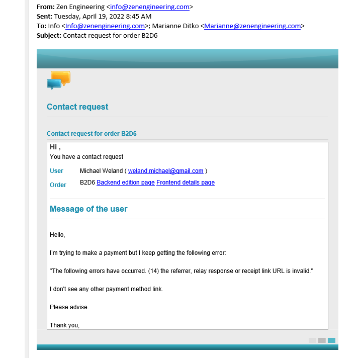

I received a PayPal payment notification this morning from the guy below and a notification that he created an account. However, I did not receive any order notification on what he ordered, address, etc.
He received the attached but I did not.
Also a user, who purchased via Authorize is getting an error message when he tries to pay. The same thing happened to another user and maybe others. PayPal seems to work for payments although I didn’t get the order details notice but Authorize seems to not be working for some reason.

4 years 4 months ago #341050
This is all the info I have on the error. By the way, he tried the website PayPal link and was able to make a payment. The trouble seems to be only with Authorize.
See attachment

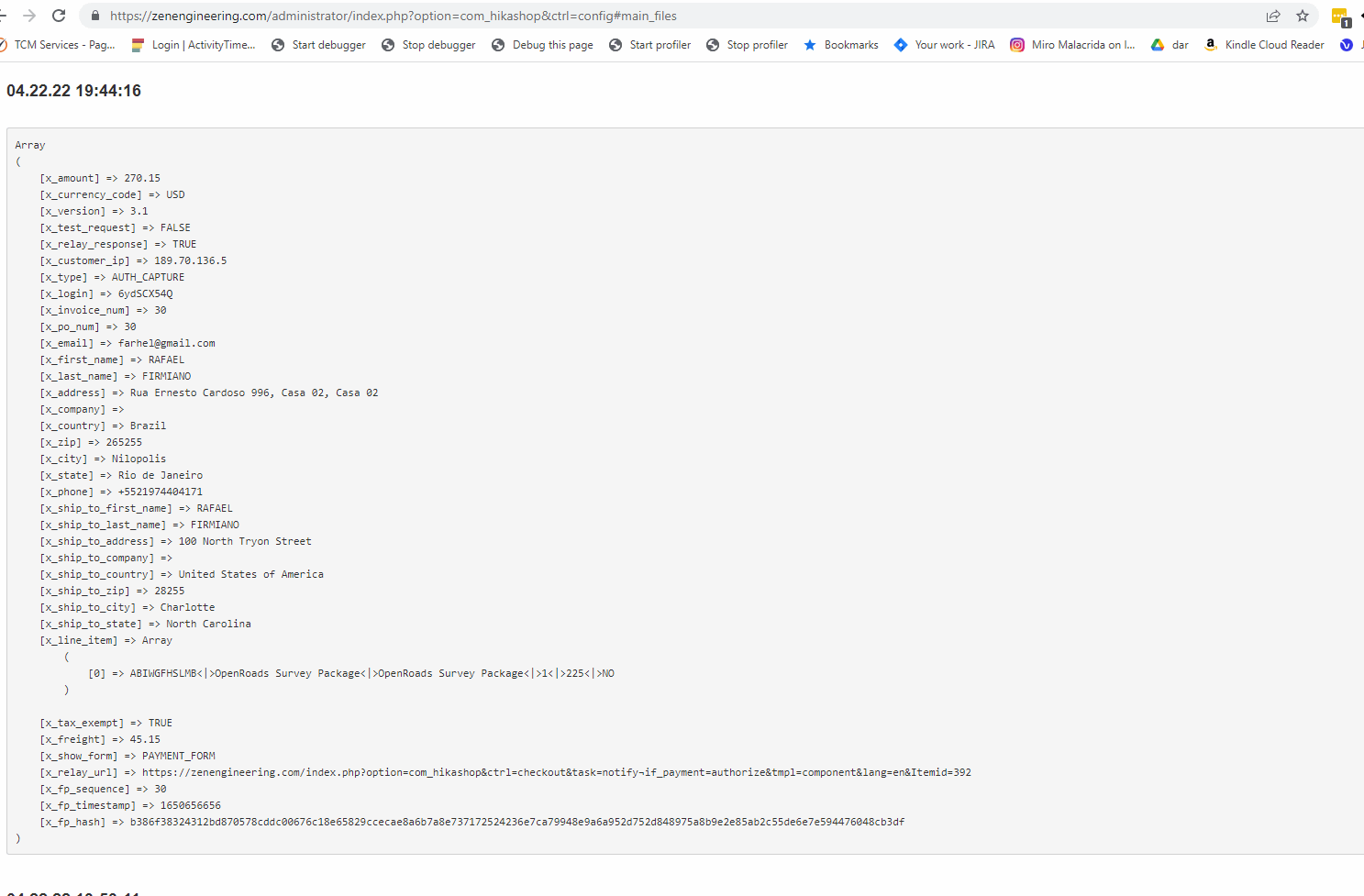

If everyone has the issue, then you should activate the "debug" setting of the payment method and do a test payment. Then, provide the content of the "payment log file" available in the HikaShop configuration and we should be able to tell you what to do.

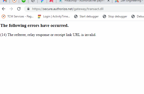

I activated the debug setting and the Test payments.
I got the error in the screenshot when I push the pay button. (14) The referrer, relay response or receipt link URL is invalid.
Also, the payment log file is attached in the sreenshot.

From what I can see, you have set up some URLs in your Authorize.net account which do not match with either the URL of your website or the relay URL sent by HikaShop to Authorize.net and thus Authorize.net refuses the payment request.
I would recommend you to check your Authorize.net account settings and if you can't find what is wrong there, contact the Authorize.net support so that they can review your account settings with you.
