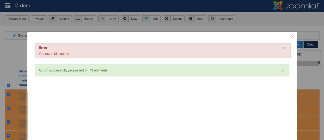

my client recently updated a number of orders via actions on the administrator/index.php?option=com_hikashop&ctrl=order&order_type=sale&filter_partner=0 While everything seems to have worked as expected the screen displayed the error as per the attachment. I would appreciate your thoughts/suggestions on why this may have happened.

This indicates that the user points of one of the users (who were linked to the orders being modified) went below 0 with the action that was made by your client.
For example, if he refunded the orders, the points gained by the users when making the purchase would be substracted from their user points. But if they used the points they earned in the meantime, then this situation could happen.
In that case, the system displays that error message and set the user points of the user to 0.
We'll improve the message to "The user %s got % points deducted. However, he only had %s points left. His user points has been set to 0 but you might want to do something manually." for the backend so that it's easier to understand whose user account the message is for and why it's happening.

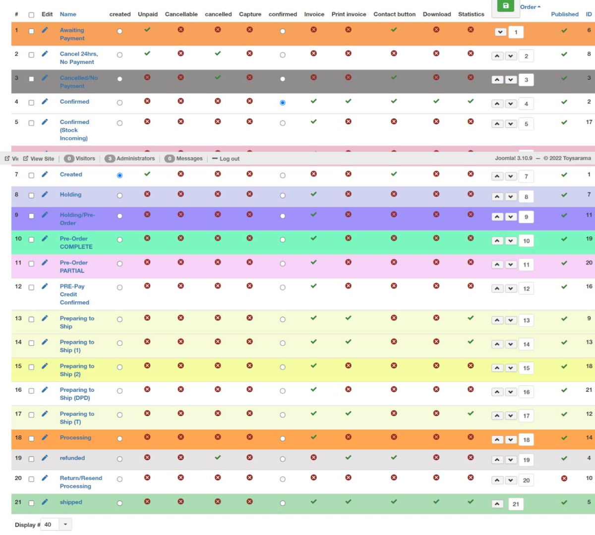

So lets take an example of the order 1019469:
If you look at the history of the order you can see that:
- it was first created on the 03-28
- its status was then changed to Processing on the 03-28
- its status was then changed to Awaiting Payment on the 03-28
- its status was then changed to Processing on the 04-26
- its status was then changed to Awaiting Payment on the 04-26
I can see that you've configured the "Reward Points" plugin instance in the menu System>Plugins.
And I can see that in the System>Order statuses menu, you've configured the status Processing under the "Invoice" column (and other statuses we don't care for this example). The statuses created and Awaiting Payment are not enabled under that column.
This means that on the 03-28, points were added to the user's account, before being taken off 1 hour and a half later, and then on the 04-26, points were added again before being taken out 6 hours later when the status was finally changed to Awaiting Payment.
So on the 04-26, if during these 6 hours, the customer would have placed an order using his points, it would have triggered that error message since he would have used points you would then try to remove by changing back the status to Awaiting Payment.
I checked this user's orders listing and that's not the case.
But you would basically have to check this for each order that was changed at the same time to find out which one was the problematic one.
This also means you have a problem in your workflow as you shouldn't add points and remove them a few hours later. Normally, you want to add points when the payment is made, and remove the points when the payment is refunded. So there is probably something to change regarding the order statuses setup based on your workflow and when points should be awarded and removed.

Are you suggesting that the Processing Status should not have invoice activated or should Awaiting Payment have the invoice column ticked?
I will forward the info you have supplied and look at this further and update in due course
David
  • Posts: 86180
4 years 4 months ago #341514
Yes, that's basically either one should be done. Or maybe other statuses need to be implemented so that once the points are added with a specific status, they aren't removed a few hours later with another status change as there is no reason for that.
Now, the "invoice" column is also used for the stock management and the generation of the invoice number, so your client should be careful about this when changing the order statuses setup.

Looking at the statuses the only ones checked as unpaid are Created, Cancel & Awaiting Payment. Should invoice only be ticked where payment has been received?
I would appreciate some guidance on how this should be set up so that I can avoid another error going forward. I have set up a
which of you are able to take a look it would be very helpful? The login is the same as I sent previously via the contact for if you still have the details.
David
  • Posts: 86180
4 years 3 months ago #341887
Under the "unpaid" column, you should have only the status before the payment (so that the customer has access to the payment of an order already created).
And under the "invoice" column, you should only have the status after the payment and not ones where the payment is invalidated (refunded for example). So under that column you should normally have "confirmed" and "shipped" by default.
I checked your website configuration.
Now, I can see you have a lot of statuses, and I don't know what each status is for, so I can't say anything for sure.
There are several things I feel are strange:
- in the column "invoice", you have the "return / resend processing" and the "Cancel 24hrs, No Payment" statuses enabled. I think you might want to disable them.
- in the column "cancelled", you have the "Cancel 24hrs, No Payment" and the "refunded" statuses not enabled and I think they should be.

thanks very much for the info. I have updated the statuses and would just like to confirm that the setting now look correct?

That look much better. Now please understand that I don't know what each status is used for and what is the workflow of the merchant on that website, so there might still be some things to change but it looks fine to me with the information I have right now.
