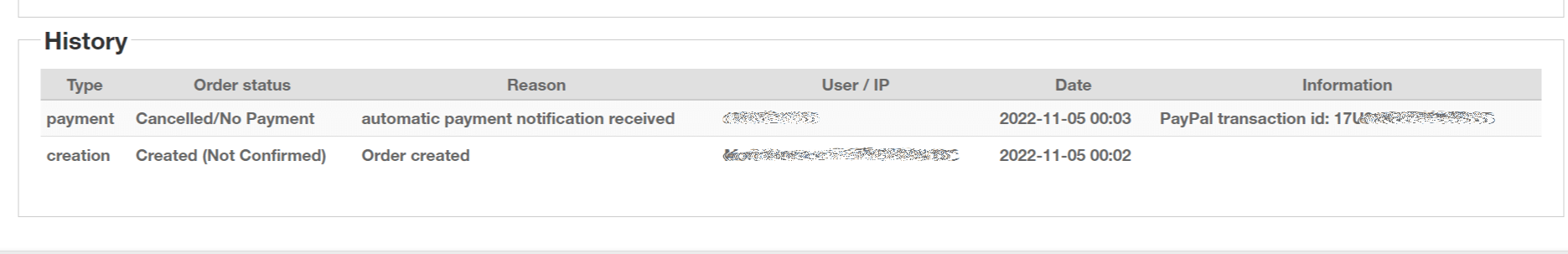

3 years 9 months ago #346394
-- HikaShop version -- : 4.6.2
-- Joomla version -- : 3.10.11
-- PHP version -- : 8.0
I have a situation where an order is placed and paid for using PayPal Standard. The order is then showing as cancelled but has a PayPal Transaction ID. The one or two that I have checked also match the Payment logs which I have just downloaded. It is also worth noting that some orders were not paid and therefore met that criteria.

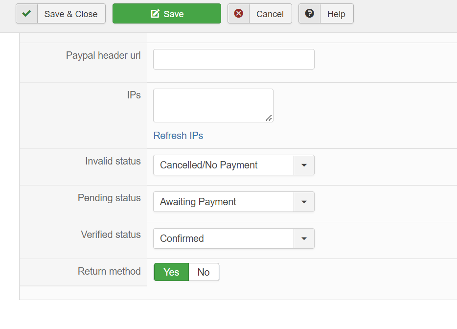

If the order was cancelled, it means that something was wrong. The two main reasons when it only happens for some orders are:
- the IP address of the PayPal server was not in the list of authorized IPs in the payment method (leave empty to avoid the issue)
- the amount paid was not exactly the same as the amount of the order (can happen if the "send order details" setting is activated in the payment method and the "round prices during calculations" setting of the HikaShop configuration is turned off)

3 years 9 months ago #346416
It could also be that the "verified status" setting of the payment method has been changed to "cancelled" instead of "confirmed", so that's another thing to check.

So either:

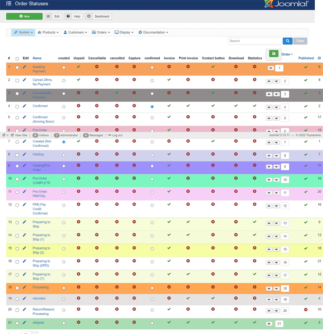

- you have selected "cancelled" instead of "confirmed" in the "verified status" setting of the payment method. So check it via The System>Payment methods menu
- you have a mass action or a plugin which changes the status from confirmed to cancelled on the fly during the confirmation of the order. So, do you have mass actions ? Do you have custom plugins ? Does it work fine if you manually changes the status of the order in the backend ?
These would be the things to check.

3 years 8 months ago #347193
Hi Nicolas
there are no mass actions or custom plugins that should impact on orders. It all seems so random. There is another order today where the same issue has occurred. The order can be manually changed, so all works as expected. As I have noted previously all was working correctly and had been up until recently.
