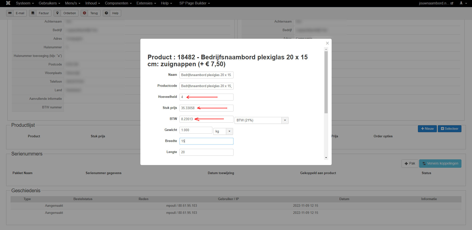

When I add a product to any order in the backend and than change the amount of that product (with pricelimits) the price is recalculated but the VAT is not. See screenshots.

This is indeed not supported yet. Thanks for your feedback. We'll look at adding this and other improvements as that area is getting old.
