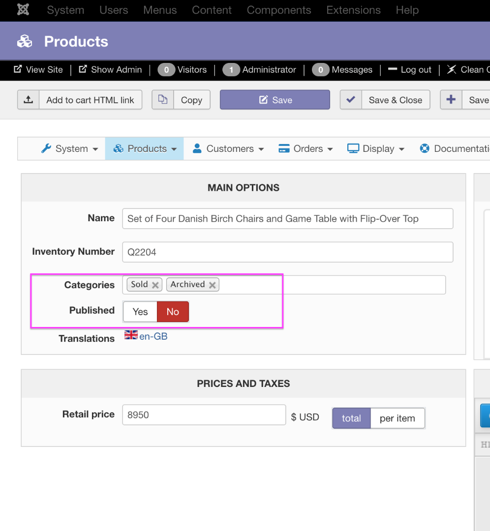

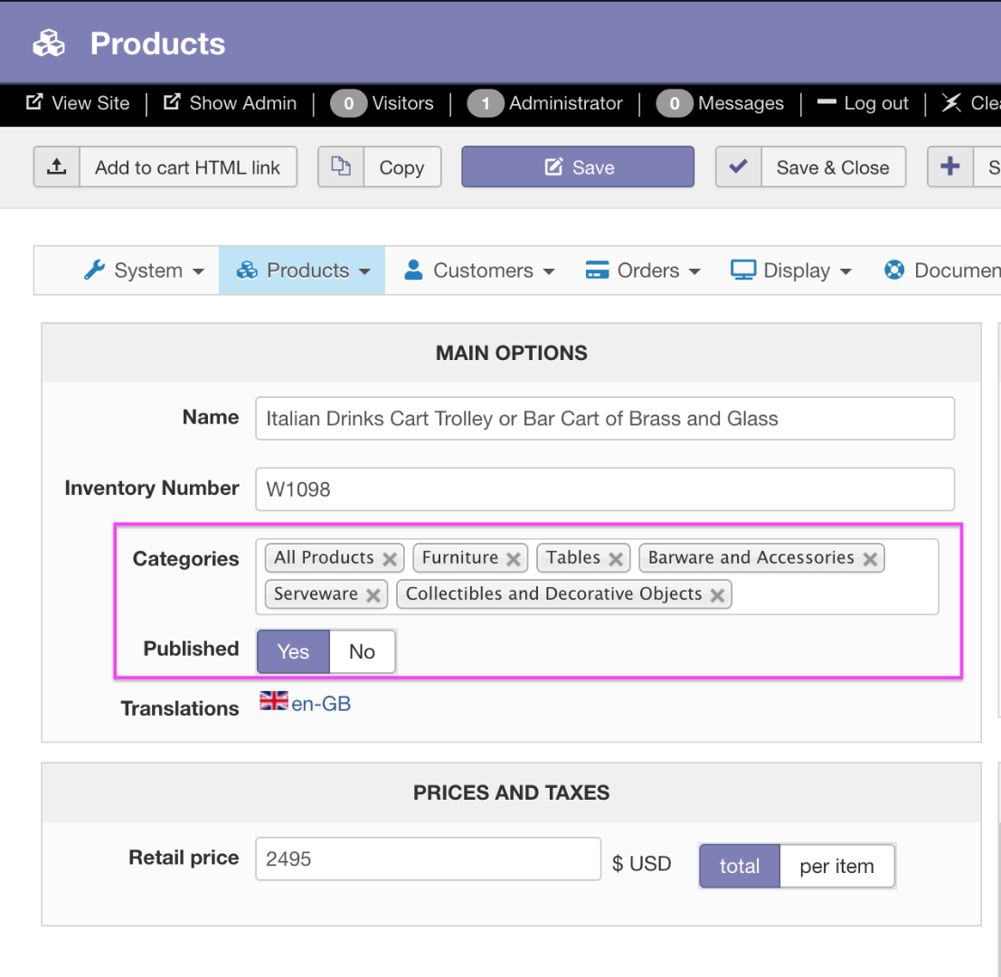

Thank you, Nicolas, the mass action makes sense. In this scenario though, I'm haven't been able to find the right filter. The shop is set up as a catalog so when an item is "sold" it's actually sold offline. Then, we manually unpublish the item and add "sold" and "archived" to the category field. Please see screenshot. When an item is for sale, it is published and assigned to various categories. Please see screenshot.
I've looked at all the filter possibilities but haven't been able to find an unpublished state to choose, or a "sold" and "archived" category to choose. When selecting "product columns" and "product_published = unpublished" the results (e.g. 1014) are the same as writing in "published," which is not correct. There are 375 published items.
Could you offer some guidance for this particular set up? I will certainly run the mass action on a backup copy first, but even before that I wanted to see if I'm even getting close to the right settings.

You can indeed use the product_published column. You need to use the value "0" instead of "unpublished".
Note that if you want to see what is filtered, you can use an action "display the results" instead of the "delete the elements" one. That way, you can confirm that the mass action will delete the correct elements when you change back the action.
