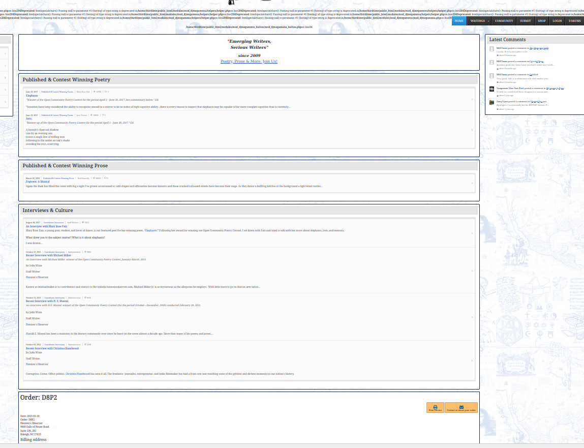

When a customer completes an order and it is confirmed, the customer is prompted on the front end to see their invoice. Upon clicking the link, the invoice is displayed at the bottom of the homepage at the end of other modules in the main content area of template Cassiopeia.

Mmm. I don't see how the invoice can be listed among the modules. Could you provide a screenshot of what you see ?

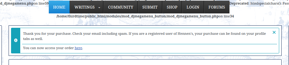

The first image is upon completion of the order and the second image is upon clicking the provided link.
