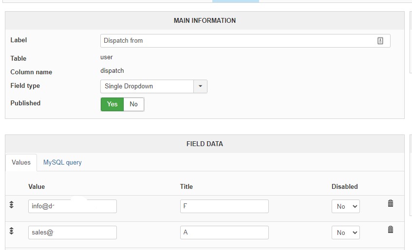

This is close but a bit too far. We don't actually need the customer to pick the warehouse because the staff will set that in the backend. I've made a custom field: user_dispatch
I have put the emails in the 'Value' column.

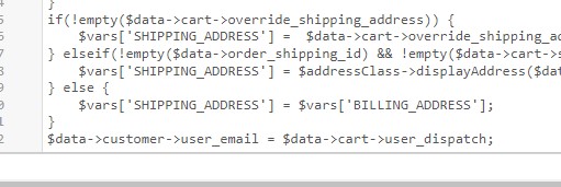

3 years 7 months ago #348290
Doesn't seem to be send the email, did I do something wrong?

Your custom field column name is not user_dispatch but dispatch, and it is in the "user" table, not the "order" table so you need to change the code to:
$data->customer->user_email = $data->customer->dispatch;
