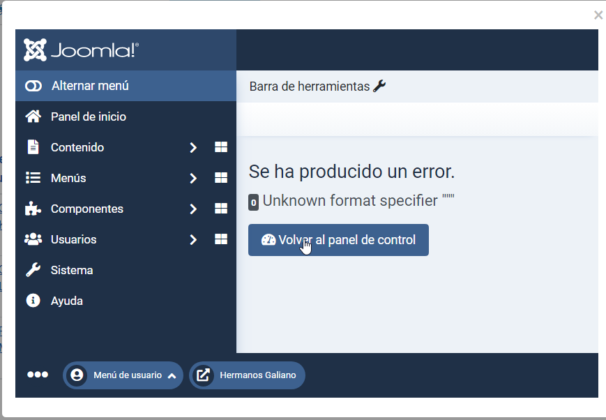

Hello.
When I try to change the status of an order, the error that I send in the attachment appears.

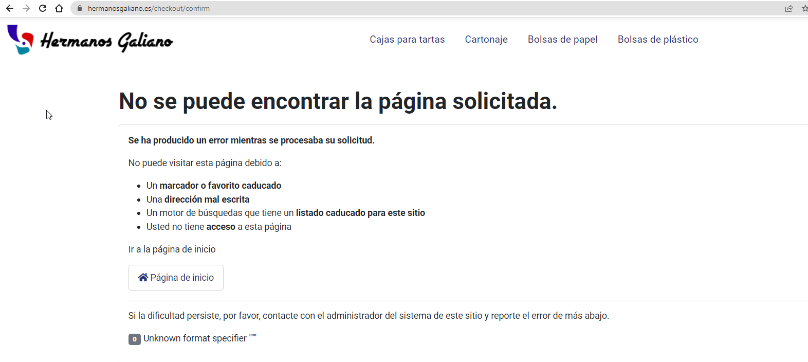

3 years 6 months ago #348711
When I try to finalize an order it also gives an error.

3 years 6 months ago #348715
Please turn on the "debug" setting of the Joomla configuration and try again. It will display more information about the error, which will allow us to tell you what to do.

3 years 6 months ago #348718
I have finally located the error.
It was a symbol (%) in a joomla language translation in a variable.
