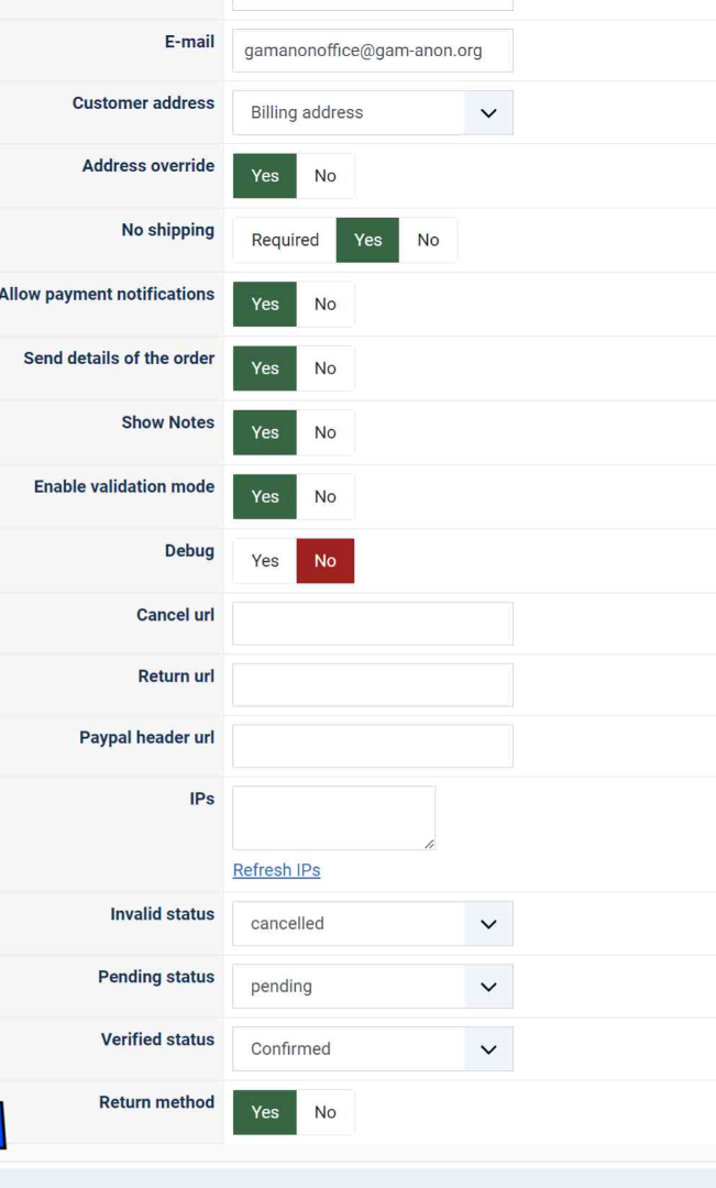

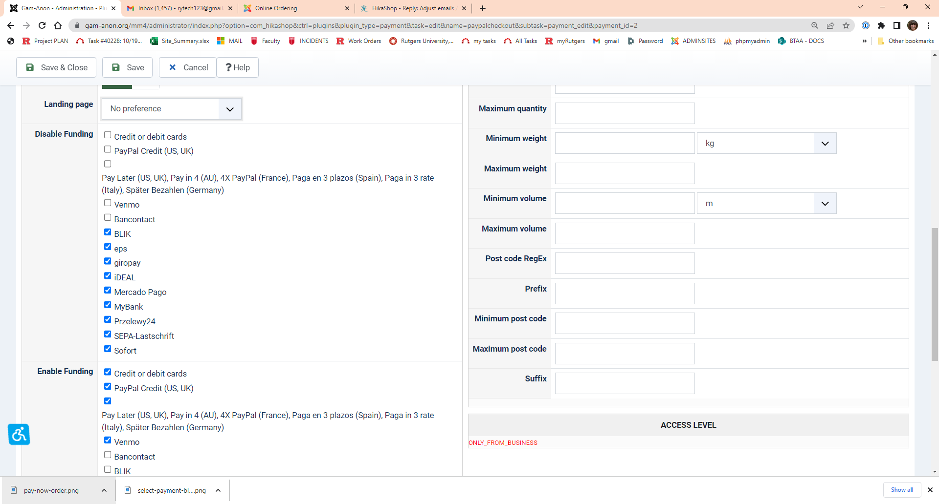

I need to figure out how to make sure that once payment is confirmed... that the status automatically changes to PAID
Here is how I have it setup.
Should I be using a different payment plugin for paypal?
How can I tell if paypal is talking properly to hikashop? FYI, in virtuemart it was 'talking' meaning it would change the status automatically to confirmed, then our admin received an email that it was paid.

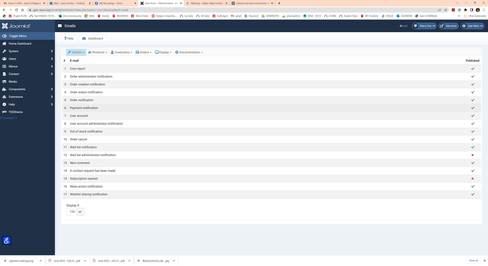

I also attached an image of all of the emails, they are all set to published.
Is there anything else you recommend that I do?

  • Posts: 85784
  • Thank you received: 14075
2 years 11 months ago #352807
You have activated the "enable validation mode" setting.
This means that for each payment, you need to log in your PayPal merchant account and validate it so that the payment is accepted. PayPal will only notify the website of the payment after you do that.
So since you apparently want it to be all automated, you want to keep that setting turned off, as it is by default.
Also, you're usign the old PayPal payment plugin. I would recommend switching to the PayPal Checkout payment plugin:
www.hikashop.com/support/documentation/4...to-new-paypal-plugin
You can read more about PayPal Checkout here:
www.hikashop.com/home/blog/497-hikashop-4-7-4.html
And yes, you can use translation overrides to change that text.

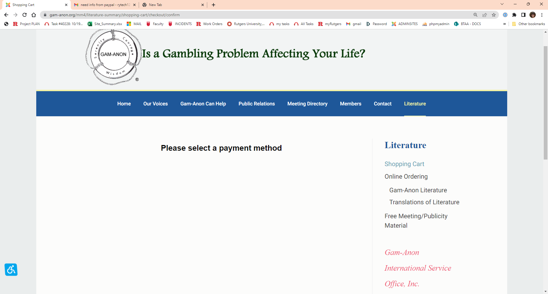

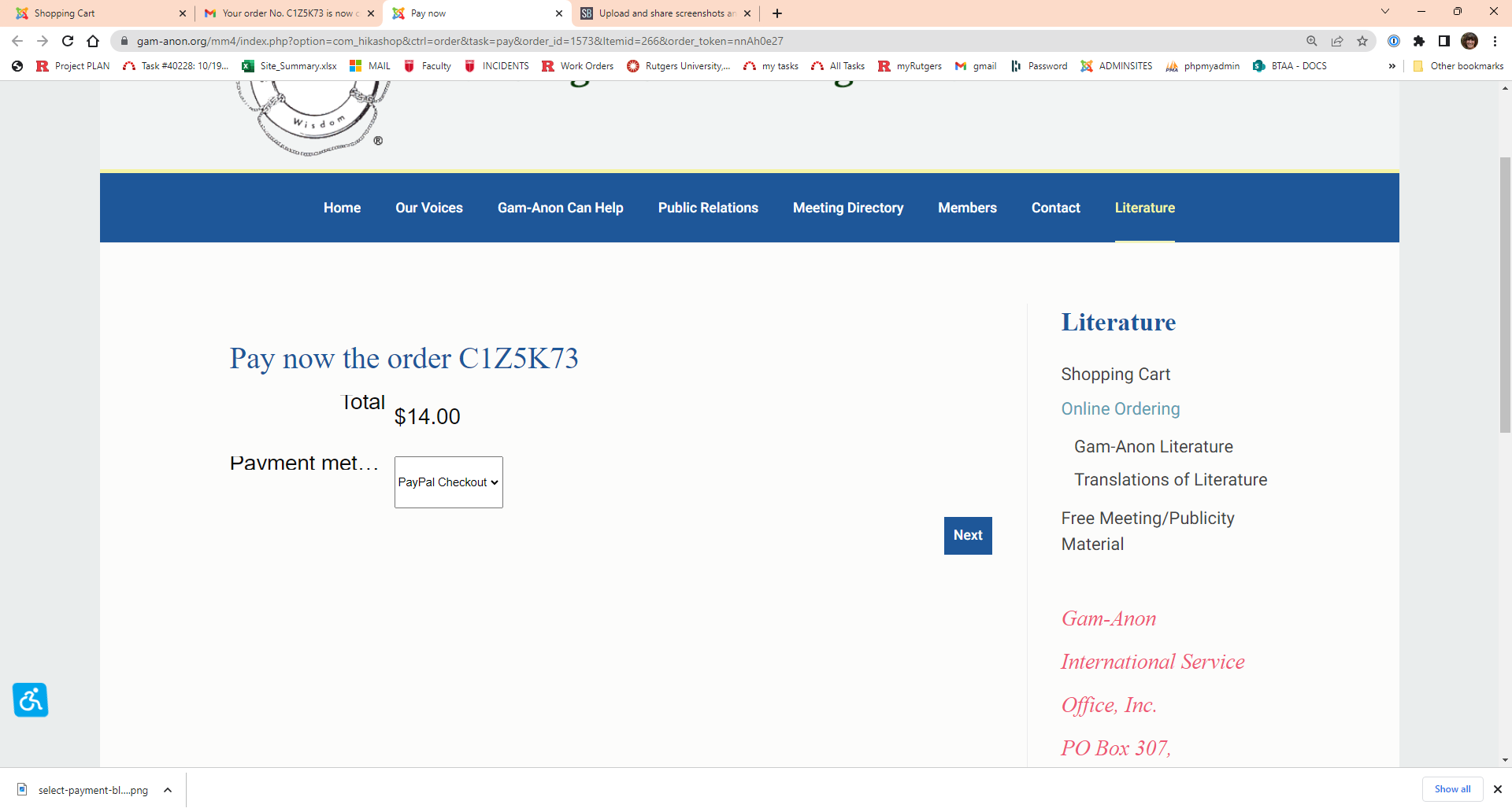

2 years 11 months ago #352819
Ok, i am now using Paypal Checkout.
I put in the all of the keys.
But when I get to the payment page it is blank.
i'm so close!
thank you again for all of your assistance

  • Posts: 85784
2 years 11 months ago #352822
If you open the console of your browser on that page, you can see two errors:
i.imgur.com/jIF5rOq.png
The first one indicates that your browser is not able to download the PayPal JS SDK file. That's the file which displays the payment buttons at the end. The second error is a consequence of the PayPal JS SDK file not being loaded.
If you open the URL of the first error message you get this:
i.imgur.com/G0TzOuo.png
This means that the client ID you entered in your PayPal Checkout payment method is incorrect.
I can see there is a space in the middle of your client ID. I don't think that's normal. Please double check with PayPal that you've entered the correct client ID there.

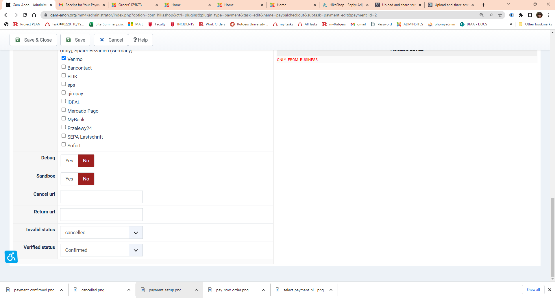

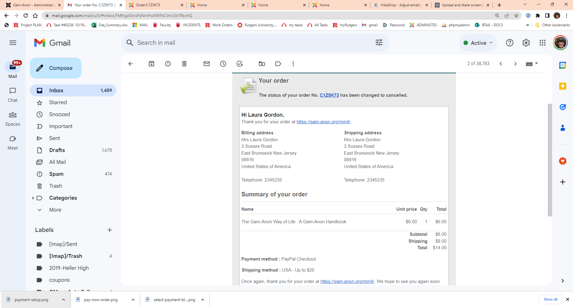

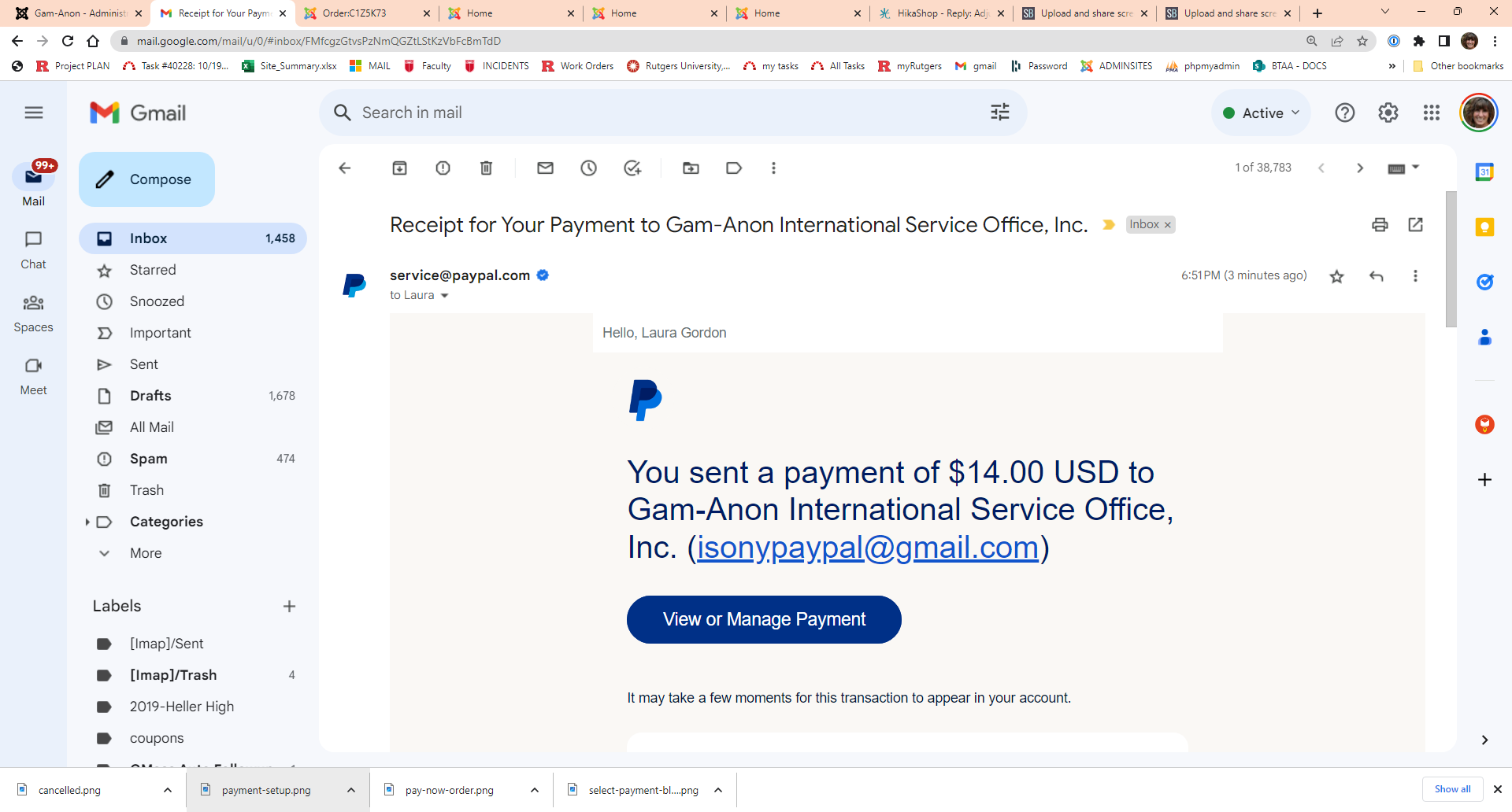

  • Posts: 25
  • Hikashop Essential
2 years 11 months ago #352825
I have something setup wrong still... so close!
I PAID via paypal
I received confirmation from Paypal that it was paid
The email I got from the order is that it is CANCELLED
Please see the settings that I setup (Cancelled is for invalid), and confirmed is if verified.
I can't thank you enough. This all happened via a J4 migration and we thought we were going to stick with virtuemart, then it wouldn't work, so in a few days I have to get hikashop up and running so we can go live with the site. I really appreciate your assistance in getting me over the hump. I have wanted to switch this client to hika years ago, and they fought back... they don't like change, so now I gave them no choice... but I have to deliver.
thanks,
Laura
  • Posts: 85784
2 years 11 months ago #352827
First, I would recommend updating to HikaShop 4.7.4. This new version contains many improvments in the PayPal Checkout plugin so it should work better.
Also, if you still have an issue with it after that, please enable the "debug" setting of the payment method and try again to make a payment.
Then, check the "payment log file" setting of the HikaShop configuration. You'll get debug data of the PayPal Checkout payment plugin which should allow us to tell you what to do.

2 years 11 months ago #352878
thank you again for your patience!!
Yes that removed the error on the display screen --> PERFECT!
Yes, I see the email address, how do I make it REQUIRED?
When I click on the paypal button, I get 2 popups.
- one popup is a blank white screen that says 'blocked'
- when I close that, then I see the popup to login to my paypal account which works!
Payment Flow:
- When I go to the back end the order status = CANCELLED (even if the payment went through)
- It seeems the 'shipping' isn't working, meaning the shipping address isn't being displayed anywhere, but it was before, do I have to adjust the views?
thanks,
Laura
