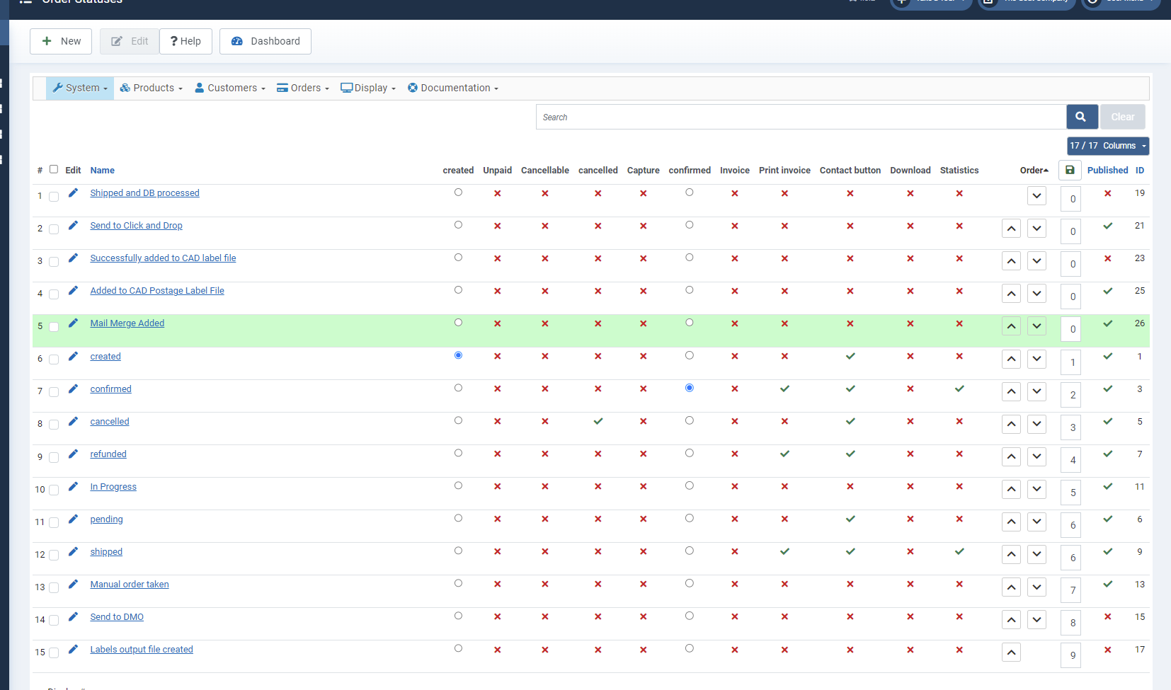

2 years 11 months ago #353339
Here is the requested Order Status screen.
Ian
  • Posts: 85784
  • Thank you received: 14075
2 years 11 months ago #353340
That's the issue. The "created" status needs to be enabled either in the "unpaid" column or in the "cancellable" column (or both).
Since it is disabled in both, the status is not changed to cancelled by HikaShop and it just redirects to the checkout.
Note that by default "created" is enabled under the "unpaid" column.

2 years 11 months ago #353343
Thanks Nicolas,
Not sure how that ever got changed as it wasn't something I ever did anything with? That's why it isn't working in live either, it just stopped one day.
I think the owner of the website was probably fiddling with stuff!!
Thanks again,
Ian
