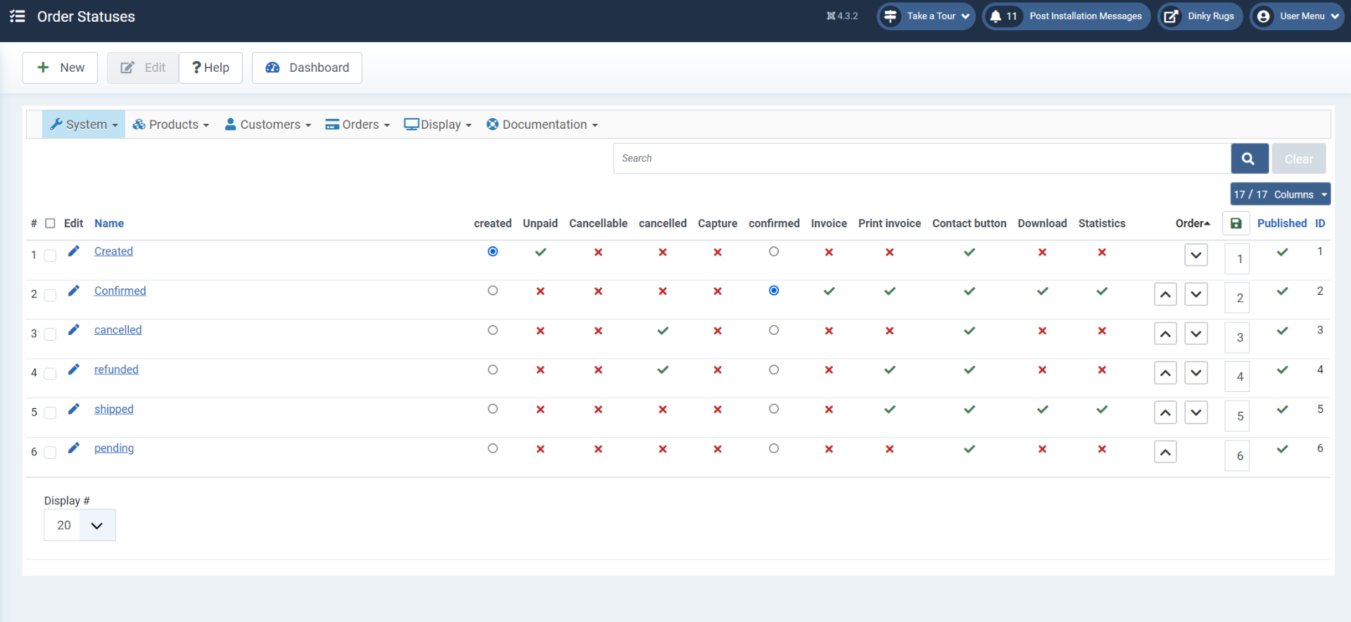

2 years 11 months ago #353271
We will need these elements to better understand your issue your Order Statuses listing screenshot (take good care to show us everything) in System => Order Statuses.
We suspect a bad configuration of your different order statuses.

2 years 11 months ago #353288
HI,
Yes I noticed the invoice being ticked for shipping - I have turned that off. The stock is that to do with cancelled and capture?

2 years 11 months ago #353292
Can you check how the "Update the product stock on confirmed status" setting is configured in the main HikaShop configuration page ?
If the setting is turned off, then the stock will be reduced directly when the order is created.
And with that setting turned on, the stock will be reduced when the order status changes to one of the statuses enabled under the "invoice" column of the System>Order statuses menu.
And I think you want the "shipped" status to be enabled under the "invoice" column so that when an order goes from shipped to refunded, the stock is given back.
Regarding the invoice number changing when the order status is changed, I've never heard of this being a thing. And I don't see how it's possible looking at the code. Could you please double check ? One way I could see it happening would be if there was a mass action configured specifically to do that.

2 years 11 months ago #353298
"And I think you want the "shipped" status to be enabled under the "invoice" column so that when an order goes from shipped to refunded, the stock is given back."
The issue with that it that when that is enabled the invoice number changes when "shipped" is changed on the order status (just on the order browse page) - not on the main order page. Yes I have checked this a good few times.
Update the product stock on confirmed status = ON
Stock issue remains, no stock is being depleted on order confirmed (yes the order is set to confirmed by the payment gateway worldpay) and also refunded state doesn't put stock back.

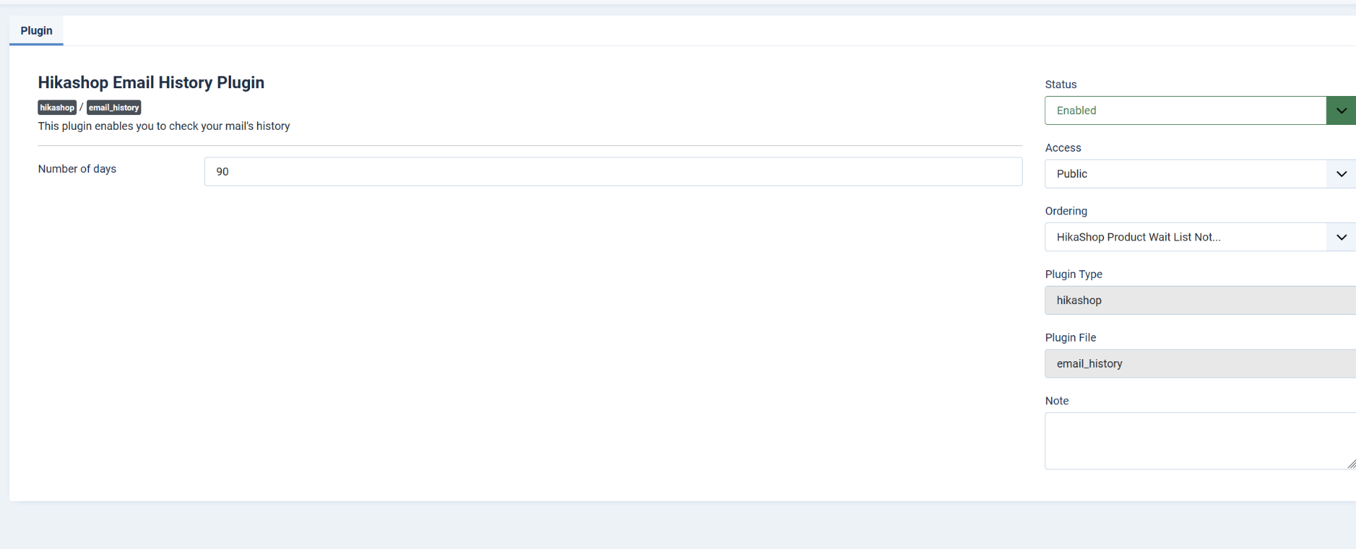

  • Posts: 376
  • Thank you received: 7
2 years 11 months ago #353552
Since the update, we see it with old emails but not new ones.
Attached image of plugin
  • Posts: 85784
  • Thank you received: 14075
2 years 11 months ago #353553
That's strange. I don't see a way this could happen.
Normally, if you click on the "preview" button of an email in System>Emails and get a preview of an email, you should then see it in the email history. If that doesn't happen and the email history plugin is enabled, then you should see an error message in the popup.
Also, it might be that you have some filters or ordering set in the email history listing and you don't see the new emails because of that. Normally, logging out and back in your backend should fix that.

  • Posts: 376
2 years 11 months ago #353607
HI,
Thank you for your suggestions.
I truncated the email_log table - or should I delete it totally? Truncating it didn't work.
There are no filters etc and preview did not show any errors? Plugin is enabled yes.
Many thanks.
  • Posts: 85784
2 years 11 months ago #353608
If you just truncate it, the plugin will still try to add emails to it, but if there is a problem with the structure of the table (for some reason, after the table has been migrated from one website to another), it will still fail, like before.
You can delete it completely. That way, the plugin will add it back automatically with the correct specs and it should then hopefully work.
