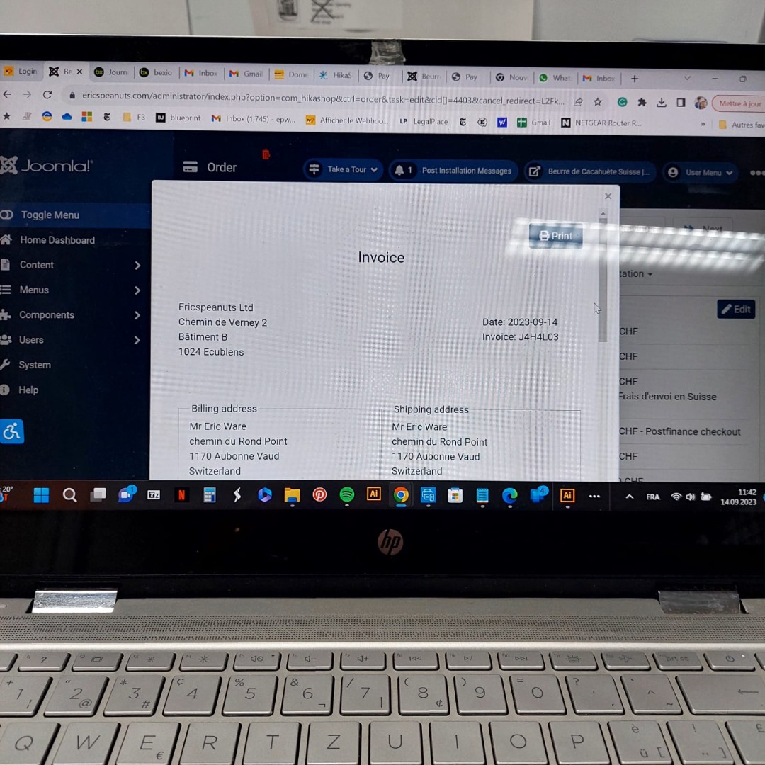

i would like to update the Invoice page. Such as making the font a little larger and adding my logo.
Is there a way to do that?

You want to create an override view of your view order/invoice
1. Learn how to process, here
2. Reach your invoice file view by using the 3 dropdown filter:
Order/Atumn/Back end
3. Open it and edit your html and add inline Css like this scheme :
<p style="font-size: 1.2em; font-weight: bold;">TITRE</p>
Hope this will help you to achieved your needs.
