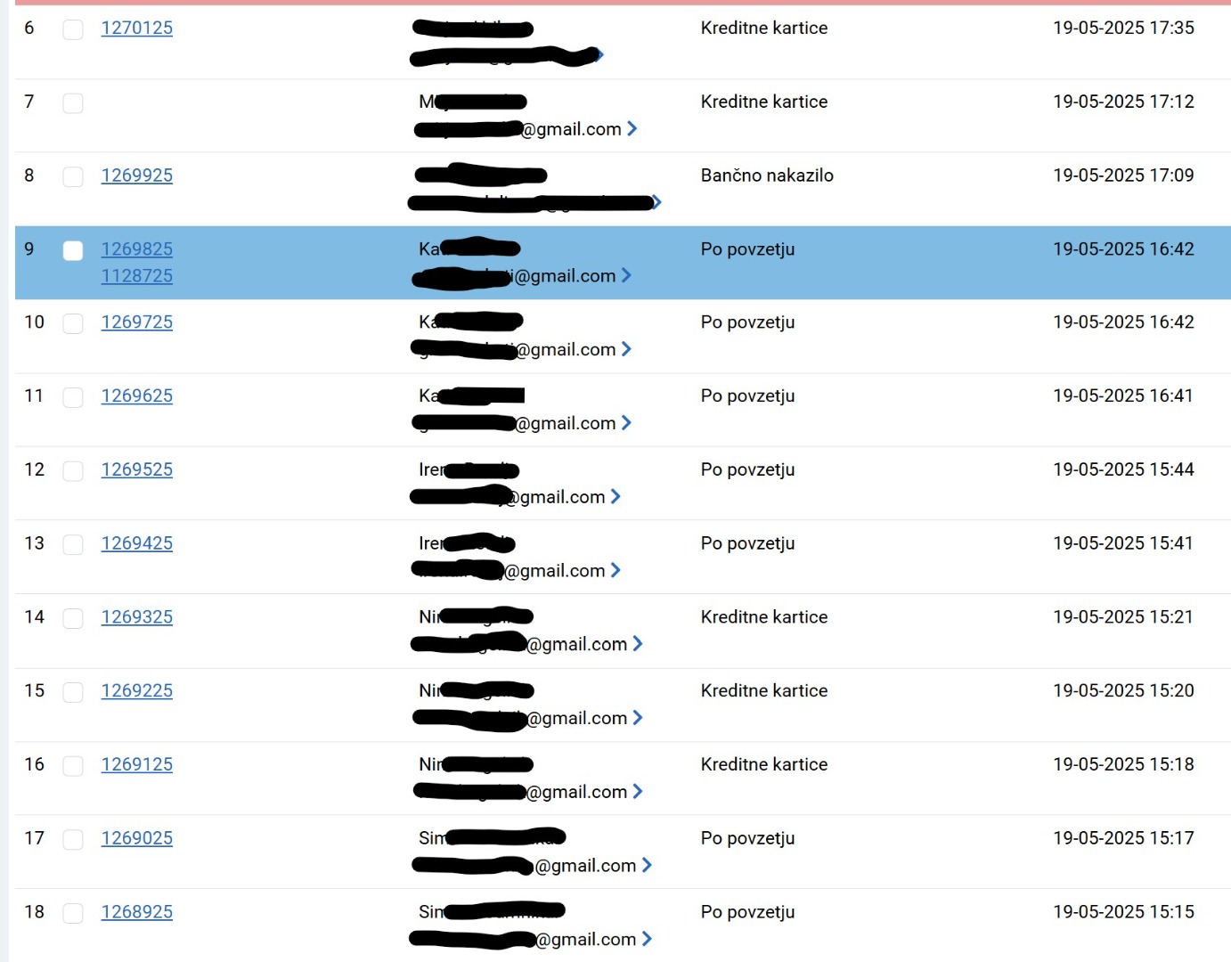

There is something seriously wrong with the orders.
There are duplicate orders and some do not even have an order number.
Credit card payments are not processed in these cases. There are no errors in the payment log for this period.
Only error I have

  • Posts: 429
  • Thank you received: 22
1 year 1 month ago #367182
The database has not changed for years. Primary key is there.
Database check shows no errors and everything is ok.
The order number format has never been changed.

For the duplicated orders, I think it's normal. It's probably the user going back and forth between your checkout and the payment gateway for one reason or another.
That's because each time the user clicks on "finish" at the end of the checkout, the order corresponding to the cart is created.
And if the user goes back to the checkout from the payment gateway (after clicking on the cancel button of the payment gateway), the user will see the checkout again with his cart, he can potentially change things, and then click on "finish" again. So we need to create a new order as things might have changed in the meantime.
For the order without a number, I can only think that the order number has been erased, either via PHPMyAdmin, or via a mass action after it was created with the order number properly set.

For four customers to do the same thing one after the other is a bit unusual or almost impossible.
In the case of credit cards, this would be theoretically possible. In the case of COD (on delivery), however, it is not, since the customer cannot return to the checkout after the purchase is complete.
Only I have access to the database and in this case I would know about the deletion. Massaction is not set up to do this either.

Also, it is not normal for AcyMailing to synchronize all the users between itself and HikaShop each time HikaShop updates an order status. The alias "hika_user1_0" in the MySQL query indicates that this MySQL comes from something in AcyMailing. I would recommend reporting this to the AcyMailing support so that they can look into it.
  • Posts: 429
10 months 2 weeks ago #368070
Order status ready is used for orders that are waiting for the customer to pick up. These are orders that are paid for via credit card or upon pickup. The status is changed manually by the admin.
I sent a request to their support for acymailing.
  • Posts: 85784
  • Thank you received: 14074
10 months 2 weeks ago #368072
Then, it is strange that the order status is being updated like this.
Either, the manual changing of the status to "ready" is triggering the issue for some reason, or there's something else at play.
Did you notice the issue after changing an order to ready ? Do you do that often ?
Or maybe it doesn't happen each time ?
How are you using AcyMailing ? Only to send newsletters once in a while ? Or on a more day to day basis with automatic emails sent every day ? If it's only once in a while, you could try disabling the plugins / add ons between HikaShop and AcyMailing via the Joomla plugins manager and see if that helps the problem not happen anymore. If so, that would indicate that the problem is indeed with the integration between AcyMailing and HikaShop.
  • Posts: 429
10 months 2 weeks ago #368100
The status ready is used maybe a few times a week. The database hangs maybe once a month.
I think the problem with the status is more a result of some other error.
We use Acy on a daily basis. Up to 30,000 emails are sent per day via automation. Most of them are related to customers in one way or another.
Turning off the connection to Acy would represent a huge drop in sales.
  • Posts: 85784
10 months 2 weeks ago #368111
Mmm. Then we don't have more clues to move forward.
What I can recommend is to add the code:
if(!empty($order->order_status) && $order->order_status=='ready')
    hikashop_writeToLog(debug_backtrace(DEBUG_BACKTRACE_IGNORE_ARGS));
before the line:
$order->order_id = parent::save($order);
in the file administrator/components/com_hikashop/classes/order.php
This way, each time the status of an order is updated to "ready" via HikaShop's API, the data of situation will be logged in the "payment log file" of HikaShop (it is available in the "Files" section of the HikaShop configuration).
And next time you have the issue, please provide the payment log file content so that we can check the situation. This should allow us to better understand what is causing the problem, supposing that the MySQL query log provided by the hosting support really corresponds to the issue.
