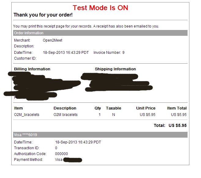

  • Posts: 279
12 years 10 months ago #124220
I made the changes suggest and I am still not being returned to the site. It's just hung up on the Authorize.net receipt page (I'm using SIM). I have a return URL set in the AN plugin, but it's a valid one so will resolve. However the page has no continue or return button on it - no idea what to do.
URL: www.ckdev.info/o2m
AN is in test mode btw.
UPDATE:
I changed the "Allow payment notifications from %s" to YES and it worked (I previously had it as Yes, but it didn't - doh!). I actually want it to auto return to the site - is that a function I need to sort out in the AN backend?
Last edit: 12 years 10 months ago by trogladyte.
  • Posts: 26380
12 years 10 months ago #124398
In SIM mode, I do not see an option in the API in order to specify a "return back" url. So I suppose that it has to be configured in the Authorize.net backend directly, that it is not something dynamic.
