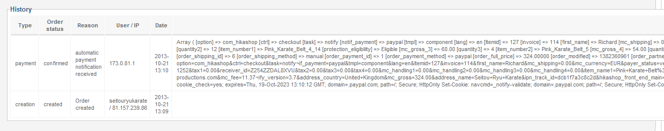

But no detail is displayed in the log of the "created" order, even with Debug mode turned on. I can see the response when I get one from Paypal and there is a lot of detail there. (screen print attached)

In case of communication between HikaShop and the API, the log can be found via Configuration > Main > Files > Payment log file > See the report, else as you have on your screenshot, in the order details.
