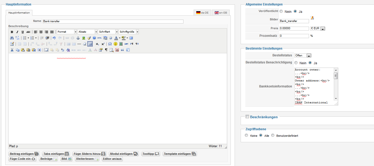

i have only the banktransfer method published. It is configured with the bank account data.
In the shop frontend, is these method not shown! What could have an influence of showing the payment methods?

Please provide a screenshot of the options of your payment method so that we can check it if you can't find the issue yourself.
  • Posts: 29
12 years 9 months ago #129911
2 Screenshots attached
Last edit: 12 years 9 months ago by mkaker.

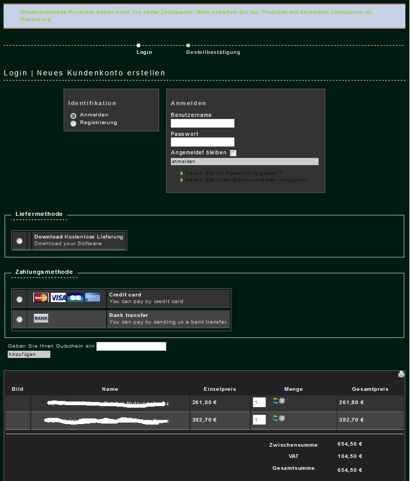

Now it is more confusing for me

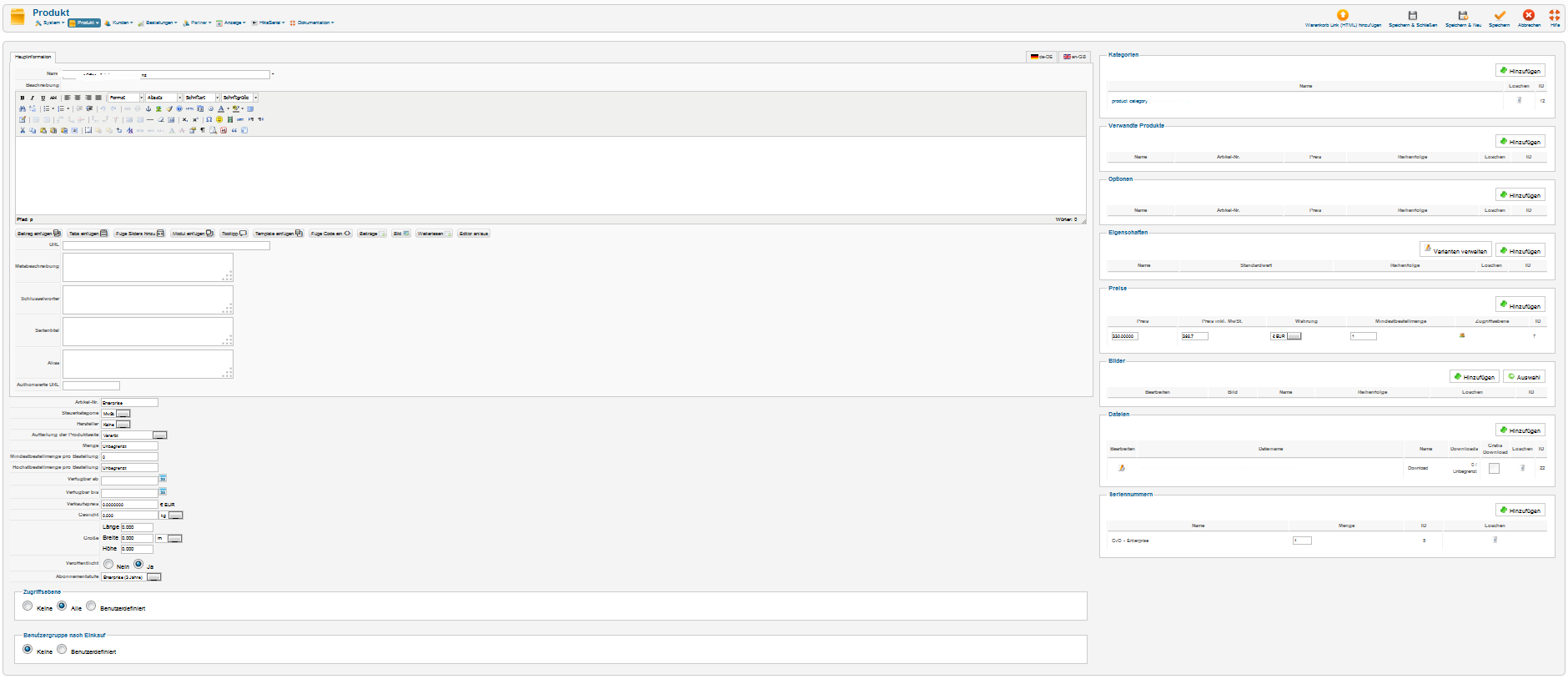

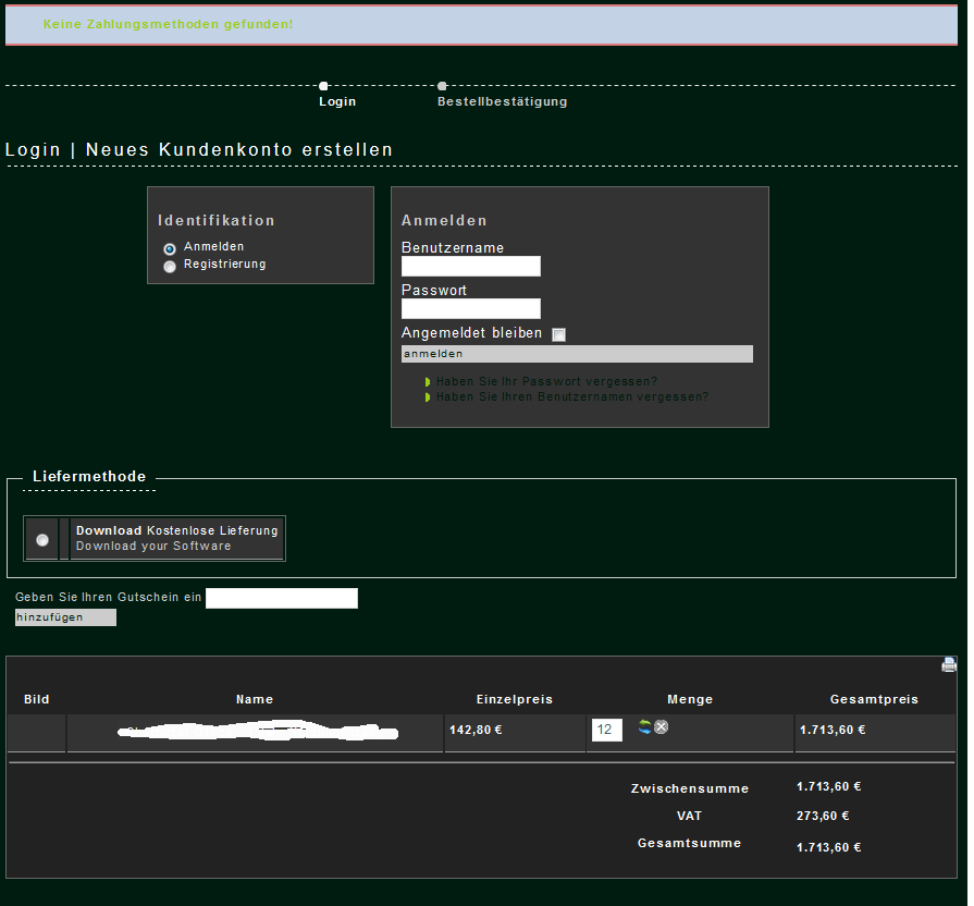

- when i add only one product (witch is an software subscription packet) to the cart, the No Payment Method messages occurres (Screen 1)

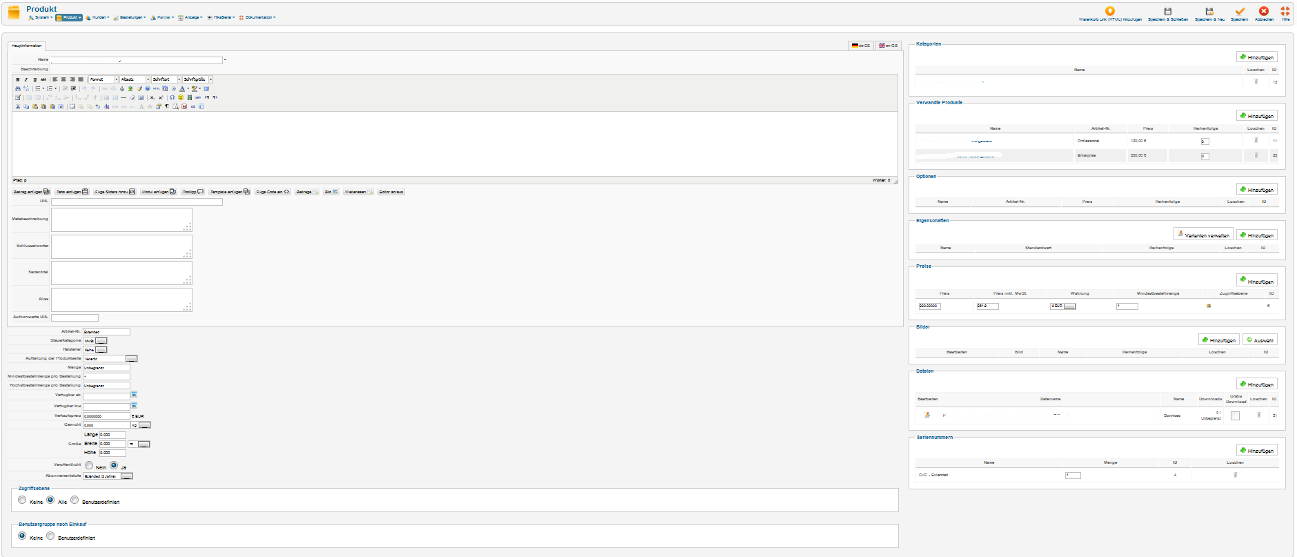

- when i add two different products (two different subscription packets) to the cart, the configured payment methods are shown like i expect it (screen 2)
both subscriptions are akeeba subscriptions ...
how can i fix it?
Last edit: 12 years 8 months ago by mkaker.

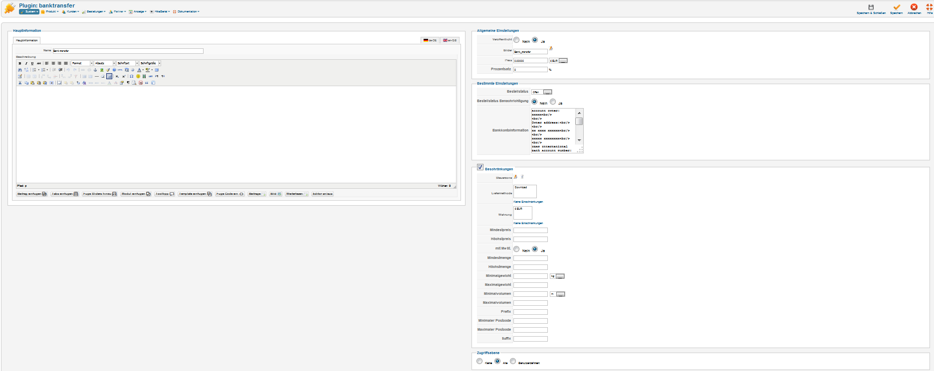

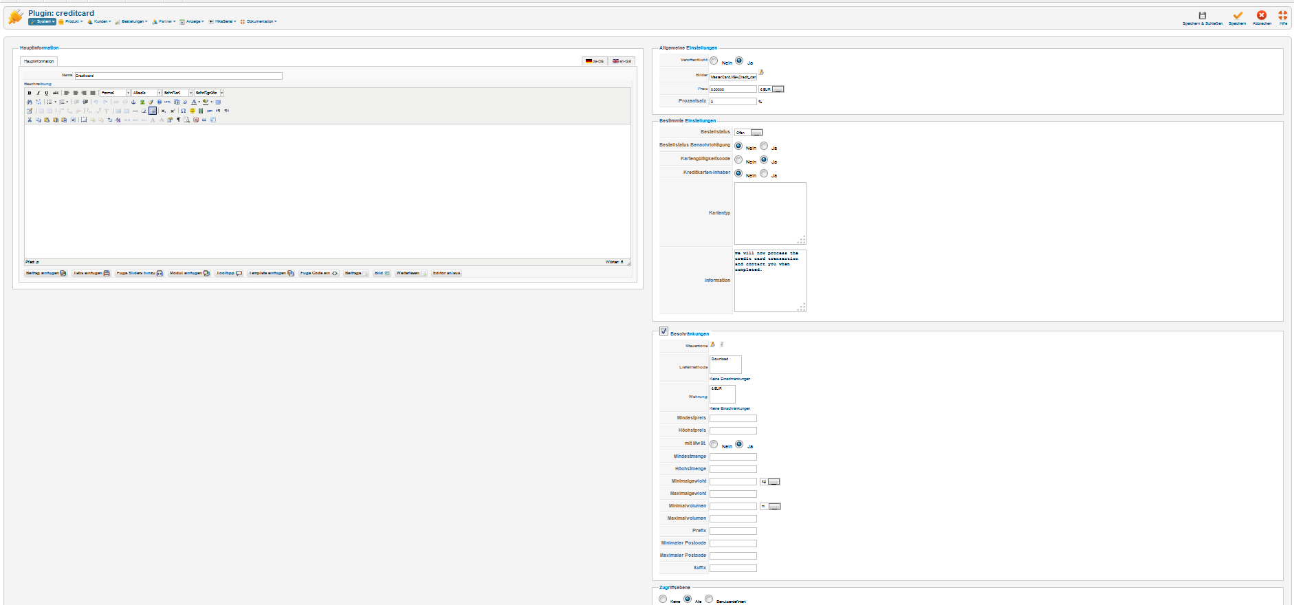

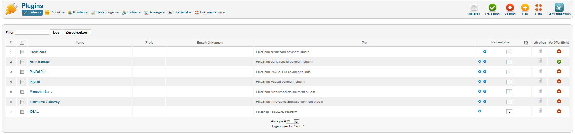

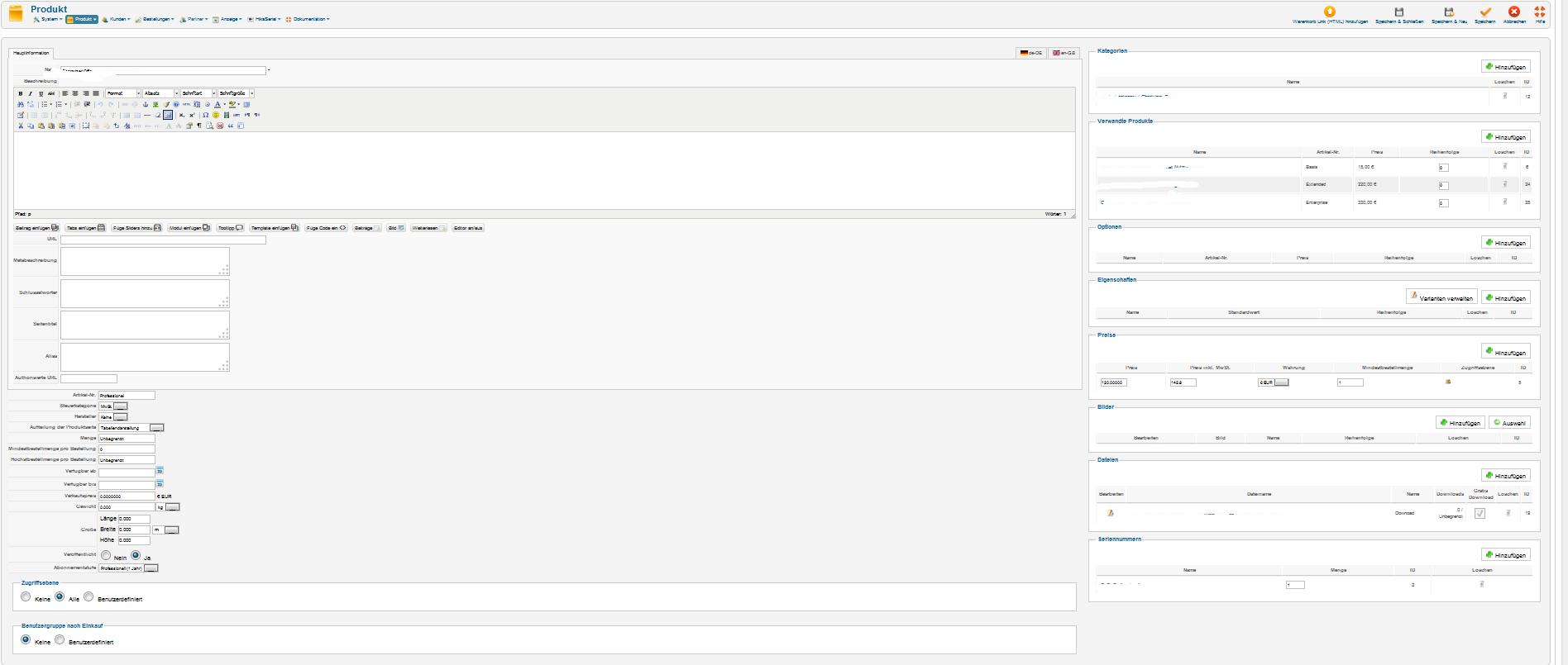

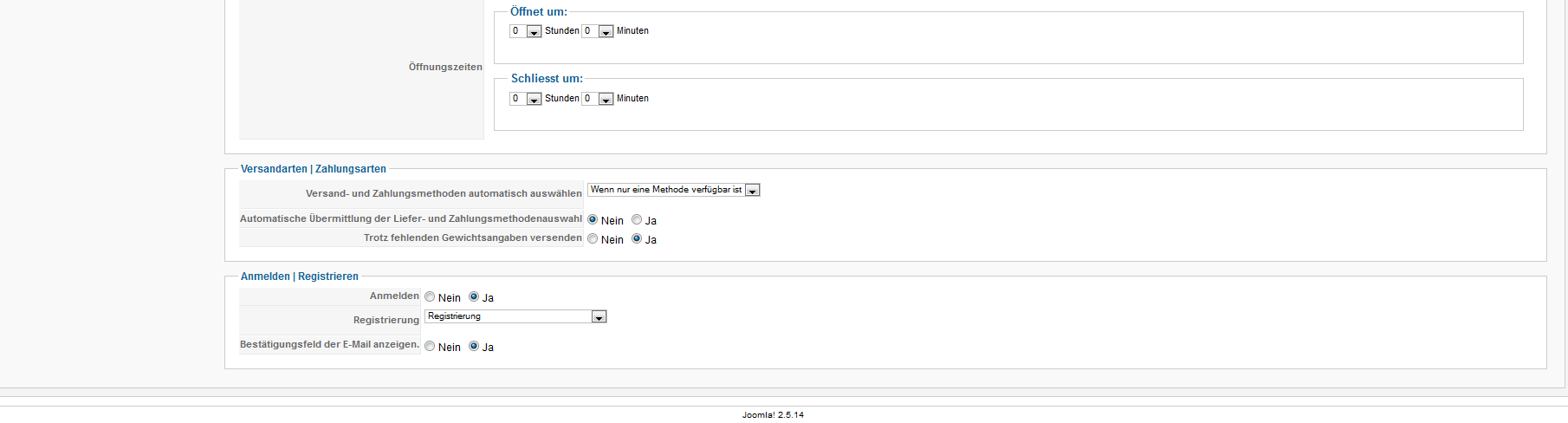

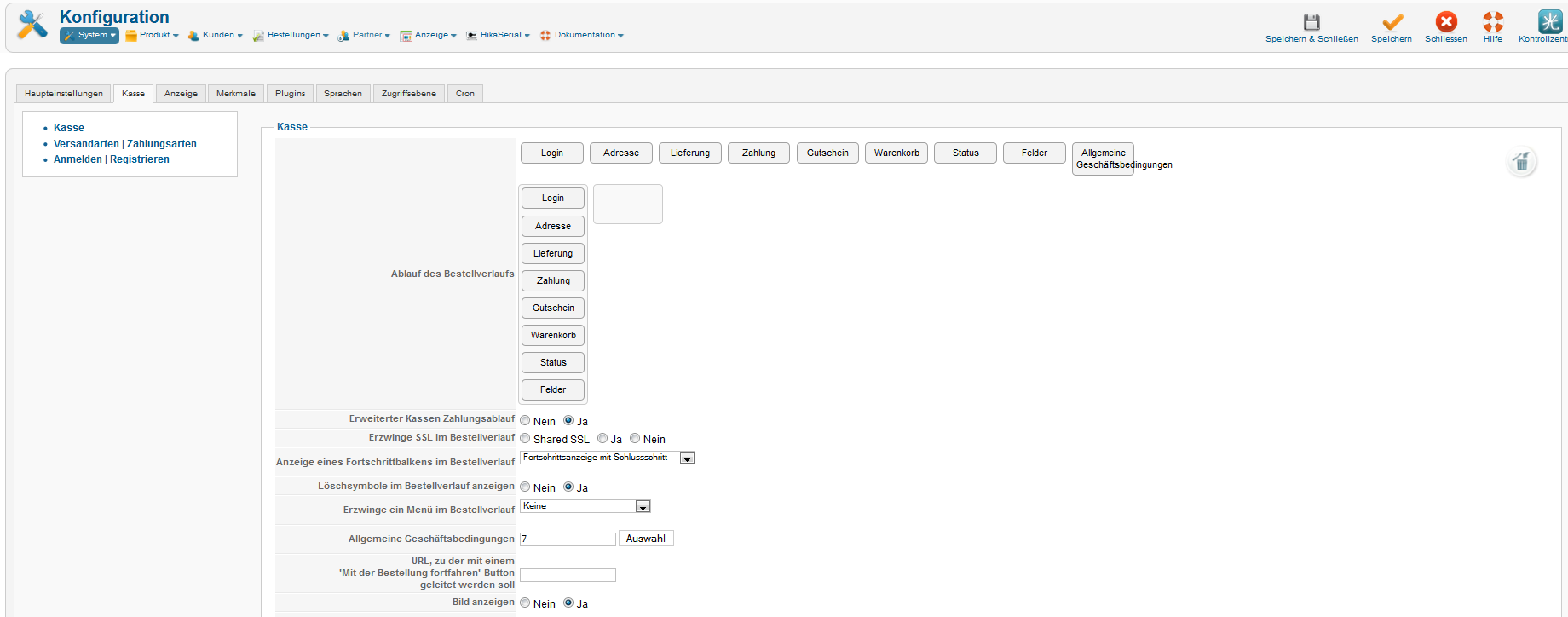

So can you show me how did you configured :
- Your two payment methods restrictions
- Your 2 products
- Your checkout workflow ("Hikashop->System->Configuration->Checkout")
through some screenshots
  • Posts: 29
12 years 8 months ago #132237
Please see the screenshots
