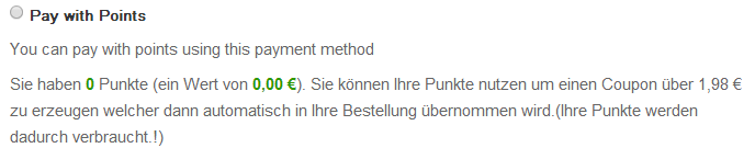

I set the statuses to: "confirmed, shipped" but it is still allowing to use the points that are not yet earned. See picture
(It's the german translation, but you see that the user has 0 points and the system offers to convert the (not yet earned points to a coupon))

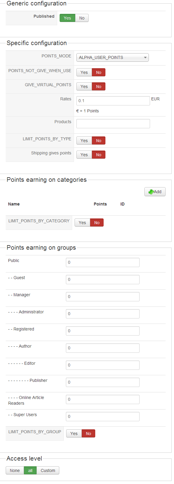

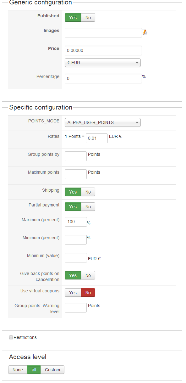

Here are the settings of the Userpoint plugin [1/2]:
Here are the settings of the Userpoint plugin (Payment) [2/2]:

  • Posts: 26378
12 years 8 months ago #133682
I do not understand you and your screenshots.
If the user don't have points, it is sure that he won't be able to use it to pay.
We are not interesting by your userpoints payment configuration, but by your userpoints hikashop plugin configuration ; the one in the plugin section.
demo.hikashop.com/administrator/index.ph...=plugin&subtask=edit
Do you have AlphaUserPoints ? What is the point status of your user ?
Are you sure that the order will give points to the user ?
Does the order been create after your userpoints configuration ?
Is your "status" configuration right (the previous post) ?

  • Posts: 40
12 years 8 months ago #133686
I really don't understand why you can't understand me and my screenshots.
It's all clearly laid out!
And I am proving below, the one screenshot in my previous post is the plugin configuration that you're asking for.
I attached the other screenshot just in case it would help you in some way.
The first screenshot in the previous post is from the checkout process and it is only there to prove to you, that even if the user has ZERO points, he gets the option to turn the points he would earn from this purchase, to a coupon.
The text is from your German translations.
You can see clearly that it says that the user has 0 points which corresponds to 0,00 €.
And then it says that the user can turn his points (WHICH HE HAS ACTUALLY NOT YET EARNED!!!) into a discount of 1,98€ !
Don't need to know German for that, in that context.
BTW the total in the cart was 19,80EUR and the user would earn 198 points. Those 198 points should not be there yet, in order to produce a discount coupon. They should be earned after confirmation or shipment.
2. The second screenshot IS from the userpoints hikashop plugin plugin configuration!! It's the right bar, and there you see all the configuration!!
Of course I have AlphaUserPoints... And I have done several tests. The last one having reset the user to ZERO points. Directly after that I went to make a test order. And result of this is the first screenshot showing that in the payment options page having ZERO point I can already use the points that I HAVE NOT YET EARNED!
Yes, It will give points --> It's already giving the points before actually reaching status "confirmed" or "shipped" . That's the issue here!
Yes.
The content of the status field is exactly this(copied and pasted): confirmed, shipped
Last edit: 12 years 8 months ago by thesilentman.
