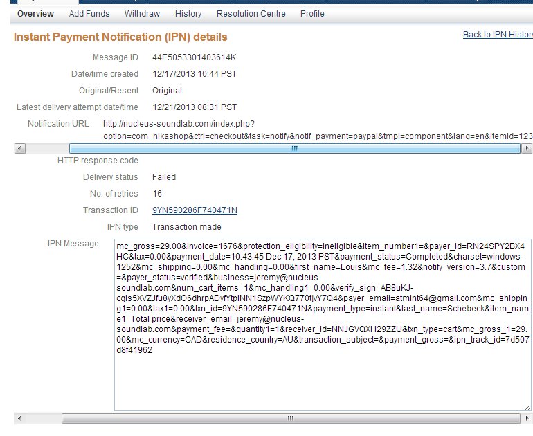

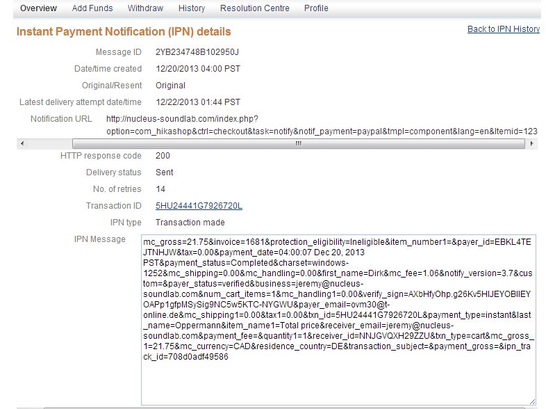

I just discovered the Paypal IPN History page. Not sure if this info would prove helpful in troubleshooting my problem?
My IPN history says the transaction retries 16 times and then fails. Well, actually some retry a random number of times and then are considered 'sent' although the order never successfully confirms in Hikashop. But most are failed with 16 retries. I've taken a screengrab of both the failed IPN and an IPN with 14 retries and attached them.
