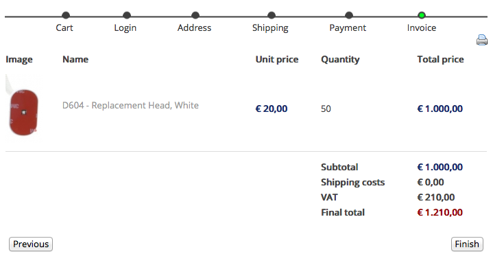

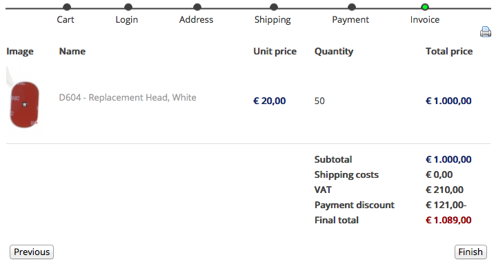

That's not really what I mean. With each payment option I can add an amount or percentage for costs. I can also make it a discount by putting negative numbers there. That last option (discount) is what I want to talk about. When I give discount at certain payment methods, I give discount to the total sum of money people do have to pay for the products. Let's say I really want people to use iDEAL (a Dutch payment method) I could give 10% discount.
So when they order for € 1000,00 products there will be € 210,00 VAT added (I live in the Netherlands, our VAT is 21%). So they have to pay € 1210,00. Now they get to the payment method in the checkout process. They choose iDEAL. I give them 10% discount.
What should happen?
They pay € 900,00 for the products and get € 189,00 VAT added. Total € 1089,00 (€ 121,00 / 10% less)
What happens at Hikashop?
The discount is processed and the amount to pay will be € 1089,00. The VAT was € 210,00 and will stay € 210,00.
Conclusion: they will pay € 879,00 for the products and € 210,00 VAT. So they are paying 23,8% VAT, which is INCORRECT.
See the screenshots to prove it. I hope you understand my problem and that it's a real problem.

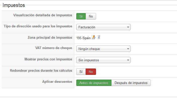

12 years 5 months ago #143935
Hi miracle. there is an option in configuration/tax -> Aply discounts -> before tax / after tax
  • Posts: 91
12 years 5 months ago #143940
@Cesarlab69: thanks for joining in and think about the solution. I really hoped your suggestion was the right one and I just had missed on of the many knobs I can turn on and off. But unfortunately it had no effect. It was already set at 'before taxes', changing it had no effect. I think because it has to do with discounts and the payment fee/discount is not seen as a real discount. I think it should, because I still have a VAT problem I can't explain to the tax administrator...
  • Posts: 86028
  • Thank you received: 14173
12 years 5 months ago #143965
@cesarlab69: that option is for discounts and taxes, not for payment fees and taxes since payment fees cannot be taxes in HikaShop.
@miracle: as I said, payment fees cannot be taxed, even if their value is negative. The calculation is correct if you take that into account since the VAT is calculated before the payment fee is applied, not after. Again, there is no option to do what you want with payment methods fees.
