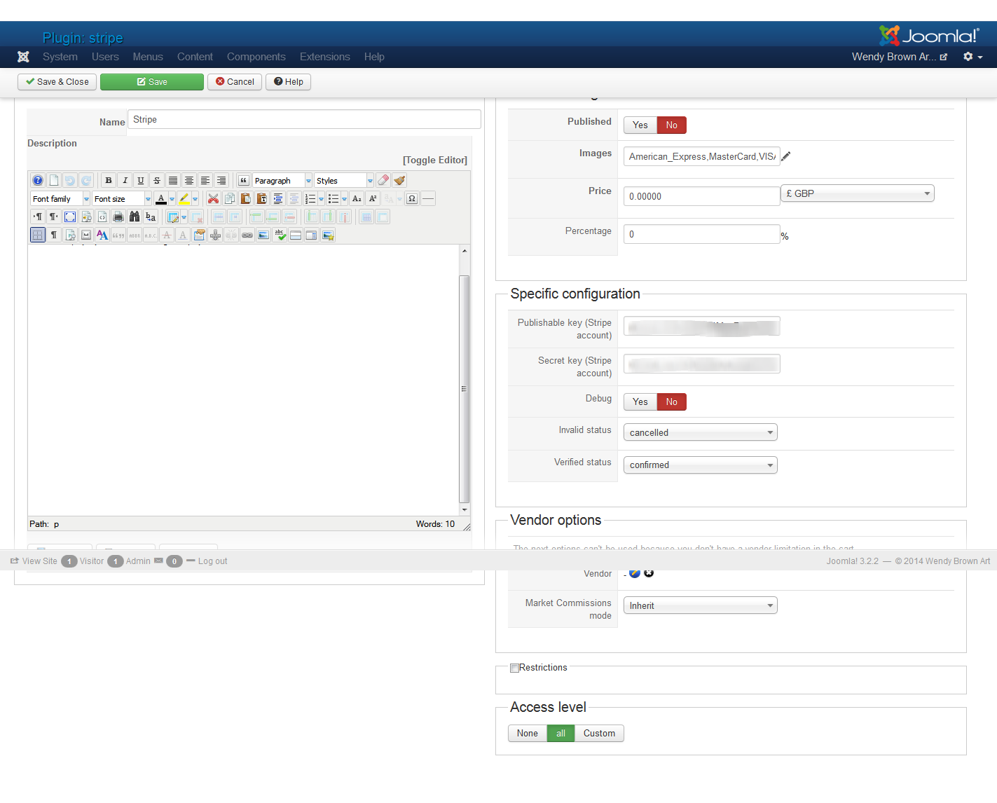

Can you show me through some screenshots how did you configured your Stripe payment method configuration page ?
Last edit: 12 years 2 months ago by Mohamed Thelji.
  • Posts: 306
  • Thank you received: 42
  • Hikamarket Multivendor Hikaserial Standard Hikashop Business
12 years 2 months ago #145541
Hi Mohamed
Here is a screenshot:
(I have disabled the plugin at the moment as the site is live.)
